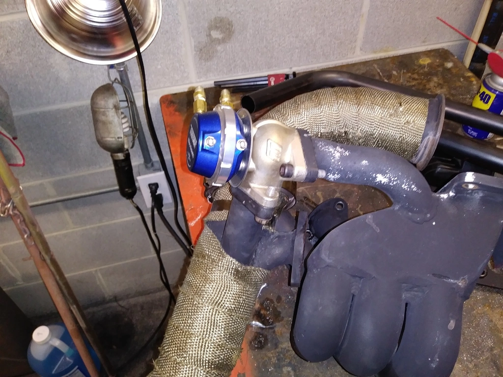

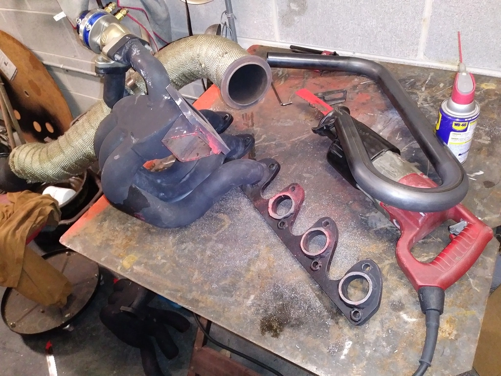

right before the wife tags me to go over to her friends house,...I get out Medusa.
I bolt the turbo on, and attach the down pipe to the turbo flange. I bolt a waste gate onto the rear most part of Medusa, and attach the other end to the down pipe. The waste gate will now hold the down pipe in place now, in the orientation that will work with everything else as it's built in the exhaust system.
I get out the sawzall, and proceed to cut away the front 3 tubes from the turbo flange, and the head flange.
Medusa is now a thing of the past...
So here's the plan: Tomorrow I'm fabbing up the front 3 tubes, and getting them attached to that down pipe flange. Once I get the front half built, I'll cut away the rear, and do those three tubes..I've got to pay close attention to the pictures I have of the engine so that I can determine how far I can extend the tubes forward before I turn them 180* back into what will be the collector that I'll mount to the downpipe flange.
