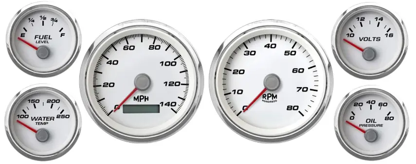

I looked at new gauges this morning....I hate the thought of spending this much money to replace them with something else,...especially when that means I have to change out so much of what is Original Monster to do it. I aint spending stupid money on a new gauge set. The speedo has to be electronic, and that is the primary choke point in choosing something. The Black 3-3/8" units from VDO cost 180.00, and that's the cheap one. There were speedos from Autometer and a couple of other venders that were 300-400.00...for just the freaking speedo. I do not want to spend 1200.00 like I did on the red car.

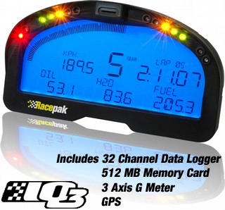

Might fit in your current gauge pod area-with minimal modification
Mike I think you should consider doing the LCD dash display.... it's cheap and effective
You could do that computer screen thing all of us mspnp guys want to do. Seems inexpensive and you wouldn't have to hook a laptop to it. Could tune through the cluster.
Plus, at start up, you could have a rotating picture of a gila monster attacking its prey.

I do think everything you’re doing is mega cool, and I’m all about the future capabilities of that system, I just cannot blend a rectangular display into any part of my curved dash, and it would have to sit more or less right where the existing housing is to be able to cover the holes already cut there for the wires.
Besides....I’ve already solved my problem....see below.
Believe me when I tell you I know how happy you are about it. The gauges have always been a thorn in your side. It’s gonna be a challenge trying to incorporate the analog gauges into the existing gauge pod, and putting the tach and speedo on top piggyback style will add a significant obstruction to my line of sight. But I’m up to it.I was going to say, your purchase history should have helped. That was single handedly why I moved from American Muscle to LMR. I had spent thousands there, done many hassle free returns, etc, but when I asked to return the catalytic convertors that I never used on my 2011, they refused due to being more than 6 months after the purchase date. Like you, I bought them with a plan, and didnt get around to actually using them. Now they are on my current car, and LMR gets my business. I dont deal with retailers that wont give a little here or there.

You should know how happy it makes me that you are switching gauges. You should have trashed those damned things when you took them out of the red car.
