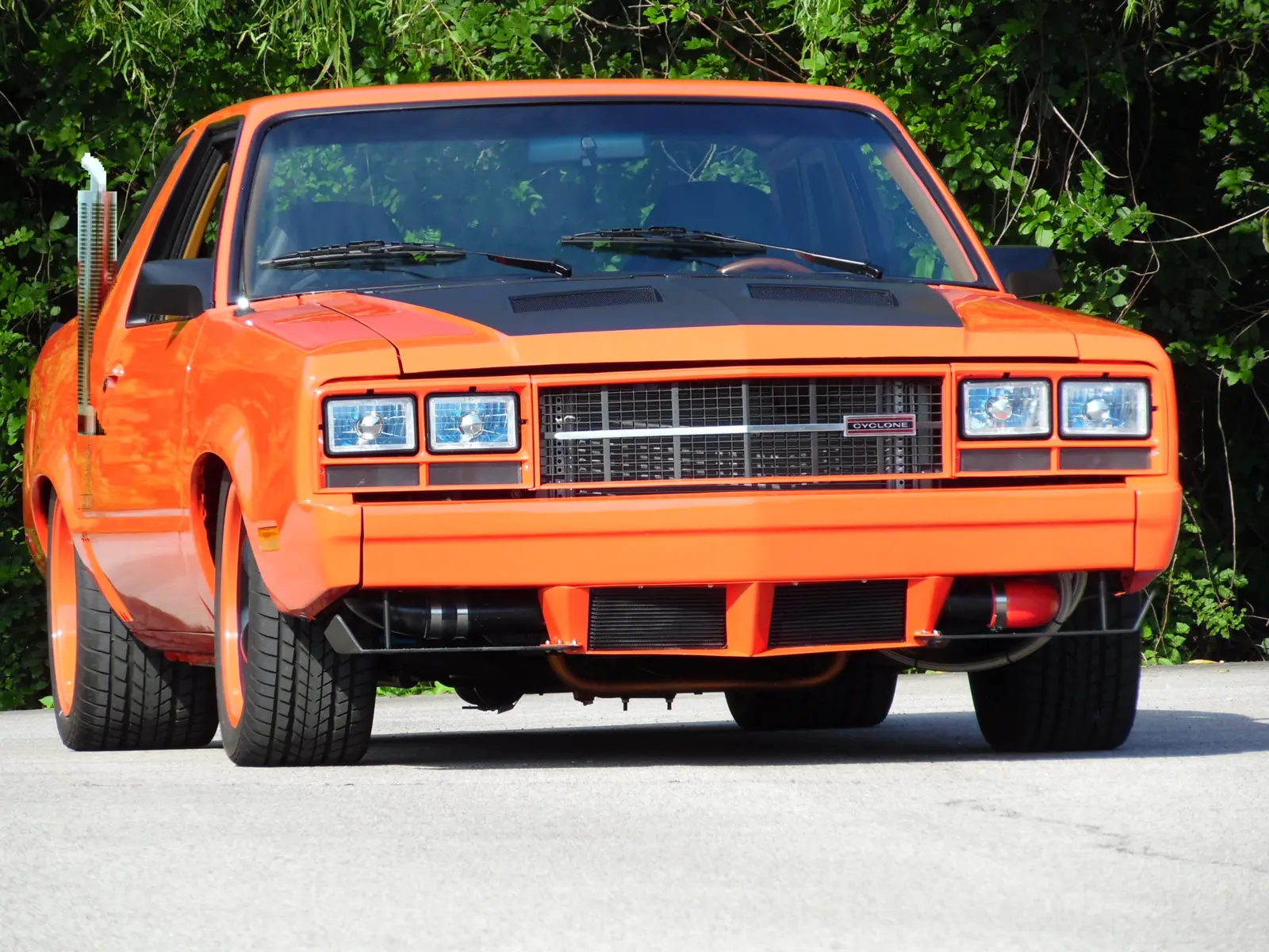

I just wanted to see what it would look like.
Reactions: darkfader, droopie85gt and Davedacarpainter
CarMichael Angelo
10,641
8,909
Birmingham, al
Aug 4, 2018
#8,328
  • Aug 4, 2018
  • #8,328
You're seriously making me reconsider my exhaust routing now Noobz......Hmmmmm...maybe I shoulda got a 18 wheeler style stack, and stuck it straight out of the passenger quarter...
But on a side note......Damn! That sure is a good looking car!

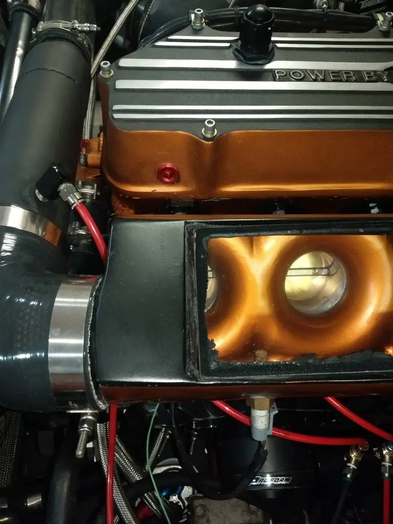

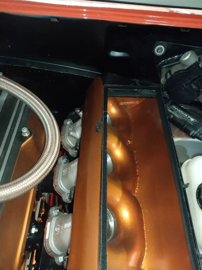

Well.......
That was funny.
No sooner do Steve and I get linked up, the Monster all hot and bothered, and set out for our remote session to get him all happy, and tuned in boosty town...do I hear a pssh noise like escaping air.
I tell Steve that I hear a noise something like the blowoff valve makes, only it happened while my foot was on the gas, instead of off...
I go through a series of slow tip in's of the throttle, and I can hear the turbo spool, but he can't see the engine go into positive pressure, I can't feel it, and there is no tell tale blow off valve noise when I lift.
The car is running beautifully, but it ain't making no boost.
Whatdya spose could be the problem??
I tell Steve that I'm gonna look and see if a hose has blown off....so I pull over and pop the hood..the hoses are all on, and the lines are secure.
It's the glass that ain't feeling so well...
The windshield ribbon didn't survive one single exposure to positive pressure. Not only did it spooge out in several places, but it literally lifted the glass completely off the base...effectively ending my tuning session with Mr. Steve today.
While the thing was hot, and loose, I took advantage of the situation though....
I'm gonna use the right stuff as a sealant. And let that junk dry . As hard as it was to get the old intake and valve cover off this last time...I'm confident it'll hold the glass.

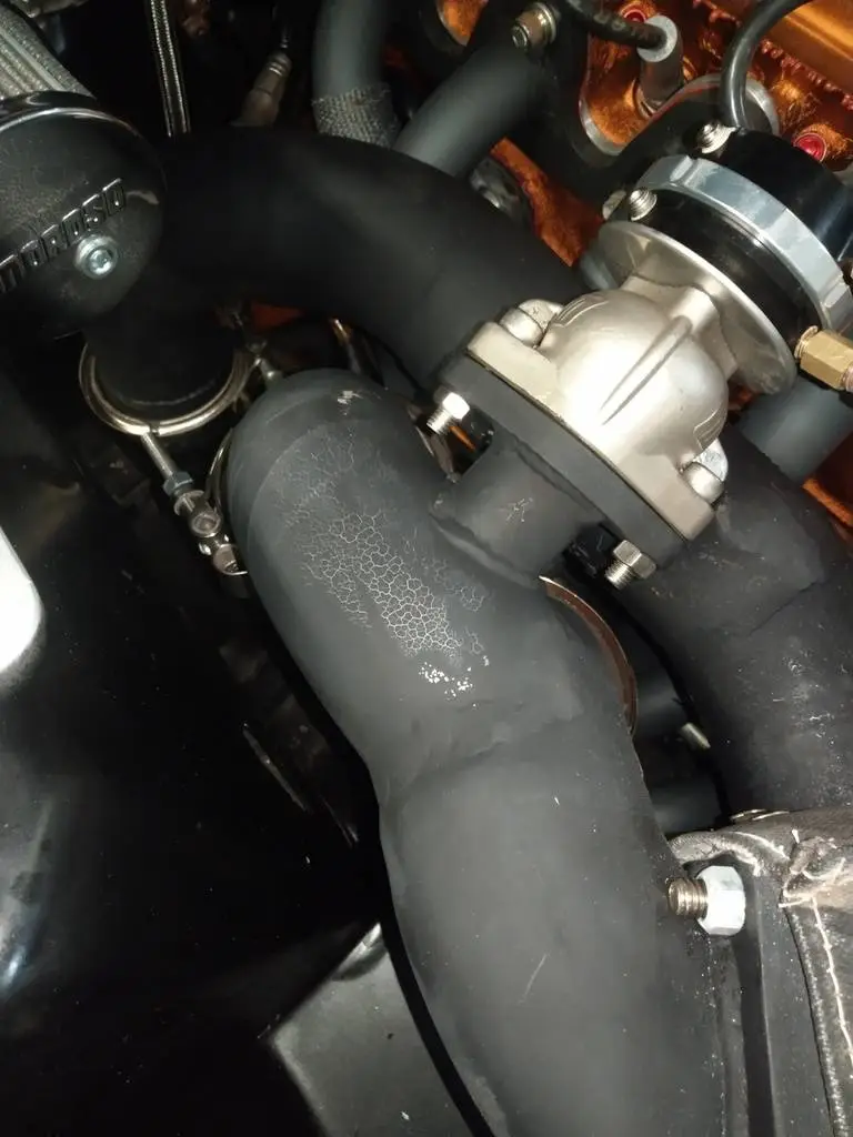

Oh,....and there's this...
2000 degrees my ass...it didn't even make it through one measly road trip....
Junk.

I wasn't sure about the butyl tape, but what do I freaking know. Now I (and you) know it's not suitable for forced induction applications.
If you'd like to stick with the windshield glue theme, the urethanes that are used for windows now would probably hold a ton of pressure.

I don't know if glue alone will get it done. 15 pounds per square inch of pressure equates to a lot of weight over the surface of the glass.
Did you not use the same coating on the old setup?
Joe
I agree. I went and bought the right stuff
and applied it. By the time I tried to "bed" the glass, I think it had already started to skin over. And I'm afraid that all of the time spent wiping the old windshield ribbon off the mating surface is just wasted....and I'm gonna end up doing this again the very next time the engine sees boost.
And That is gonna piss me off.
I think I'm gonna end up using a urethane, which will permanently seal that glass in that box..( and take days to cure)
Or....get rid of the glass altogether, and weld a piece of steel in place of it.
