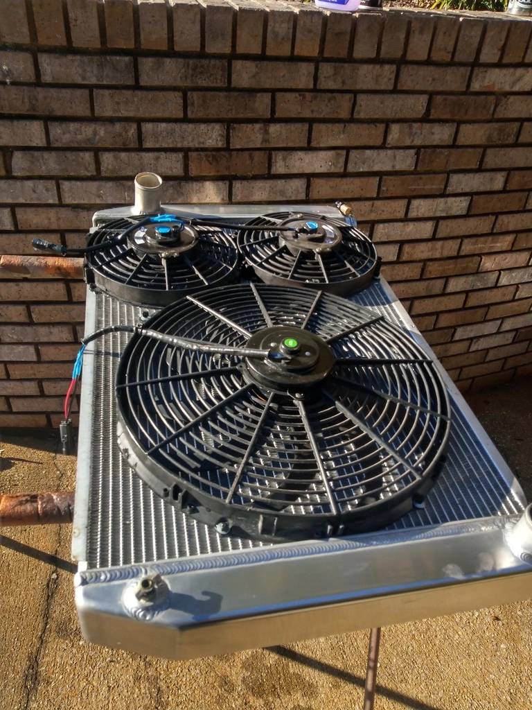

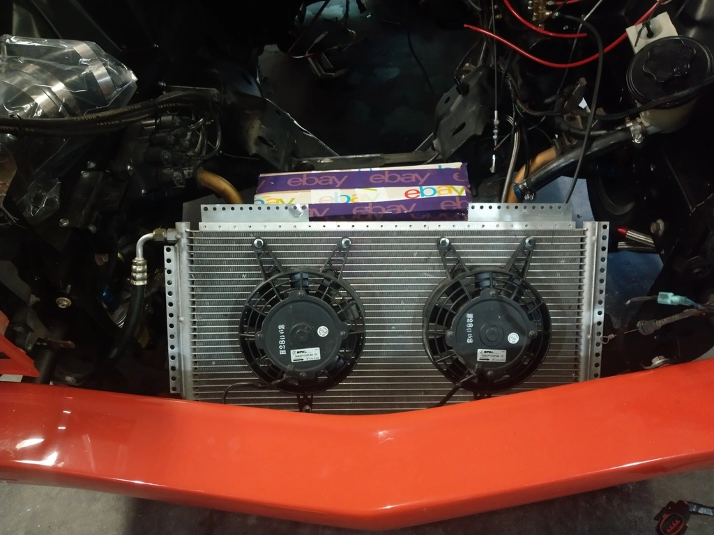

The fans are "direct mount" and leave no air gap for a shroud to duct air to them. If They weren't attached directly to the face of the radiator, then a shroud would make a difference. If I had room to incorporate a shroud...(even a 1/2" stand off) I'd mount the one big one to it and be done.Mike, I still think you will need shrouds of some sort.
The fans taper from the center.....Probably 2-2.5" at the center tapering down to about 1.25-1.375. The nose of the crank barely touches the big fan at its outer reaches....There simply is no room.How deep is the deepest fan on the engine side and what's the dimensions of the radiator. The main one in the engine bay...not the heater cores in or that used to be in the trunk?
