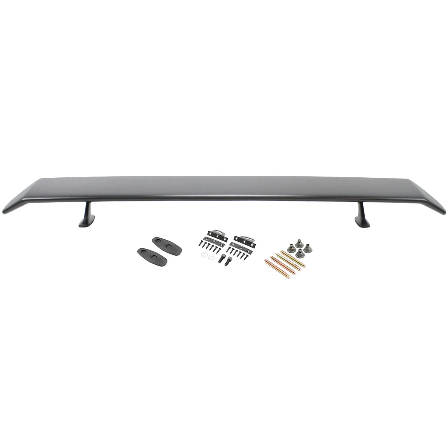

When you do a simple google search of rear wing spoiler, this thing comes up:
This is for a B body Chrysler product...( think 70'sDuster, Demon) it's 58" long, 8" wide, and stands about 4.25" high
When you add the words " 69 Mustang" to the search, this thing pops up instead:
It's nearly identical in spec to the Chrysler piece albeit a little shorter, and a couple of inches narrower.
Naturaly, I ordered the Ford version.

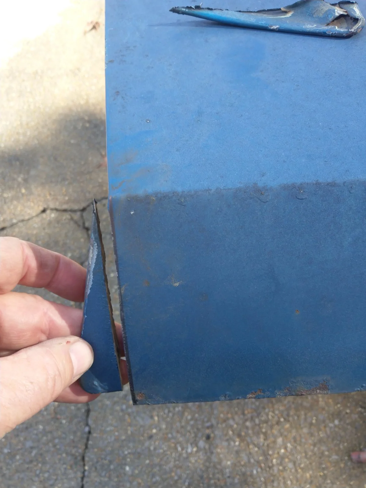

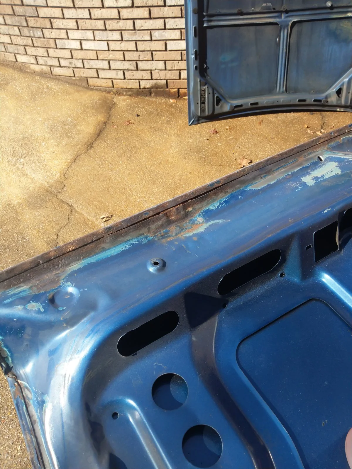

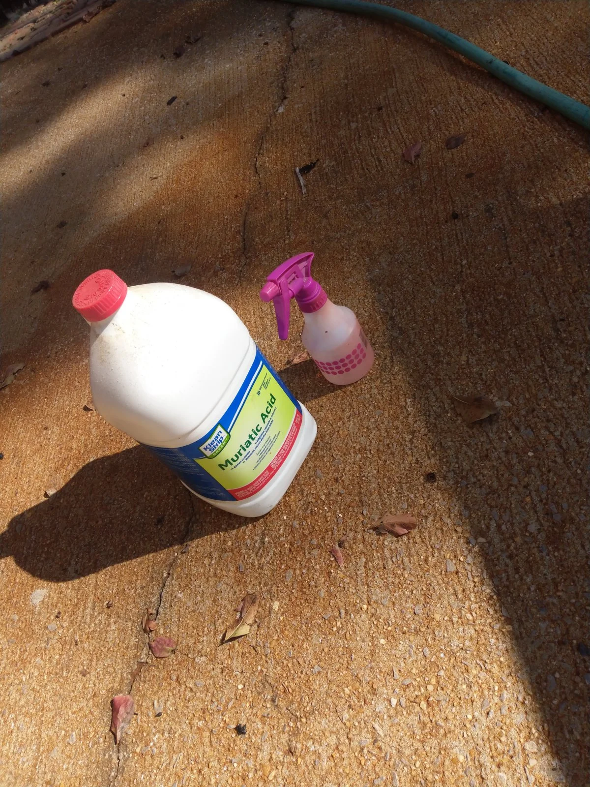

because it's alabama, and because alabama is a great state ( ignoring the fact that 65% of the population voted for a monkey for president) the weather was equally great today.
I wanted to get a head start on tomorrow, so spent a few hours cleaning, and assessing the damage to the new hood and trunk.
The hood has a pretty good crease on the front, and a really terrible repair at the prop rod location.( they are prone to failing because of a weakness there).
The trunk has rust issues..not bad, but bad enough.
Additionally, the trunk has to be cut, and welded to make it fit the Monster.
Ill add more to make sense if the pics after I get home.

May I ask what the process is using the muriatic acid? Is it to kill the rust? Eat out the old seam sealer? Both? Neither?
Davedacarpainter
SN Certified Technician
Nov 28, 2015
11,833
11,633
203
Discordia
Nov 18, 2018
#8,916
  • Nov 18, 2018
  • #8,916
Completely removes the rust

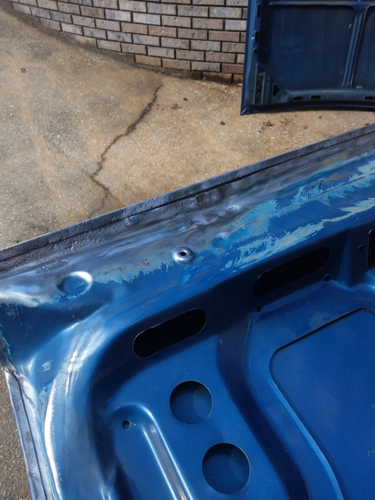

What he said.
I would have to cut away the inner structure to be able to get at the backside of the trunk skin that is trapped. I was hoping that muriatic acid would eat the rust and show me some bare metal. ( obviously it did)

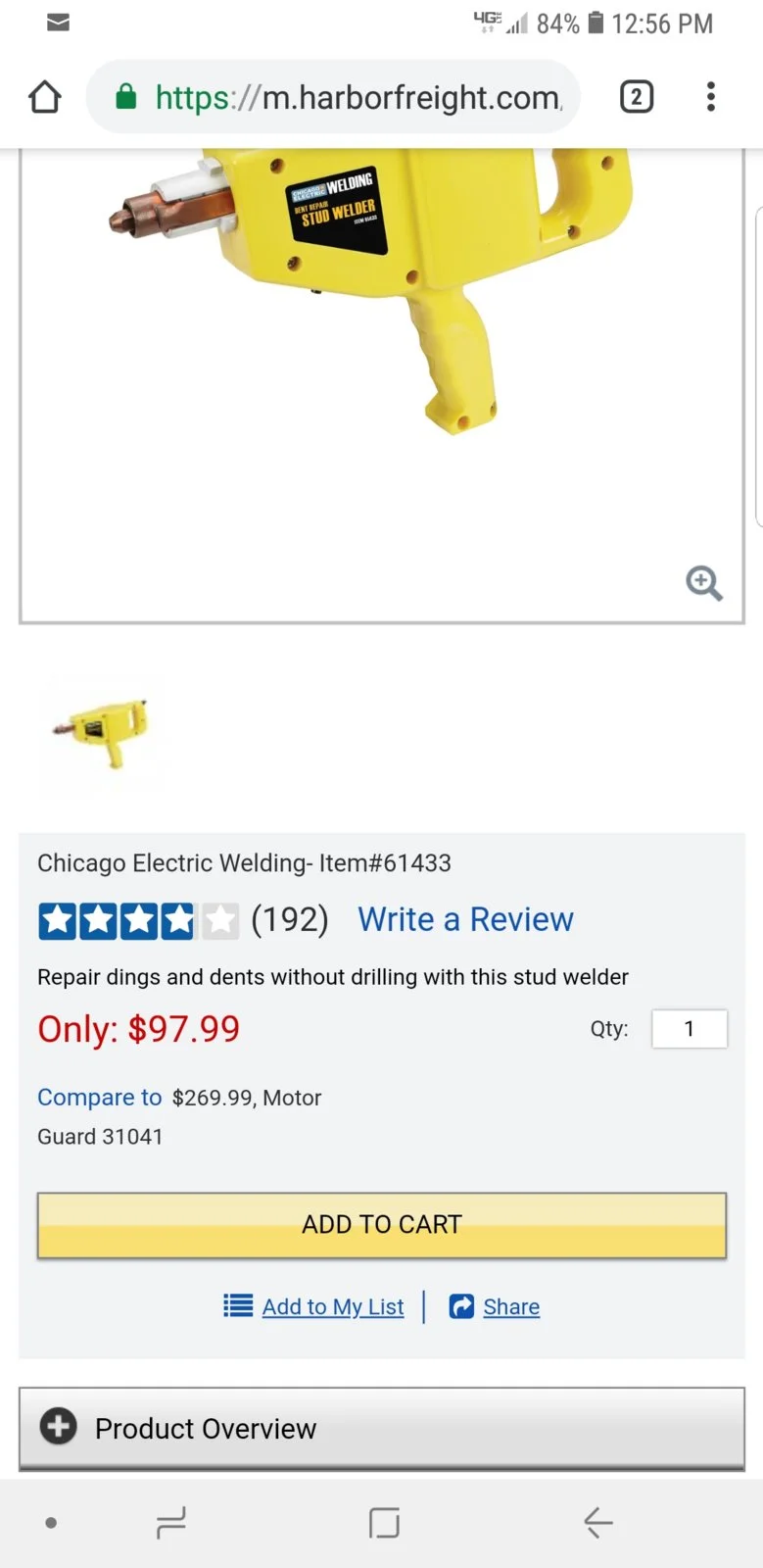

Whatever happened to the inner structure to make it separate from underneath the folded over outer skin is beyond me, unless it was never that way to begin with. Either way I need to do somethin with it to repair it. The notion of trapping actively rusting metal under a layer of steel bugs me. I wire wheeled the pitting as best I could, and sprayed some rust converter heavy enough to flow down on top. For now.
The hood scoop came Saturday ( I didn't know it was sitting on the front porch) I'll mess with that tomorrow.
I don't know where I'll get a stud gun, I would have to weld screw eyes and rig up a slide hammer to work similarly, but at the risk of having to cut them off and grind the welds back down and making a big mess doing so.
I'm gonna go get the piece of 18ga. tomorrow that will act as the backer plate to mount the new /old tail lights in. I need to get my welding bottle refilled too, but no longer having a pick up truck to haul the bottle in, welding gas companies are not allowing a bottle to be transported inside any car.

Harbor freight has a stud welder...got 4 stars...worth a try.
CarMichael Angelo
10,641
8,909
Birmingham, al
Nov 19, 2018
#8,919
  • Nov 19, 2018
  • #8,919
even at 100.00 it seems like alot for one dent....considering I can do something similar as described above for 1.00
