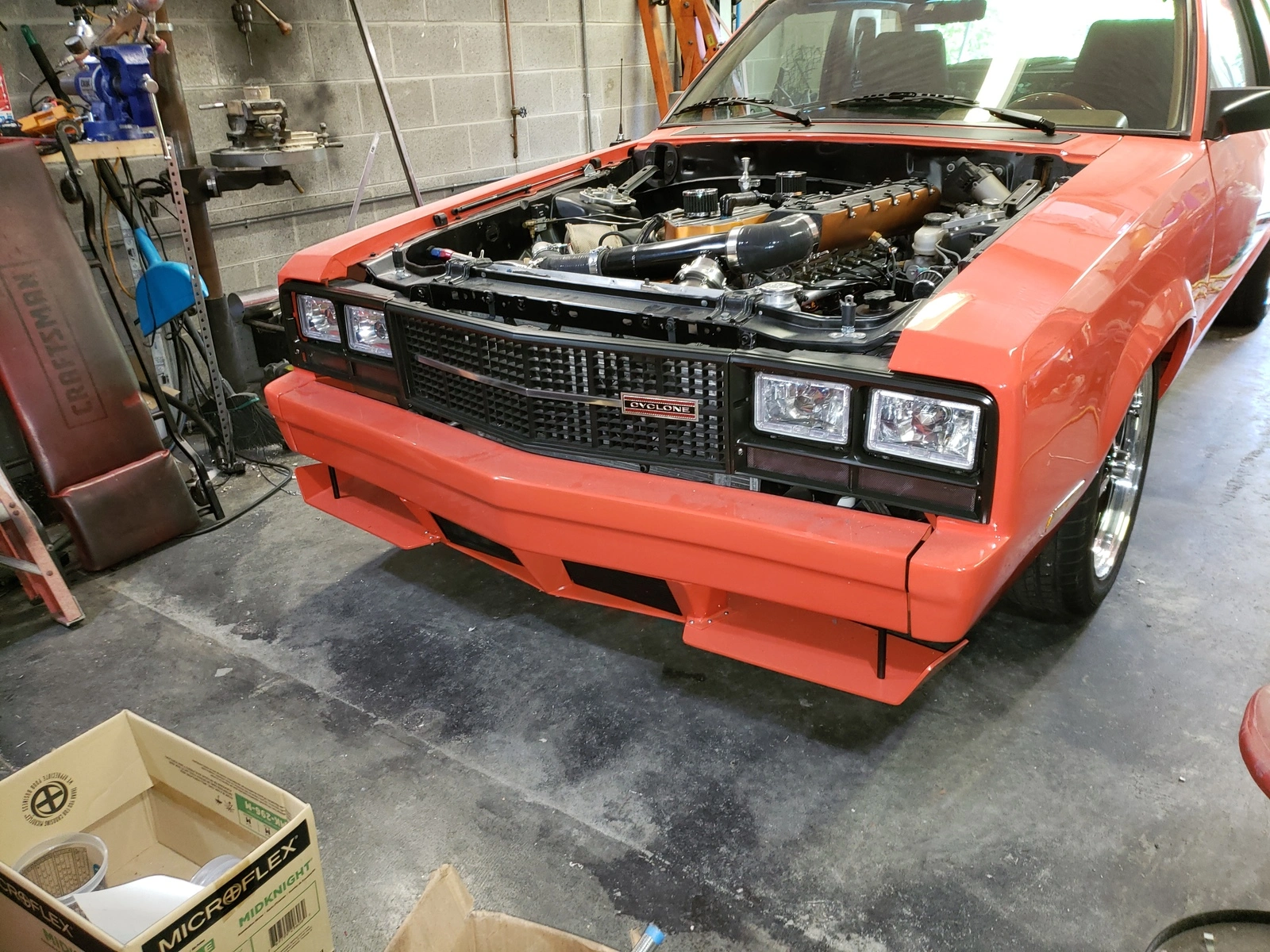

I'm tired.
The grille is black,...and clearly..installed.
As bad as the trunk was, I shoulda got a different one. It had pretty significant impact damage that had started to rust between the bottom and top skin. The metal was separated, and badly pitted..and to make it even worse,..it had fairly heavy hail damage.
But...
It's not like there is a buttload of futuras out there to choose from...so I had to fix it.
It's primed,, and it's close to to being good.

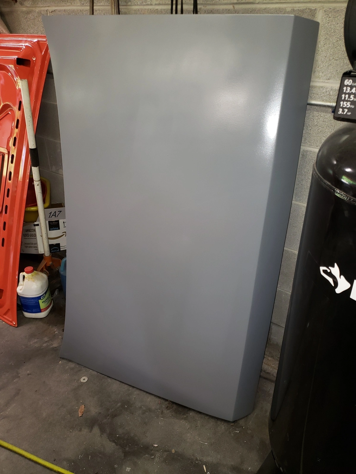

The hood was much better, but was still damaged where the prop rod had caused the hood to break at the mid-point where old futuras have their prop rods. That, and having having to make the reinforcements for the Aerocatch hood pins made this into more of an ordeal.
I missed a small dent,..and there's still work to do to blend the center line upfront where there was a hood ornament, but at least it wasn't trashed by hail like the trunk.
Don't know when I'll get to work on it next...but at least it feels like I'm closer.

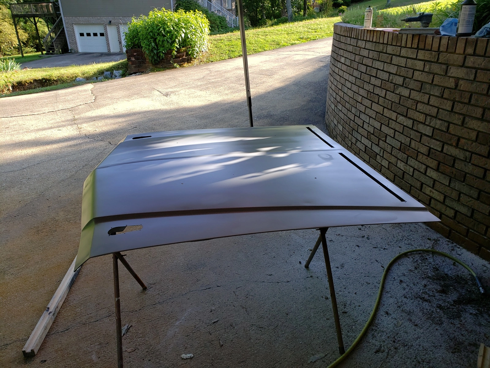

Ok then.
It's my turn to ask for opinions.
If you look, you'll see the holes drilled for the scoop. I'm committed to it. It fits nicely, and I think it looks good.
The question is: to cut the hood under it, or not.
I know that no "cold" air will get into the opening as a result of any ram effect due to its placement, and low profile. That isnt the objective for the cuts. I want "hot" air to be able to get out in slow or non-moving traffic.
The dilemma is rain, and the red hot hotside that'll be exposed to the rain should I get into something like that while driving.
It seems to me, if very little air is gonna get into that opening as a result of placement, how much rain will get in instead? And,is this all a non-issue that I'm worrying about?

leave it closed off and simply use it as an aesthetic piece, I do not see any reason why you would want to expose the engine to rain if you do not need too.

Several holes instead of one big one?
maybe add a small weep hole at the back of scoop to release water trapped in the back?
honestly, I believe you are over thinking it.

Leave it closed and leave the worry behind. If you get caught in rain at a stop light, water will surely get in.

I vote closed as well.

Ok closed it stays...but when this thing boils its balls off in Mississippi summer traffic..I'm blaming all you bitches.

I can say that I have all of the paint product to do this now. Today, I bought 1qt. Of Competition Orange in urethane, and the required reducer. Turns out, I actually have a hardener product that will work with this , so I was able to get that scratched off the " I need" list. It took the better part of the afternoon to block the mess I made of the hood and trunk.
I've got to figure out how to spray paint that doesn't look like Elephant hide.
The primer that I spayed on Sunday was so orange peely...it was like sanding ........Well,....Elephant hide.
It took forever to get it flat.
