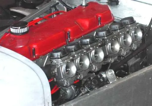

Ford used the butane/propane method to set the idle speeds on the four corner Holley 4180C 4-bbls carbs on the 5.0's for 1983 to 1985. Its got nothing to do with jet size.
Plastic tubing the sealed off Speed Density system on idle is the best way.

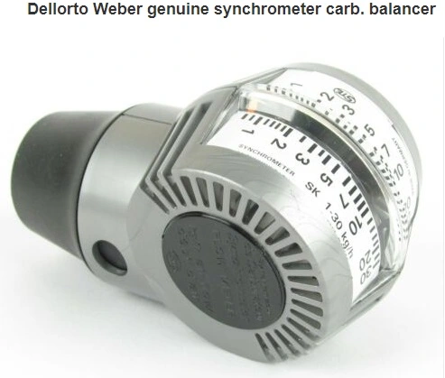

Holden's Triple Zenith Stromberg CD 175's on the GTR XU-1 used the Syncrotest;
For Speed Density, EFi, that doesn't work.
You can make your own if you want to tune your six Mikuni Carb X flow

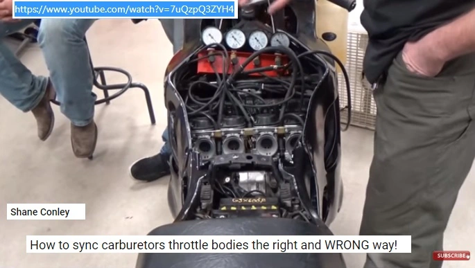

The easiest is manometer or gauges
View: https://www.youtube.com/watch?v=7uQzpQ3ZYH4

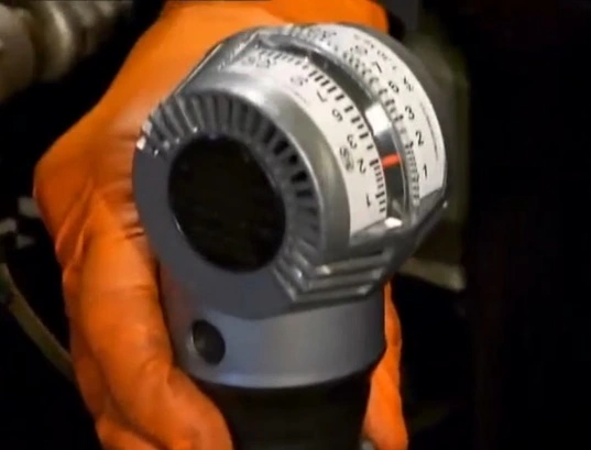

Actually the 1973 Lamborghini Urraco P250S, the underpowered early version before it got 3 liters.
With quad Weber IDF carbs feeding the V8, it had this process to follow from 28 to 33 minutes
Sychrotest
Here is the partly dyslexic flipped and reversed video that makes a right hander Left hand drive in the service bay, and back to RHD on the road.
View: https://www.dailymotion.com/video/x6gynar
