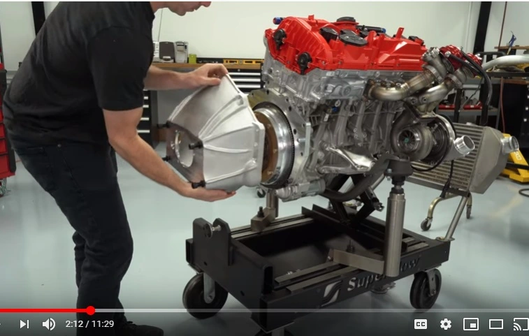

Just a final post as a Ford guy who will always love the great work you do.
I' m not a Toyota in line six guy at all,
even though I have a whole bunch of all wheel drive twin cam variable valve timing 4 and 5 valve per cylinder Tojos and Neesans, and Suzkukis too
but hey, opinions are like belly buttoms and a-holes, and people with d!c|<s......what I know is that your gonna do this and its gonna be epic my man!
Thankfully Toyota saw sense and used the B58 BMW engine.

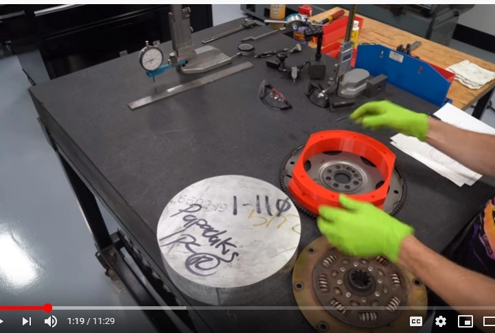

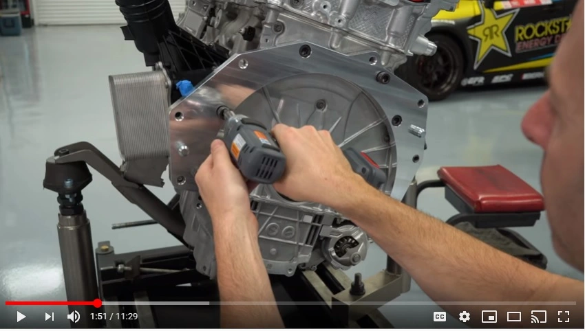

The bellhousing creation is basically Super T10 Borg Warner, which is what the old FMX Detriot Gear based BW Model 8 derived base the AOD used.
Soo, check out the video, and make your transmission guy do the work to fit it all up. Very good ideas you've got, Mike.
View: https://www.youtube.com/watch?v=WzgzSnYDvz4
Good fortune with this.
From X, aka Deano not ever a Bimmer or Toyo or Nissan guy but Well wisher.
Nail it dude!

The new bell housing, ( aka the Iron Maiden) is basically a bird cage that bolts between the back of the 2j, and the newly cut up 4R70w. Albeit that this “ bird cage” is made to hold a thermo-nuclear bird, ( crisscrossed 3/16” bar).
But....It’s still an open cage. Personally, I see no reason to close it in, but I understand the potential risk should something come apart at some stupid rpm. At the same time,......Like what?
I have never seen a failure of a flexplate or torque converter that resulted in anything trying to blow up and at the same time, blow some part of my foot off..But that's just me.
Has anybody else?
It seems to me if I leave it open, I'll have air movement around the converter, and that would be better than sealing it up in that regard...but itll also allow any fluid that may leak from a seal to paint the underside of the trans tunnel as well. So it all comes down to a few pro/cons..and that would be the topic of discussion for the motley crew.
