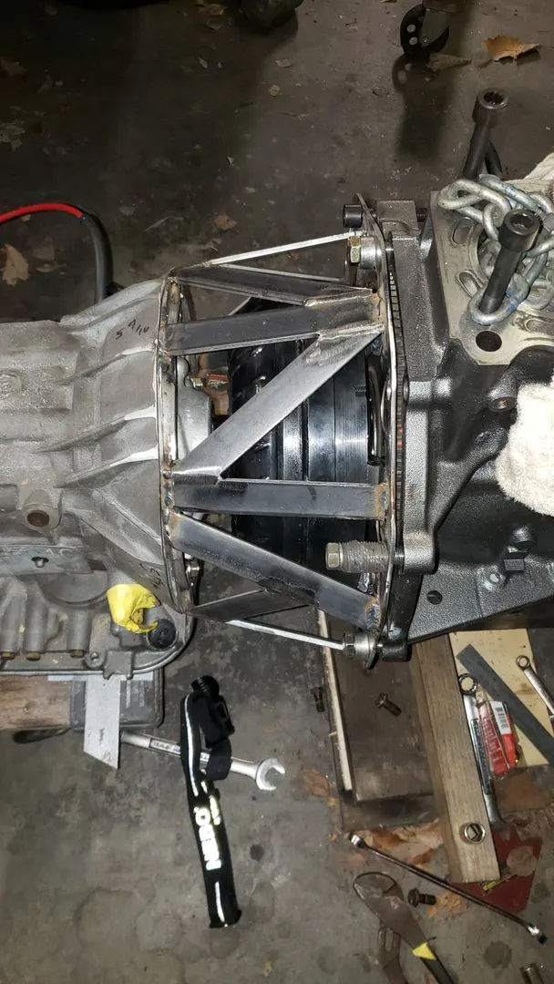

So,..I gotta make do. I have a converter that fits a non-turbo flex plate, a non turbo flex plate that the converter will bolt up to, but won't fit the engine,..and a poor butchered up, and patched together flex plate that fits both.
I have no choice but to make it work.
I had to work on Saturday so nothing happened on that day. Today I managed to eek out a few hours before being married took precedence.
I feel. like I'll never get this done.
But, this is where I am nonetheless:
The iron maiden...still needing an additional 1/4" plate welded to the front of it where it bolts to the block. I'll have to duplicate the flange that is currently welded in front and weld that to the existing frame. Then, to add the necessary 1/8" of travel for the converter, I'll add seven pieces of strap to the back of the IM to space the trans back,..then,..I'll add 16 ga. Plate between the triangles that make up the cage, and call this thing done.

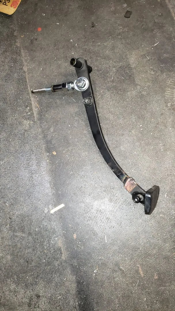

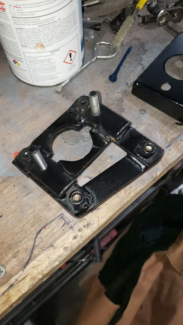

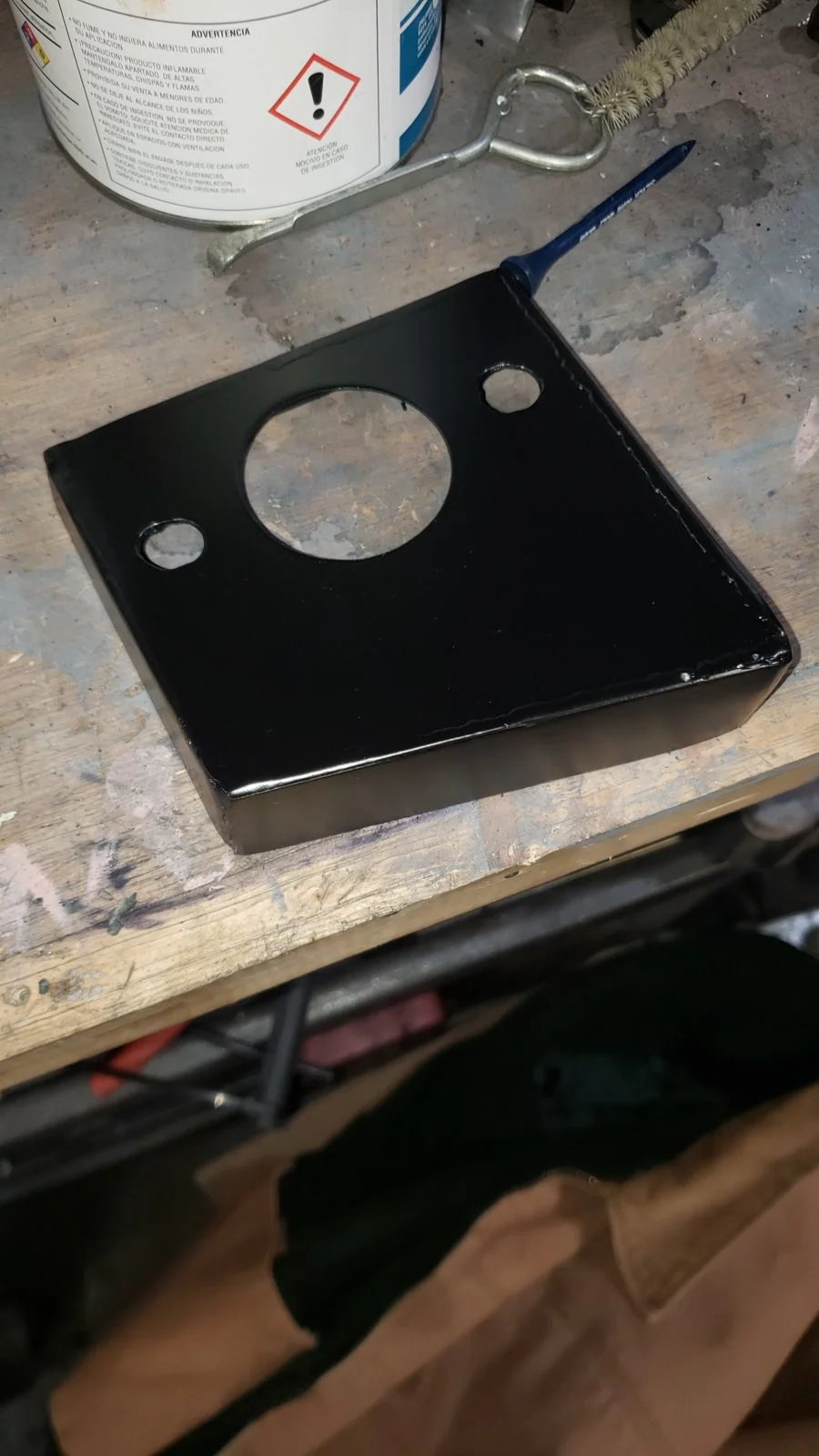

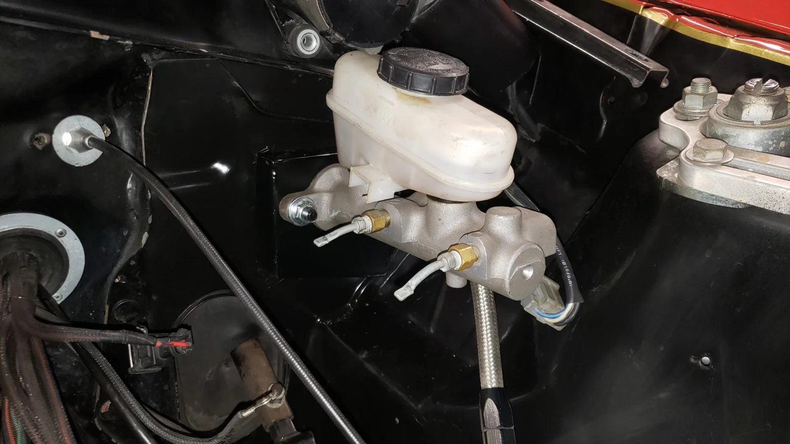

I had to make my own firewall block to raise the master cylinder. It's an ugly little bastard..
He needed to be covered up
And when you bolt it on the firewall, it all goes together like peas and carrots.
It stands to reason that I wouldn't have done that if I didnt have to, but after modifying the brake pedal as much as I did, It was necessary.

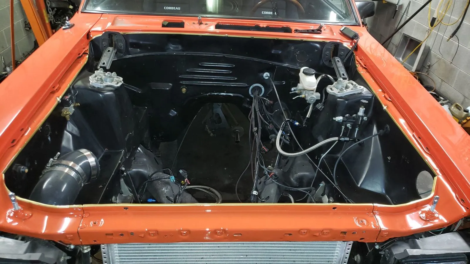

And finally,....when considering the big picture.
So much of this junk has been done for weeks now, but I can't get past the damn transmission. I think I'm close to getting it figured out...

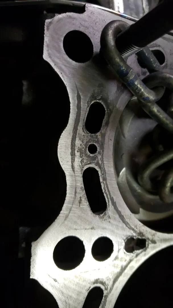

Once I'm done with the transmission, I'll put the engine back on a stand, and take the thing apart. So it can be decked,..so I can get rid of this pitting.

Believe it or not, the bellhousing is really light. Right now, I'm gonna guess under ten pounds.

That looks good, but I wonder how much torque it will handle. It seems kind of light consider steel cans are 1/4" steel and the factory cast aluminum bell housing on a turbo 400 is at least 3/16".
It's about the angles. By the time this is finished, the plate that bolts to the block will be 3/8" thick. The tabs that bolt to the front pump are 1/4", and the angles are made with 3/16" bar that will be plated with 16 ga. Steel.
I'm not the least bit concerned about its strength,..it's always the little things like...
"How far off in degrees it is from true center" i.e. Is it shifted/tweaked/misaligned, or twisted in anyway that will cause something to fail as a result?

I think it will be plenty strong. The 100bl bell housing thing was an exaggeration. That is my favorite part of this whole 2j swap so far. It's a masterpiece that only the few here will ever see. When its plated it'll look like part of a military stealth vehicle. If Tesla had a designer like you working on that concept truck it would actually be a hit.
