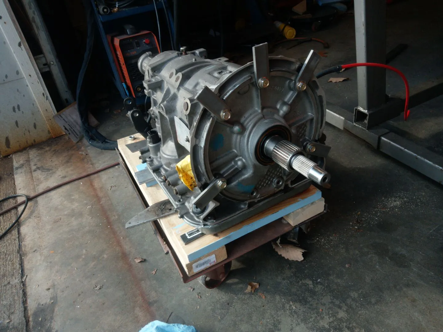

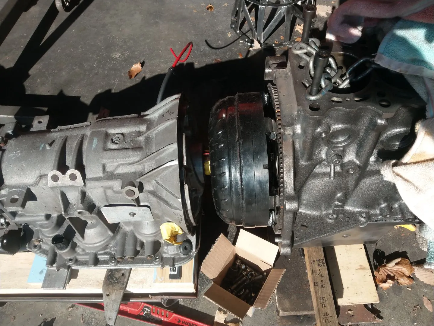

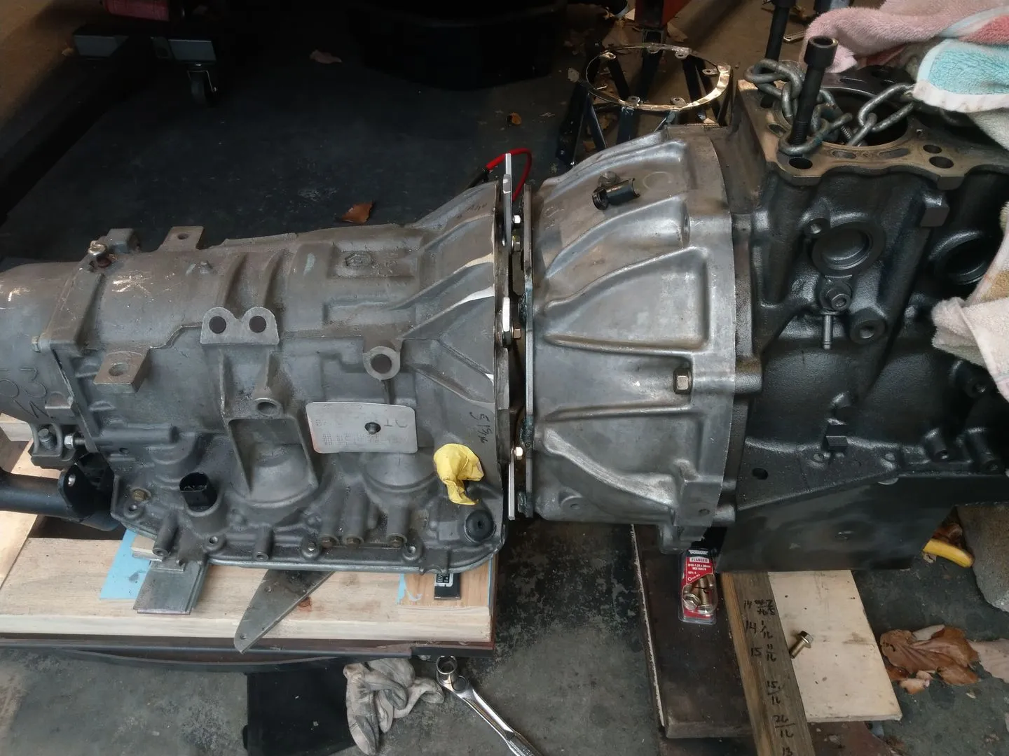

The engine is leveled, as is the trans. They are both at the same height. The trans, and converter slide together effortlessly.
The plan is to use the removable bell from the Jap trans,..make a plate that’ll bolt onto the rear of that bell,..make tabs that’ll bolt to the front pump of the trans,..weld them together.
I make the plate..
I make the tabs for the trans..
I make these out of 1/4“ bar...I also add a washer behind to apply pressure to the pump housing when I tighten the bolts down, just in case the tab is riding on some part of the trans case instead.
total thickness of those tabs.......just a tick under 5/16”
I put the stuff together....I merge the two pieces....it ain’t gonna work.
the plate I made to go on the back of the bellhousing blocks the bolts to the front pump..In other words, if I weld these two pieces together, I’ll never be able to get to the front pump bolts ever again...
You can see the plate butted up against the top two front pump bolts...I’m phcked. I can’t drill access hole,..the bolts that go through the bellhousing into that plate interfere with the bolts that go into the front pump..and.....they are holding the trans too far back...the converter is actually out of the front pump by about 3/16”
You’re lookin between the trans and the back of the bell at the converter hub. That tape was against the lip seal of the front pump,..now it’s at least 3/16” out, and the bolts that go into the front pump are jammed against that plate. Again,....I’m pcked.
I’m so freakin angry that I cannot get past this that I have an epic temper tantrum.
Its at this time that I get a blinding headache..It literally brings me to my knees..My vision goes away,...my head feels like it’s gonna explode..............Im having.....I mean,...I have,.......an Epiphany.
I’m gonna be able to fix it..I’m gonna be able to finish this damn thing.
the 1/4” tabs can be changed out for 1/8” tabs...I’ll get an 1/8” back and the converter will barely be out of the front pump. ( it’s supposed to be between 3/32 to 1/8“ out of the front pump anyway) I’ll have to gusset the tabs to give them the strength that the 1/4” tabs would have,..and since I can’t weld the two pieces together,....I’ll make it so I can bolt them together...
Then,..I’ll be able to get to the front pump bolts....after I unbolt the plate that blocks them...and most importantly after two months of fcking with this,....
I’ll be done.

@ CarMichael Angelo
This is a machine shop project that may eliminate most of the DIY manufacture; it may also be expensive. The biggest hurdle will be finding the countersunk bolts in sizes and prices you are willing to pay for them. The Military Spec MS24672 series bolts are a starting place for the bolts that you will need. Again, Google is you friend in this department.
Why not use two pieces of ¼” steel plate cut as a circle whose OD is about 1 1/2” larger than the diagonal measurement across the largest component. Now you have two circular pieces of steel the same size.
Then layout the bolt holes for each piece, drill and countersink them. Keep in mind that metric fasteners have a 90° countersink angle while commercial US fasteners are 82° countersink angle and MS & NAS aircraft fasteners are 100° countersink angle. For simplicity’s sake you may want drill and helicoil all of the bolt holes to US threads. One plate for the bellhousing and one plate for the transmission. Center both plates up with each other and drill and ream holes for two ¼” alignment dowels ½” from the outer edge of the perimeter of the plates. Install the press fit dowels in one side and ream the other 2 holes to make a close fit. Mate the two pieces together and drill the outer ring of holes about ½” from the edge. Choose the bolt size – between 5/16” - 3/8” and use grade 8 bolts You are probably looking at 10-12 bolts for the outer rim in order to get the shear strength that you will need.
Cut out the inner portion of each plate to get the required clearance. Secure the plates to the bellhousing and the transmission/front pump with the countersunk fasteners. Test fit the two components for fit and alignment; using ¼” plate means that you will have about ½” thickness for the two plates bolted together. Too much clearance means that you have to remove material on the side opposite the countersink holes on both plates. Two little clearance means you have to add some shims made out of sheet steel in the form of a ring about 1 “wide. The dowel pins will help keep the parts aligned to make sure it fits straight and true, so be sure to use them if you have to add any shims..
