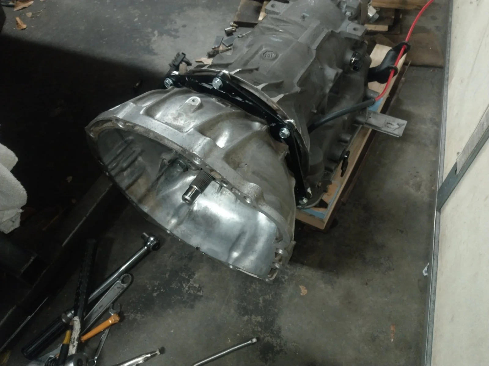

Did I solve my problem???
I think I did.
But not without the commensurate “ hanging chad”.
Anyway, today is my day off. Last night Im sitting on the couch, and I jump up, tell Kate “ I’m soldering”, and go downstairs and bring up the DIY Jim Stim kit, and the Jim Stim X kit. I think it was about 8:30.
I sat in one place with my knees bent and body hunched over the counter for 2 hours......solderin’...
Till rigor set in.
I had to be pried off the chair.The other one would have to wait till tomorrow...which was today.
Again it goes without a hitch,..done in an hour...Except.....
I put the DB 37 connector on the wrong side of the board. How was I s’posed to know it went on the bottom of the damn board?
And as a direct result,...spent the next 2 hours trying to unsolder 37 tiny assed pins all right next to each other. If it isn’t fcked up as a rats ass, I’ll be amazed.
That meant that I had shot the entire morning squarely in the ass. I was in the garage immediately after that.
What was the plan then?..I’ve been saying that I’m at the precipice with the trans for a couple of weeks...Despite that, each time I’d go down there I’d add more reinforcement to the the individual sections of the brackets that make up the adapter.
I think I’m finally done with that sht now.
Part A.
Part B.
Simple math after that...Add part A to Part B to get part C....
So,...where’s the hanging chad?......
When I put the front pump back in the trans ( after removing it this afternoon to be sure that it wasn’t full of metal junk), I replaced the front pump bushing, the front pump seal, and the front pump lip seal.
The front pump seal sheared off a little bit of the lip sealwhen I tightened it up....A sure fire leak. That left me no choice but to reuse the old one..the one that has been exposed to welding heat.
It sheared off too.
Then to add insult to the injury,...one of the pump bolts did that thing that bolts do when you know it stripped....it tightned till it was tight,..then it loosened.
So I got that going for me....
which leaves me nothing but to resort to the basics...

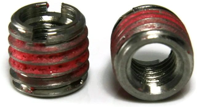

KZGUNS
I can swing up to 11”
5 Year Member
Jul 23, 2018
1,002
588
133
chardon, Ohio
Dec 18, 2019
#10,917
  • Dec 18, 2019
  • #10,917
Threaded insert perhaps.

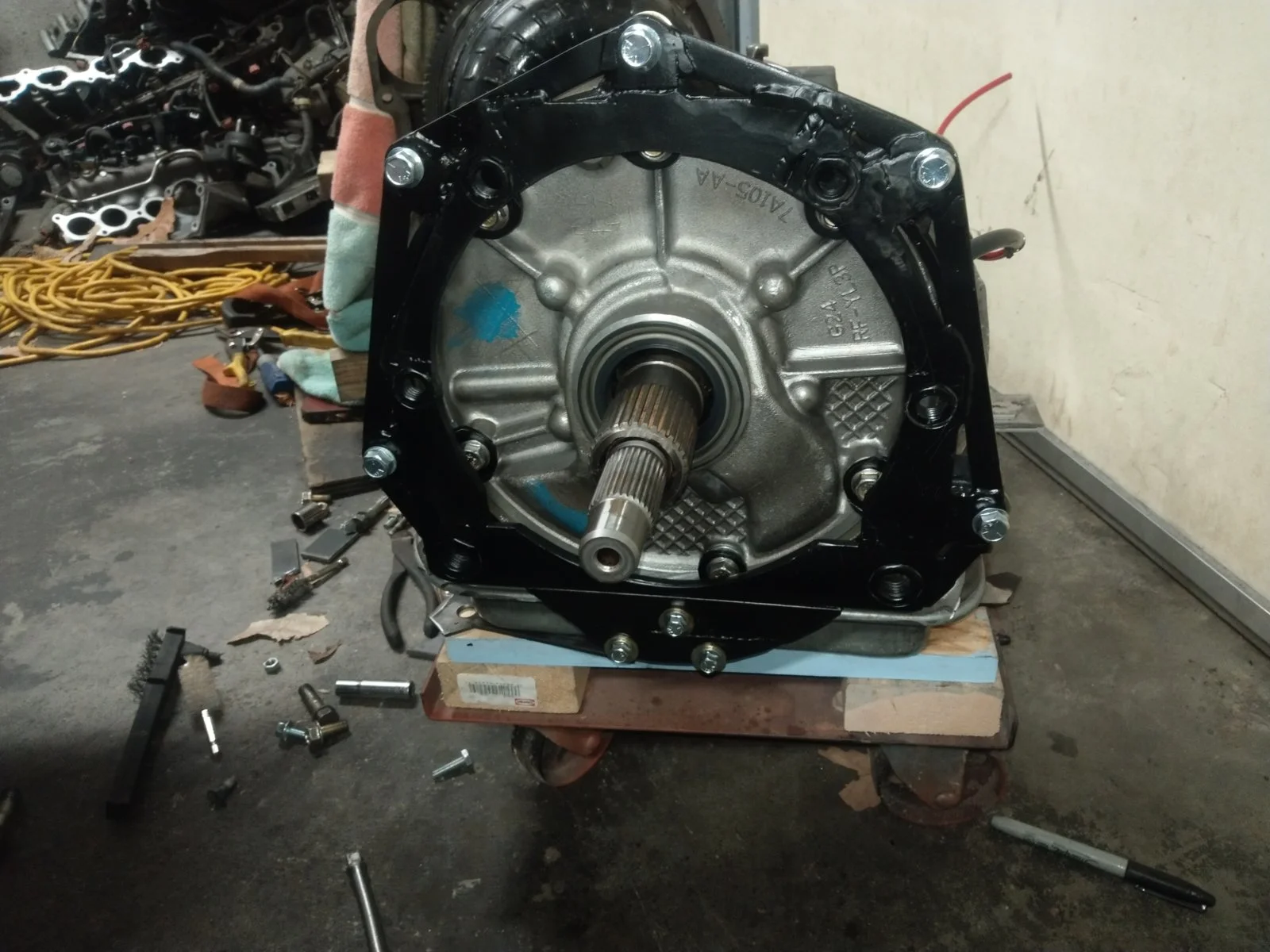

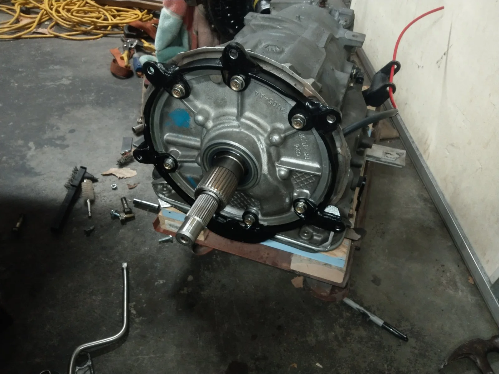

Ok....
Im measurin’
From the mating surface of my adapter plate to the back of the 2j block is 5-3/8”.
When I lay the bell housing on the floor and measure from the floor to the back of the bell housing.....5-1/2”
1/8” diff. The converter will hang 1/8” out of the front pump of the transmission.
I call the converter company. I ask “ How much travel should I allow for the converter in/out of the front pump”?
“1/8”.
I'm there.
The front pump O ring costs 4 bucks..I could buy 10 for safe measure, but I don’t want to keep bolting and un-bolting the front pump. The front pump already has a compromised bolt..I gotta do something about the one bolt.that is starting to strip.
( I’m so tired of fckin with this transmission)
The bolt isn’t completely fck’d...I didn’t keep tightening it just to make sure it was spinning, and...those bolts are short when taking into account that they have to go through 1/4” of extra thickness.
Maybe I’ve just pulled a couple of threads.
Maybe a longer bolt will bite into good stuff.
The rod bolts are here now,...I have every single thing to put the bottom together minus machine work, including a custom sized 86mm piston ring compressor. All I need to create a completely rebuilt 2jz bottom end is machine work.

I pulled all of the front bracketry off of the transmission. The bolt that was suspect came out with out any junk attached to the threads. When I went to thread it back in, it went in although it was a little harder to thread in than the other non-damaged holes. ( clearly, I’ve got something going on in that hole)
nonetheless, I threaded the bolt in by itself, and went the extra 1/4” that this tab is holding the bolt off. It threaded in all the way,..it feels like it’s gonna go tight when in put some torque on it.
