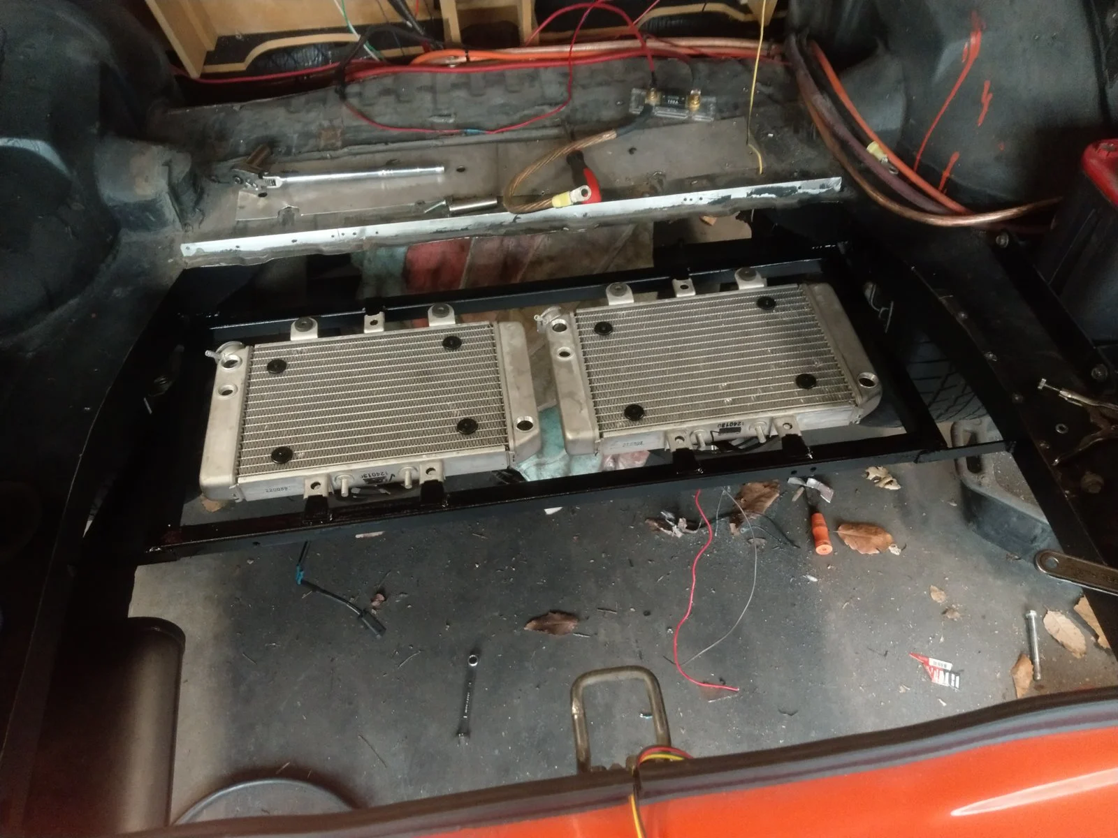

Which coolers are those in the trunk? Oil coolers moved back, or no?

So, this about that.
The radiator up front is oriented incorrectly, now that the 2j is the engine. MOF, a Chevrolet inlet/outlet config is what I really need. Knowing that, the plan this morning was to consider using old radiator as a heat exchanger mounted in the rear to cool the water for the intercooler.
It never made it off the floor where it was sitting. The thing is just too freakin huge to consider using it for that purpose.
That has me rekindling the old dual radiator setup that was in the car when it first came out. Whether or not those little pieces of crap will be capable of cooling the water after it starts to heat soak will remain to be seen. This time around, I’m gonna seal them under a removable floor, and they’ll have to pull surrounding air out from under the car. I guess we’ll see if this stays at V1, or if I have to change it.
The dilemma is how to route the water..Do I split the water to both radiators, and then combine the the outlet that will go to the front mounted intercooler, or do I daisy-chain the two of them together, and put water in one end, and let it go through both before it routes to the intercooler?

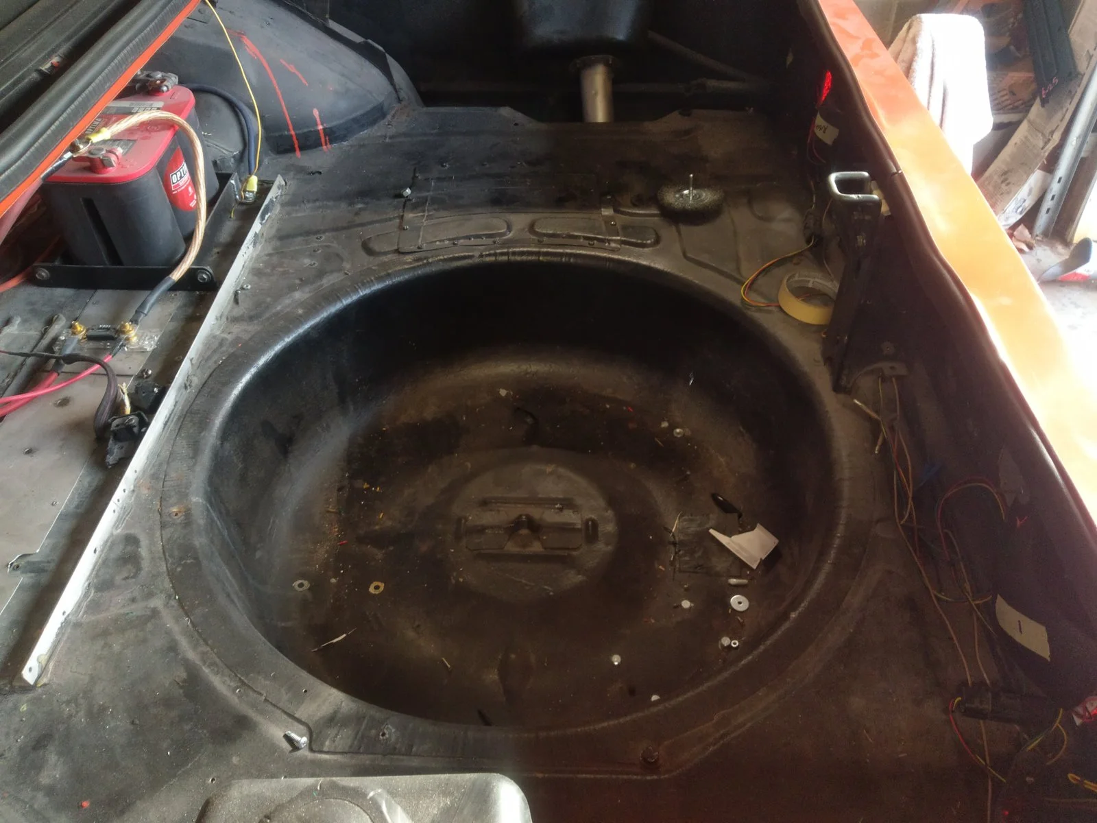

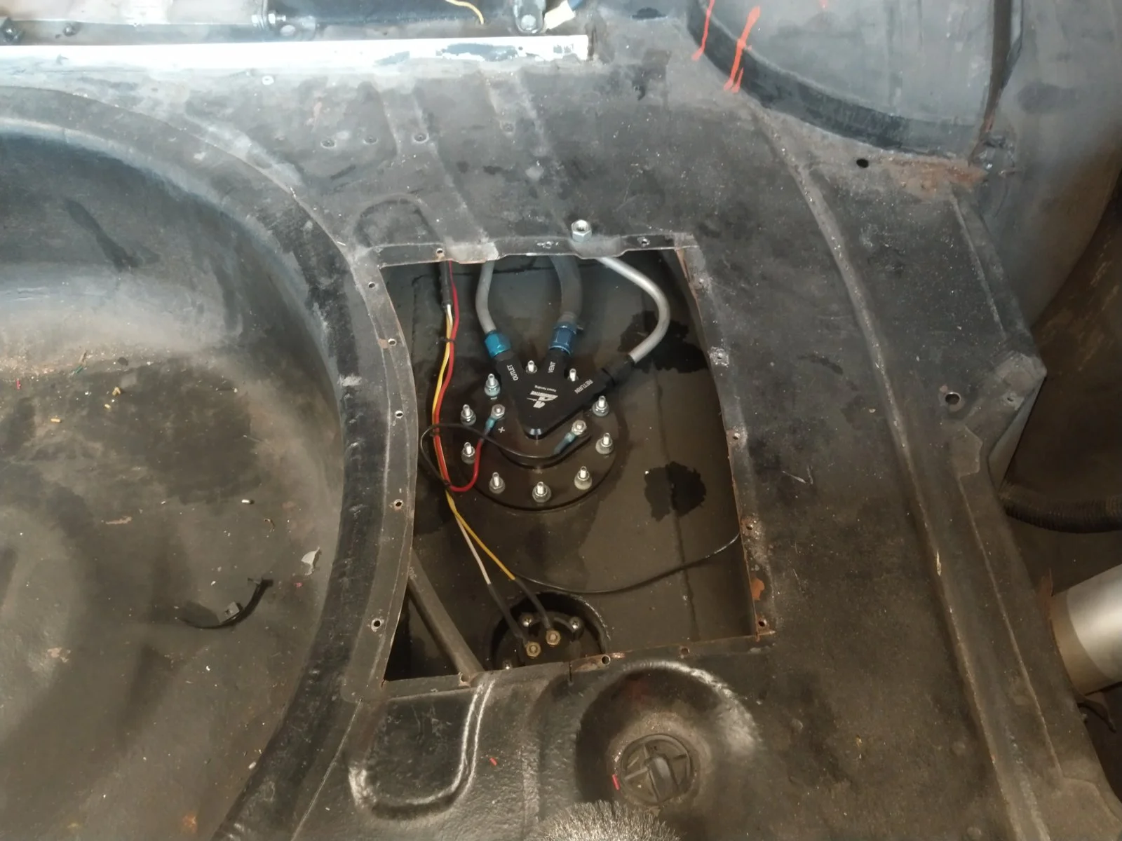

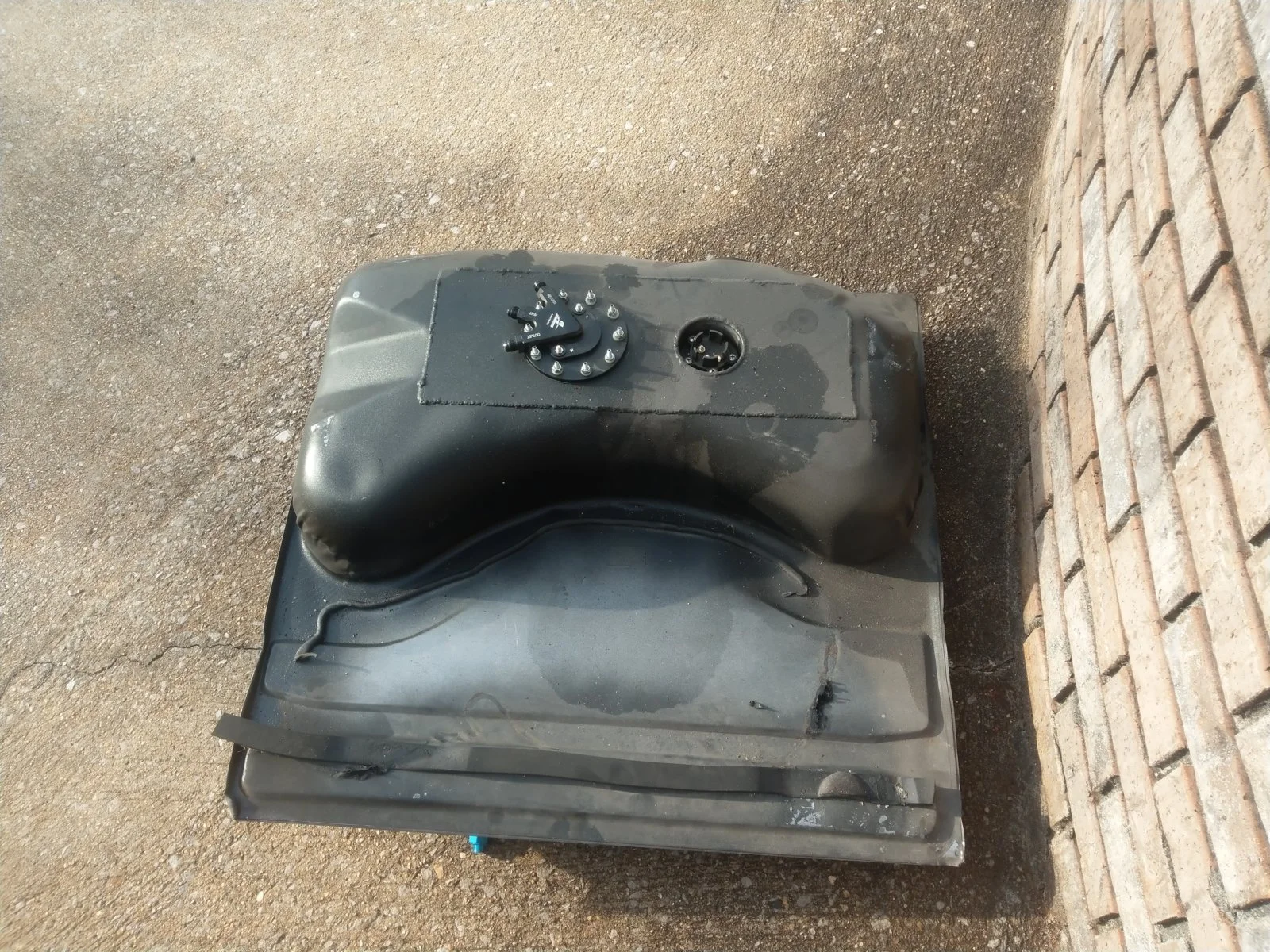

Clearly, that sent the old tank into the scrap yard pile..The intent is to put a 15-17 gal fuel cell parallel across the rear of the remaining space in the trunk. there are several Chinee versions out there, and this is what I’ll probably end up with.
Im gonna have to cut it open and mount the Aeromotive 340 LPH pump that was in the old tank, and change out the Chevy impedance sender for the ford one that also was in my tank, but the price is right, and I can make it fit nicely between the frame rails.
The fuel cell will have till wait till payday though...Along with everything else.
