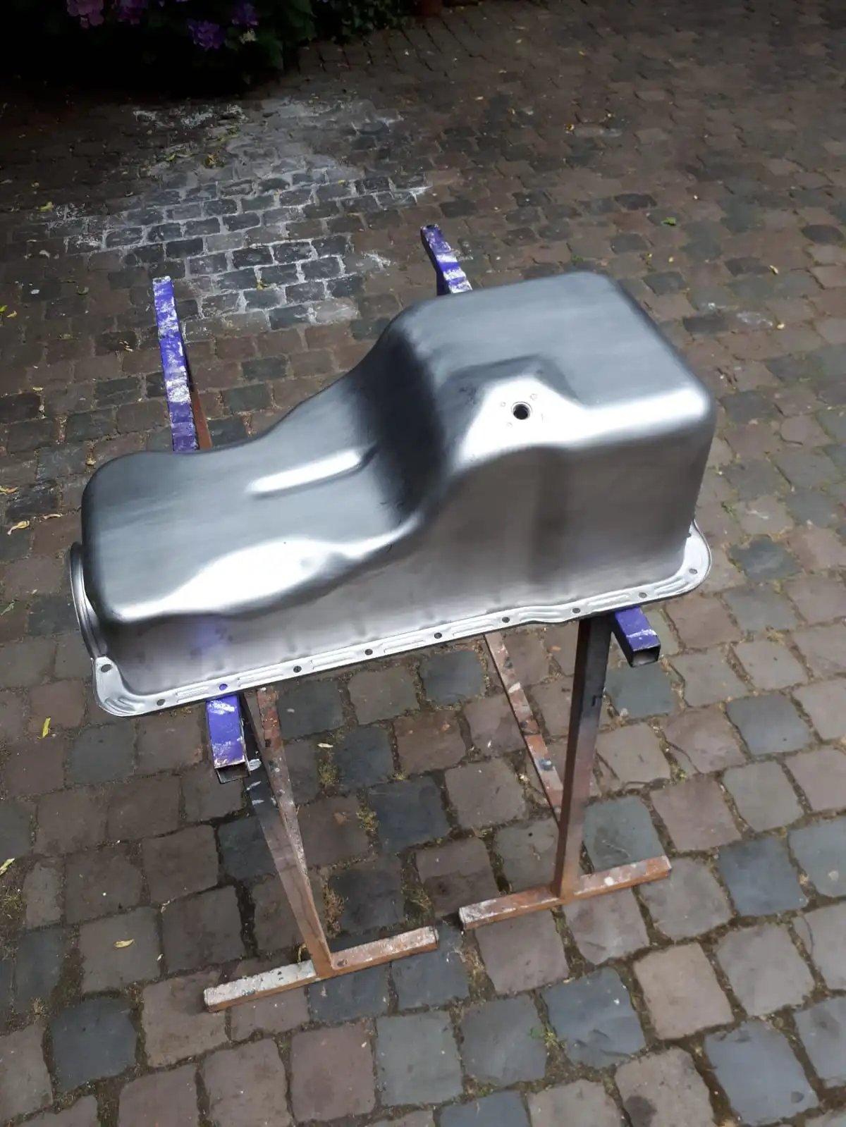

This picture is to illustrate the difference between a II oil pan and another stock front sump pan. I also have a picture of the part number for the oil pan. I'm not sure if it's the complete part number or not, but what I have is still visible. The II pan is behind the standard.
