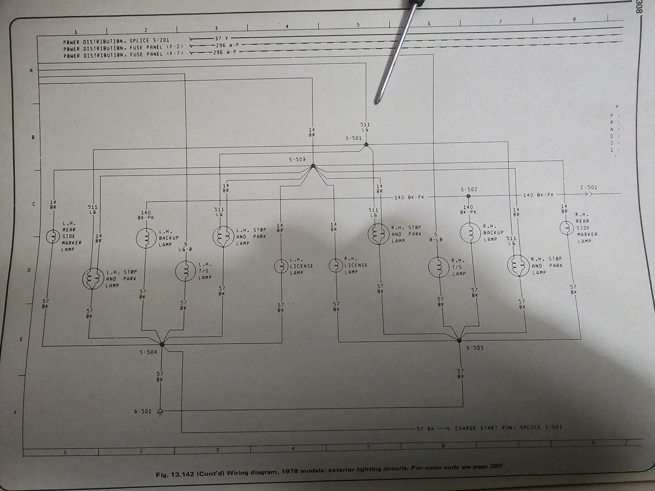

So, the current conundrum is the brake lights. Replaced the switch, and replaced the fuse. I'm getting voltage to the wiring for the switch (not much, but some). Absolutely nothing happening at the tail lights though except turn signals and normal tail lights. Does this circuit run through the cluster?

I don't think it runs through the cluster at all. It may be a ground issue somewhere though. Or, I suppose it could be an open wire somehere in the brake light circuit. It's been a short 20+ years since I've had mine apart, but from what I remember, the tail light harness can be separated from the rest of the car. That may not be a bad idea to find that connection and test the circuit's continuity. It should also help in finding and ensuring you have a good ground back there, though it kinda sounds like that may not be an issue. I'd suspect it shares the same ground as all of the other lights back there.

The reason I ask is that my tail lights are absolutely fine, it's just that they don't light up for the brakes. The wiring diagram I have has part of the circuit from the switch going to the cluster (which is slightly confusing).
If I had to guess, that's most likely for a warning light. Didn't really think too much about that part of it all.

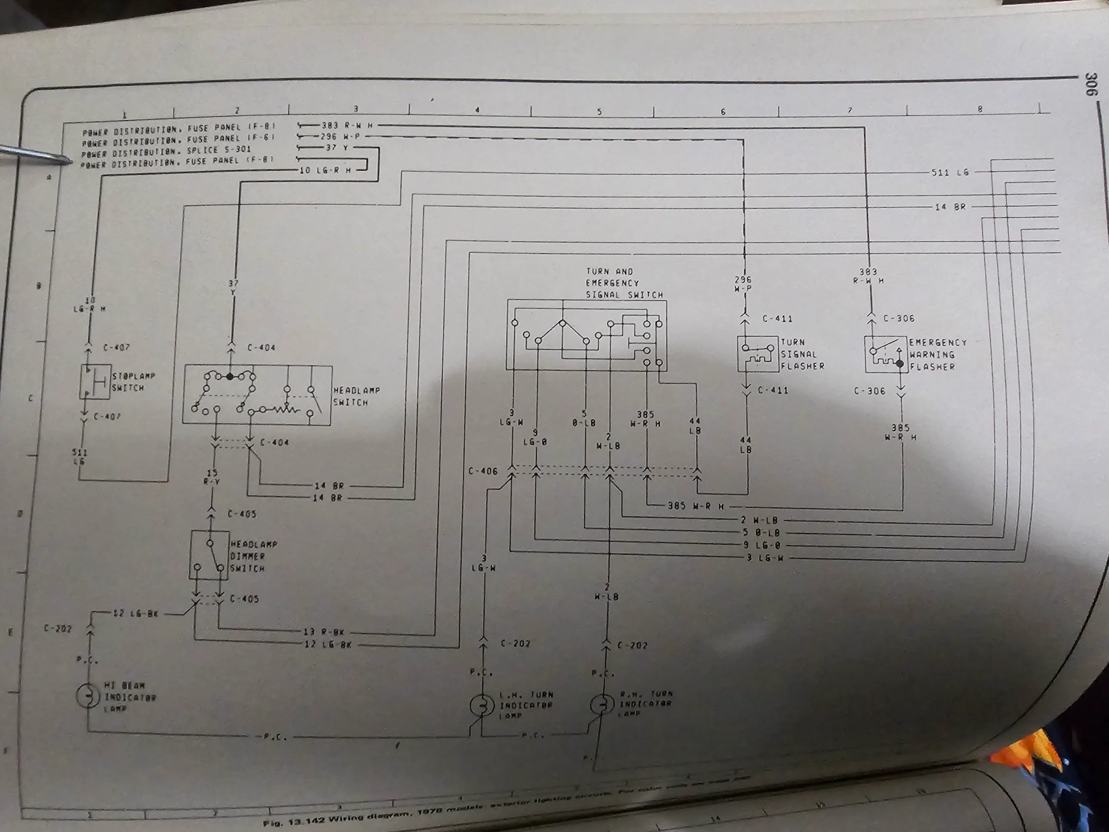

The diagram in the back of my Haynes manual has a LG-R wire coming from the fuse panel location F-8 to the switch. Then, it's LG all the way to the tail lights, then the bulb (obviously....) and black to ground.
These are the 78-specific schematics, but I looked back at the 77 as well and the wire colors were the same. I didn't confirm ALL of the different schematics in the book, but I imagine they're wired the same. Let me know if you want me to look at the others.

That tracks fully, thanks @LILCBRA. Those are the right wire colors, and I guess I'll be chasing that wire around the car. Haha

Upon using my brain for once, I decided to see if either side was grounded, and guess what... the LG side is grounded somewhere. So, it looks like I get to chase it around the car and find out where, then fix it.
