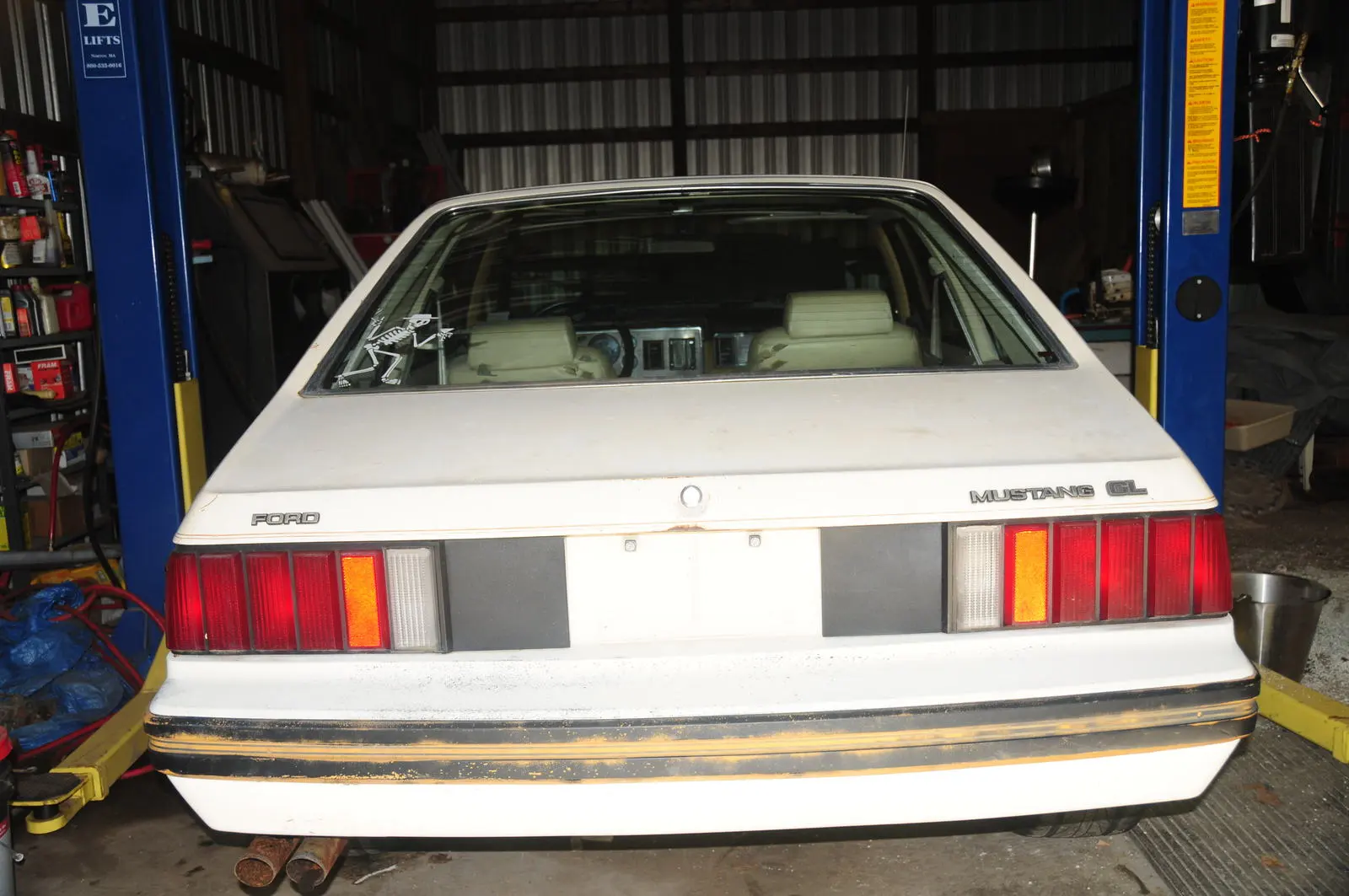

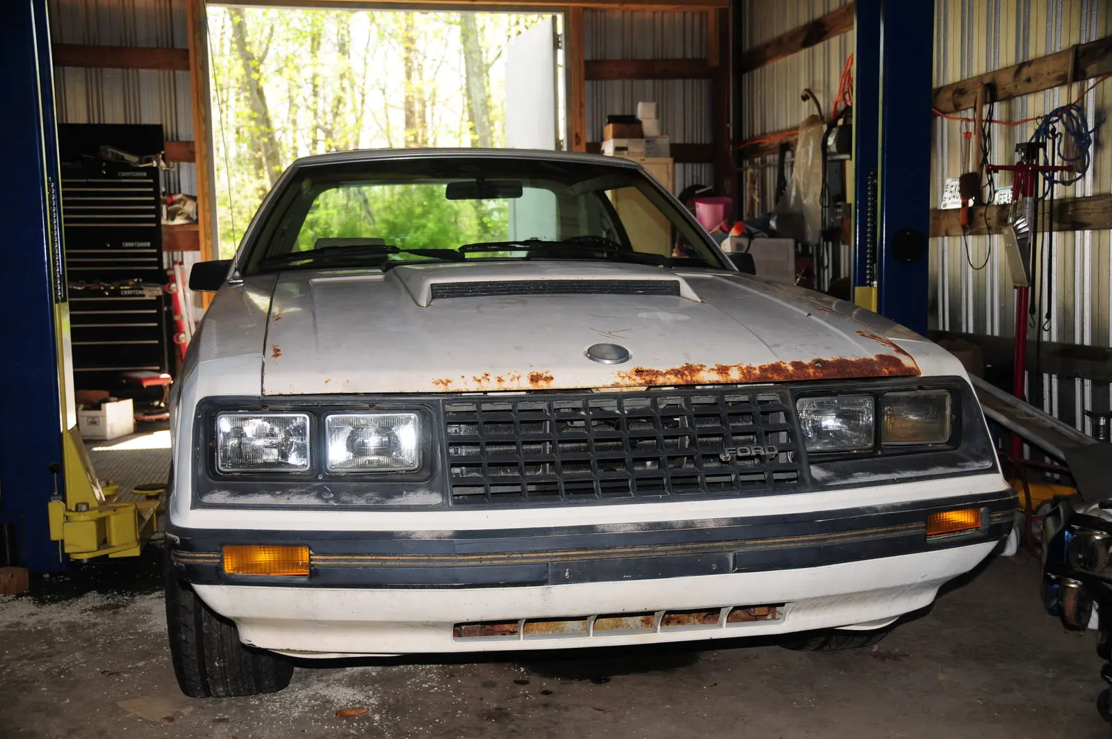

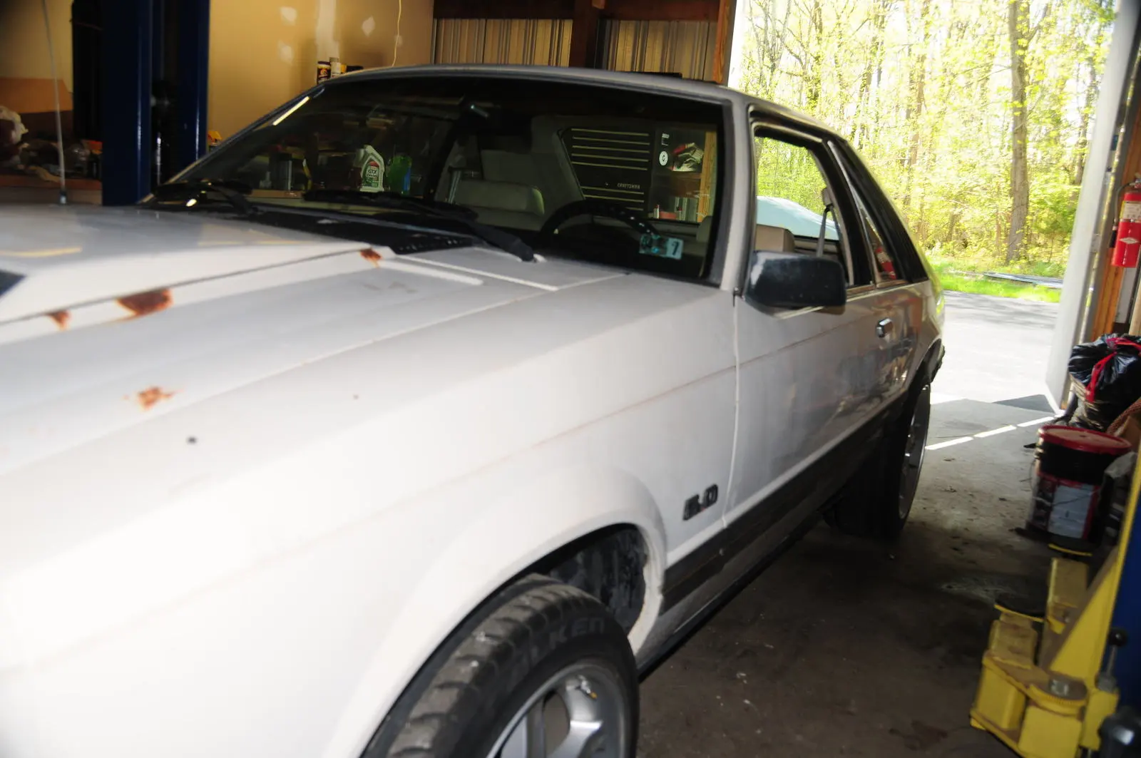

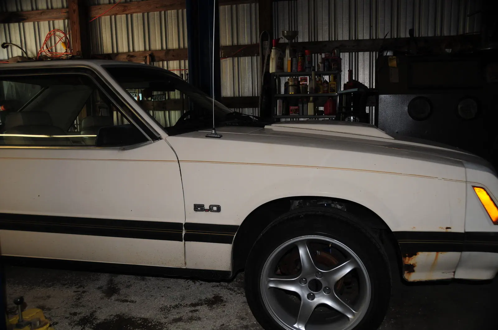

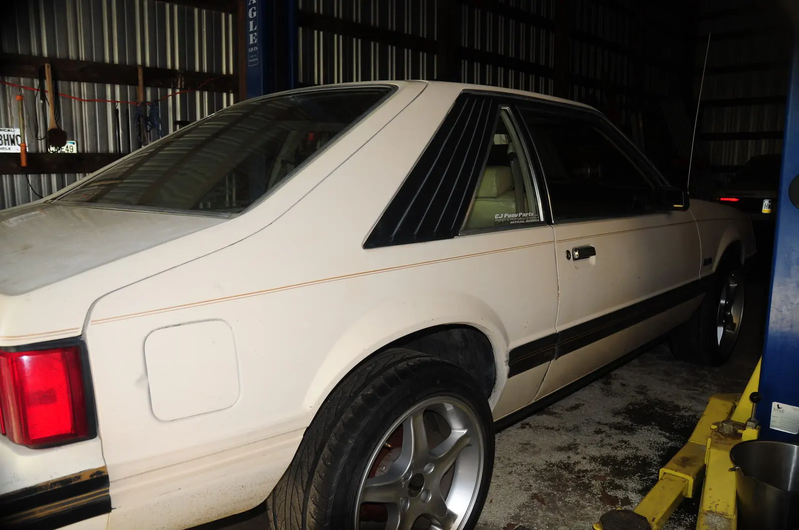

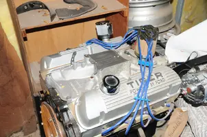

elarm1, here are a few snap shots of the car. I didn't have much room with it being in the garage. The car is rock solid with no bumps or bruises. The only rust is on the surface of the lower front right apron which will be an easy fix. Why the hood rusted out the way it did I have no idea. Luckily the car came with a spare perfect hood. The car has its original paint which will also help the resto process.

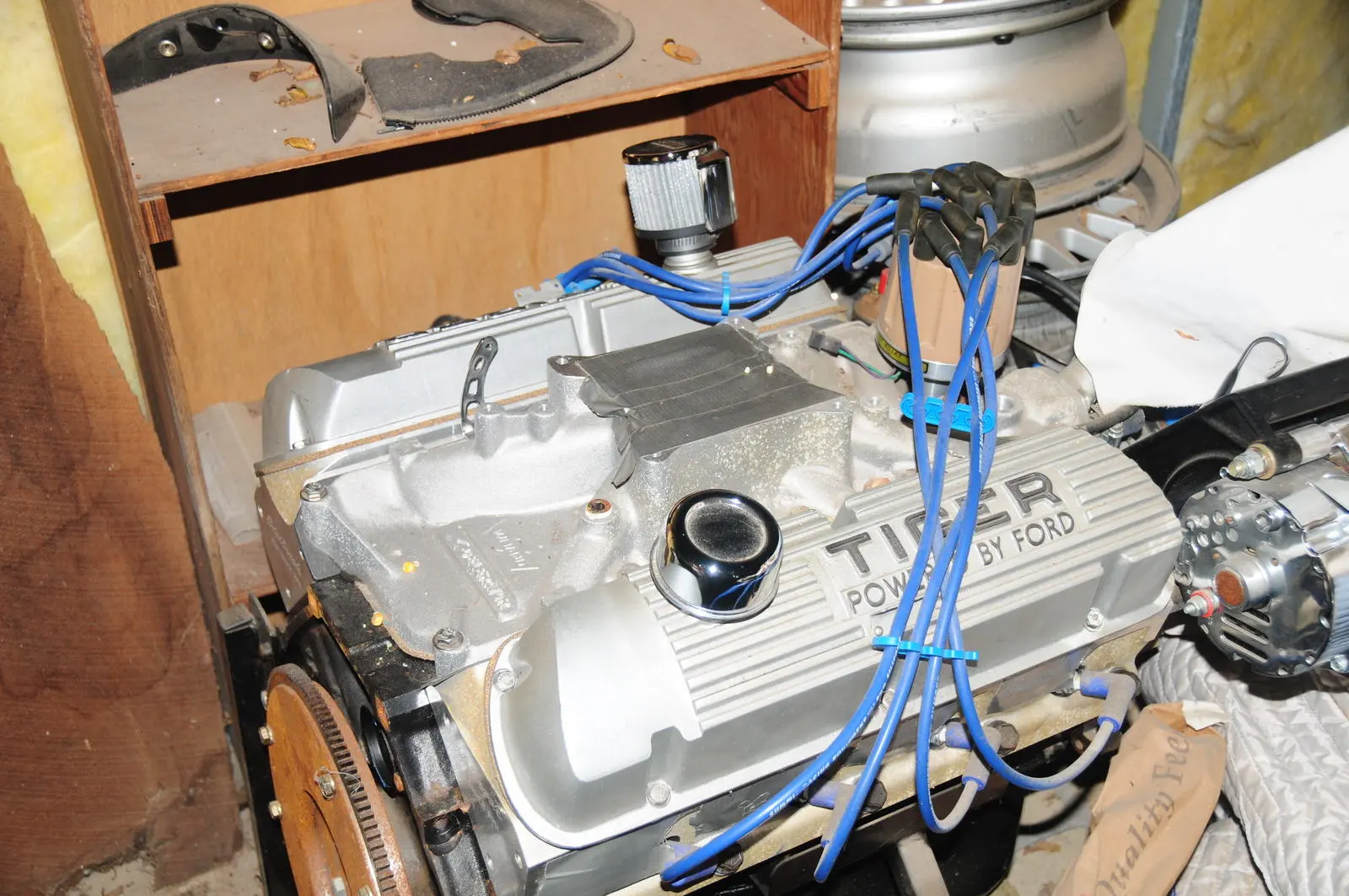

I also attached a pic of the motor. I guess I'll have to sell the Tiger valve covers. I can hear the questions now " why do the covers say Tiger?" What is a Tiger?
Thanks for your interest. If you know of any parts that I could use, please let me know. . . . . Bill
