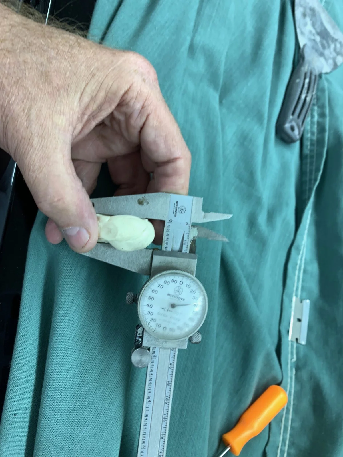

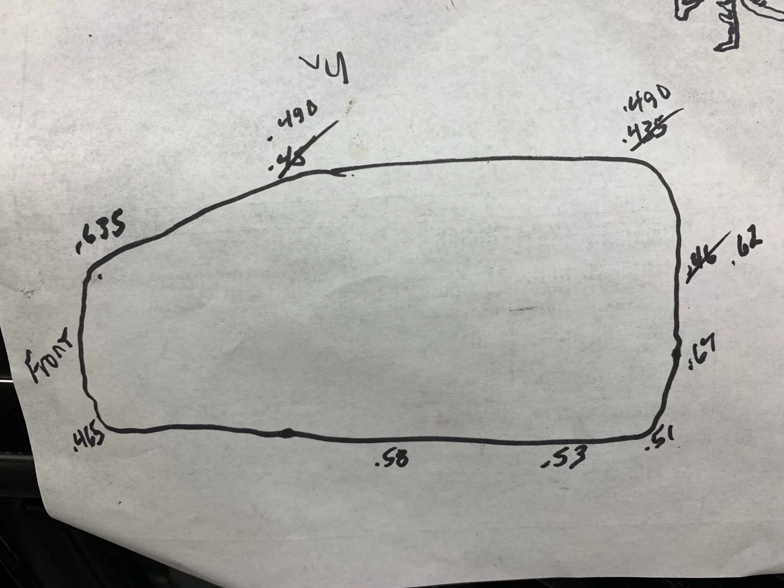

I'm having difficulty closing/latching my doors since I restored my Mustang about 8 years ago. Prior to this time, I don't recall issues with door closure. Closing the doors requires tremendous pressure. I have ripped the door arm rests off several times and friends can't open the door from the outside because the handles require so much effort to open. Recently, I replaced the door seals with no improvement. I noticed the upper door frame was rubbing the roof trim so I adjusted the hinges to eliminate this contact and obtained as even a gap as possible around the door. The door striker bolt is properly adjusted as the door aligns properly with the fender surfaces. I used Playdoh to measure the gap between door and seam weld lip all around the door with seal removed. It ranged from 0.44 to 0.67 inch (see sketch). I used a rubber mallet and piece of 2x4 to increase the minimum gaps to 0.49 inch. I removed the seat belt retractor button since it requires a substantial force to work. Would like some advice on what else to try. I even though about using a heat gun to reduce seal thickness.

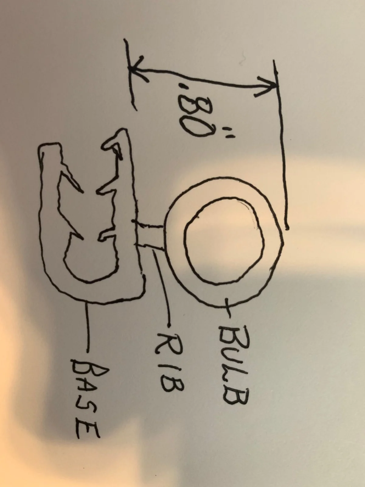

The door operates properly with the seal removed. Equal gaps all the way around. Door surface flush with fenders. Original seals were replaced in 2003 when problem began. This week I replaced the door seals again and doors still don't operate properly. After closer examination of the door seals I have, there is a 1/8 inch thick rib between the rubber bulb and base adding to the seal thickness. I'm going to look for a seal with a lower profile. If anyone with properly operating doors could measure the door seal height and let me know, this would be helpful. My door seals are about 0.80 inch above the base.

I've never seen a Ford seal with that "rib" in it. I put seals in my '84 from LMR and I couldn't be happier. Closes really nice with no force just like the factory ones.
