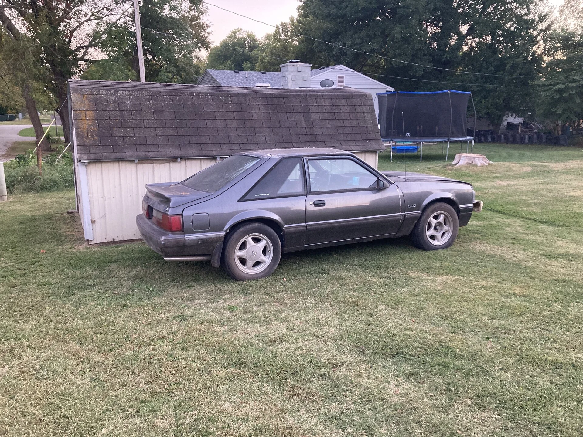

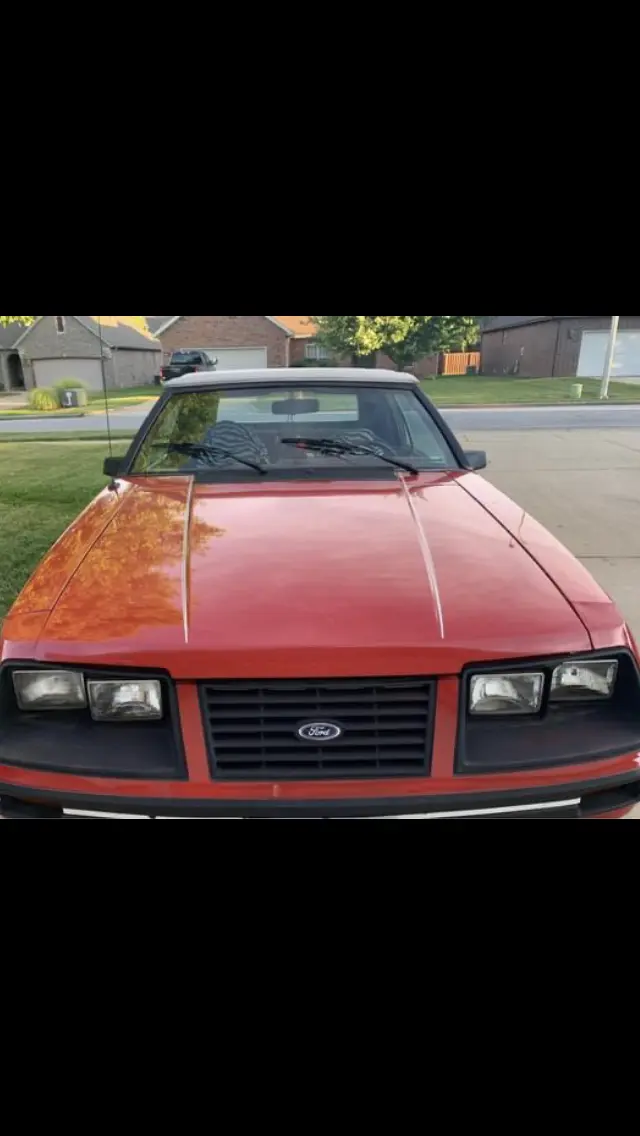

Ok guys I have been doing a lot of research and not really sure exactly what I should do or get to make the changes I want to make what I am trying to do is keep my original dash in my 83 but use the ecm and engine and harness from my wrecked 92 lx I have read that I can splice the newer harness into the old so that my gauges and stuff will work and I don’t wanna change my lights
