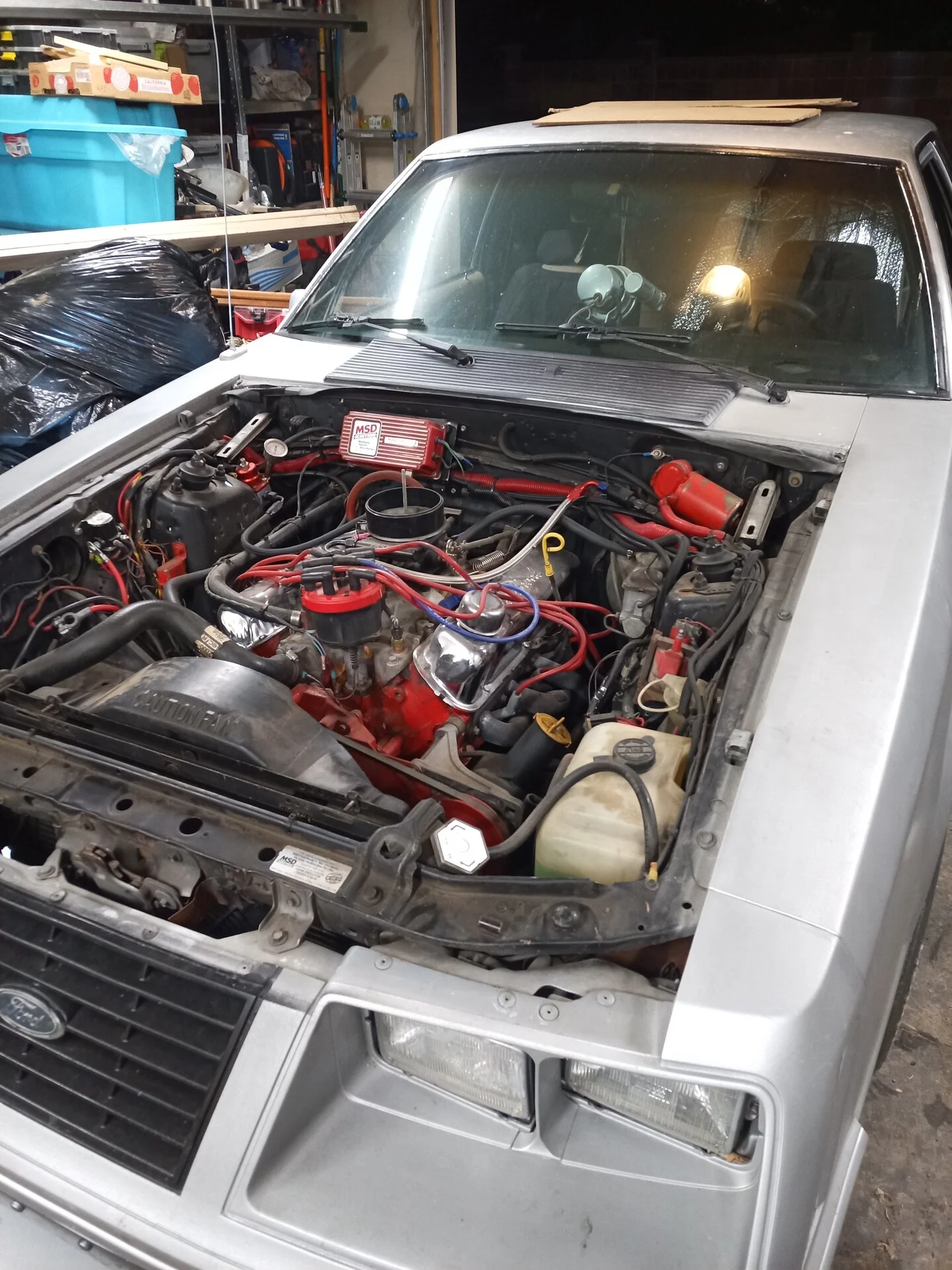

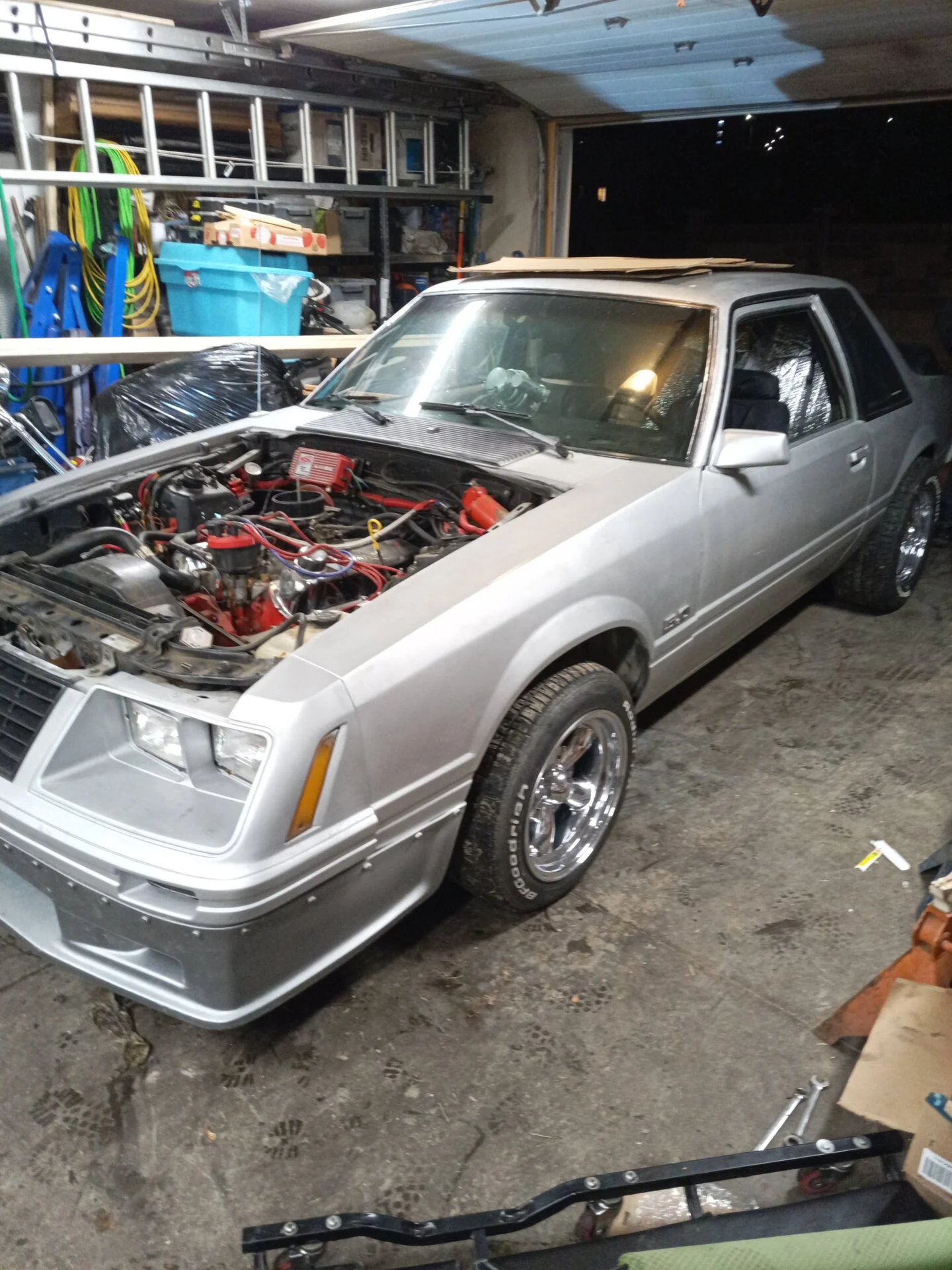

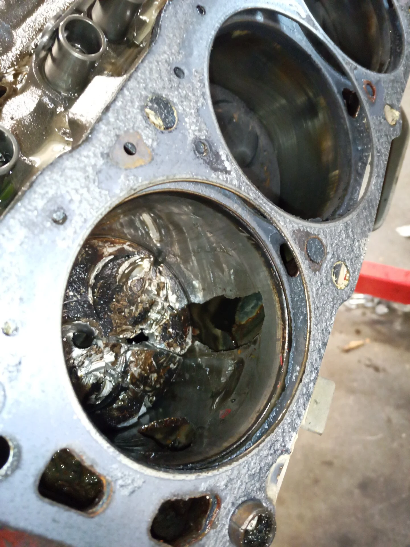

Here are some photos of the car before the swap! It had a 302 with a fast EFI system in it. The last picture is the reason for the 351w swap :p

Ouch!!! That engine has an issue with that hole, yes time for an update :nice:

I don't think I've ever seen a whole that big, there is one on the other side as well! When I bought the car the guy told me it had a " Spun Bearing " but I knew it needed an engine. So far I've only owned this car for about two weeks! I am off work in the winter months so I thought id try flipping some vehicles. I bought a jeep grand Cherokee for $500 and fixed it up and then I ended up trading straight across for this car... I think I did pretty good :D Not much of a backstory but looking forward to writing a few new chapters in the near future!
