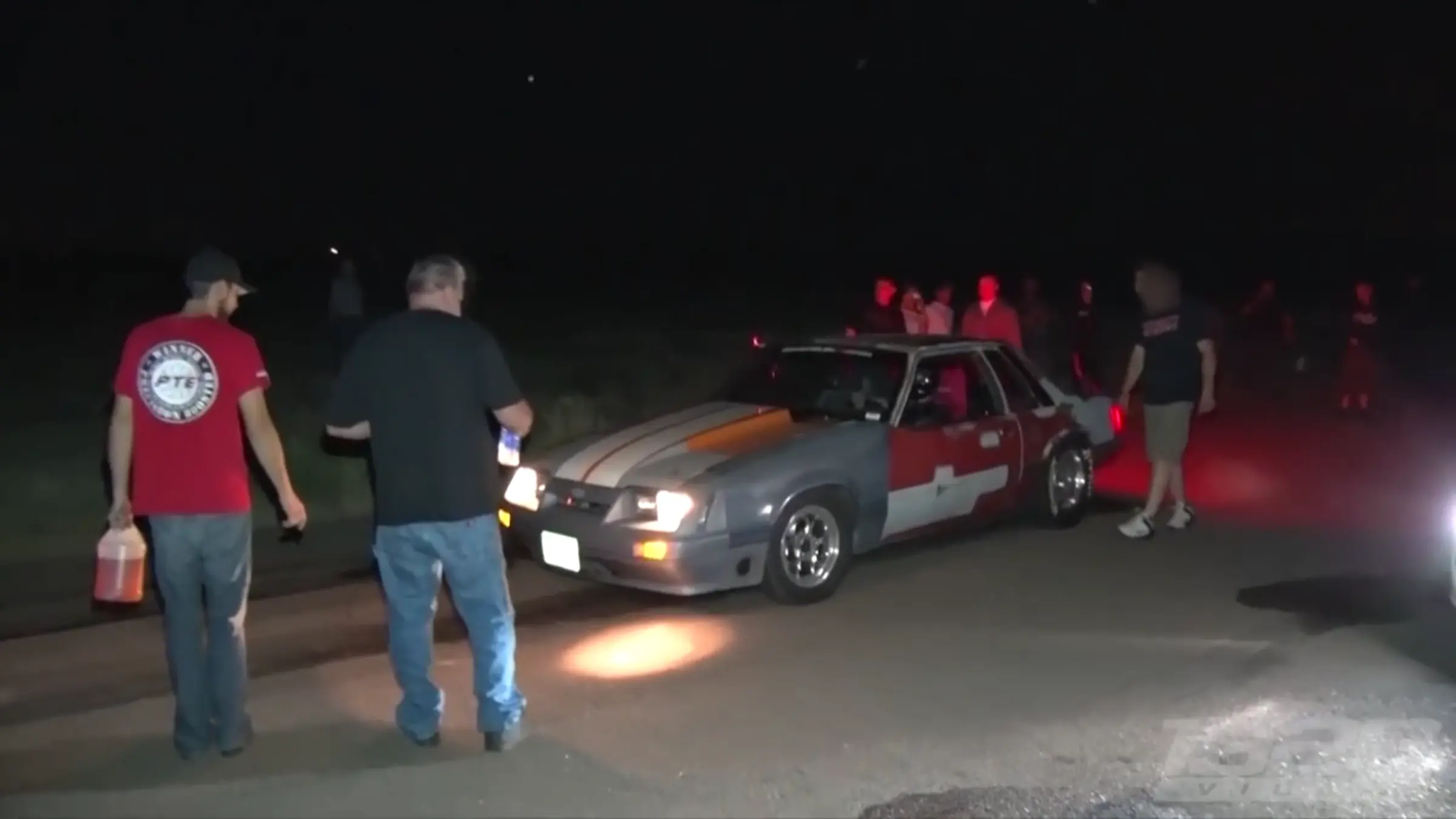

Thanks @Davedacarpainter
Btw it's a 351 nitrous car and many more colors than yours haha.

Very Sweet! My notch is an '83 with t-tops, so I would feel a little guilty doing any tubbing on it.
But, even with the mismatched paint, that is a nice ride!
Is that an '85 or an '86?

I'm not sure what year it is. I saw the car running Colorado cash days. I must day my favorite street guy is the beater bomb. Pisses off alot of expensive cars.
