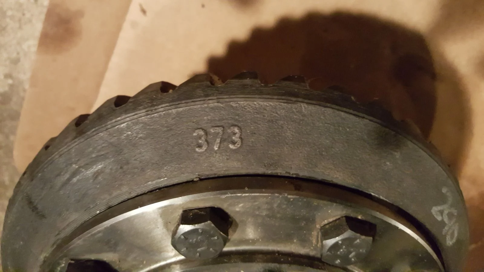

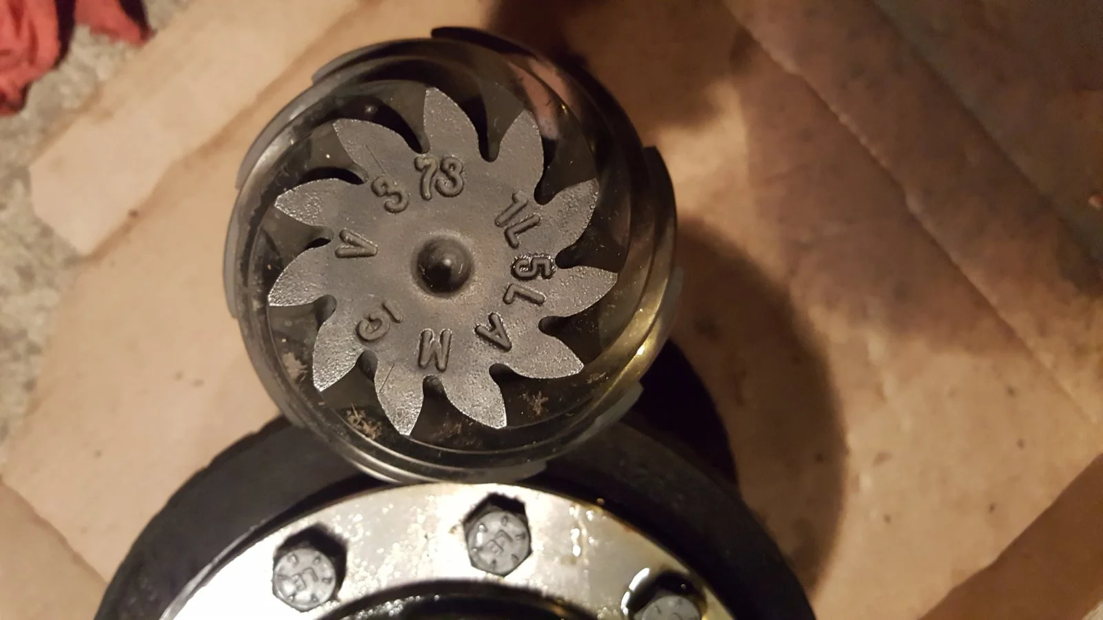

From what I've been able to figure out is that this car has a 7.5" rear end and by looking at it's shape being more round than oval, I believe confirms that. A friend of mine has the 373 gears but they are on an 8.8" Detroit Locker. He thinks that the gears will still fit in a 7.5" rear end. Does anyone have any insite on this situation.
Or if they wont fit, does anyone have the 7.5" gears and want to trade for the 8.8"?
I've been researching this weekend and haven't found and answer to whether or not these gears will fit, but that's interesting, this one has 10 bolts.

You cannot install 8.8 gears in a 7.5" axle.
Thanks mike, you've confirmed the two main things that I've been figuring out. And 8.8 gears in a 7.5 was a pretty obvious no, but I've seen stranger things. And that's my plan, get an 8.8 from a salvage yard, since I have all brand new guts, and take my time with it on a bench.
