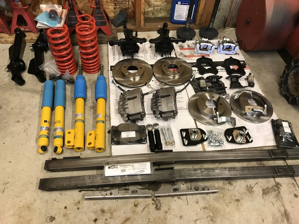

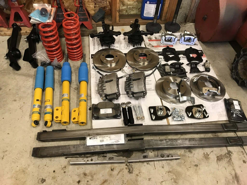

I went with the H&R race springs

They are Bilsteins. I have had other combos of springs and struts but in my experience the HR race spring and Bilstein combo is the conventional spring/struct winner. It firms it up but was never too harsh. This car is 100% street car with no real goals. I just want it to look good and stop/handle better than stock. Currently it is on stock worn out OEM suspension and (IMHO) nearly unsafe stock 4 eye brakes. I have the MM torque arm on the turbo car and it helped out a lot with traction and what I can best express as feeling "planted" in curves while under power.
I love all the MM parts but in reality I use them to maybe 5% of potential so I am trying to spend wiser on this T top car. I want this car to be a real world driver that does what it needs to better than most.

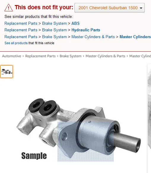

I found the Cobra master cylinder on Amazon for $56 bucks!
Amazon product ASIN B00169FZDGView: https://www.amazon.com/gp/product/B00169FZDG/ref=od_aui_detailpages00?ie=UTF8&psc=1
I could've given you that for free. I have one with a leaky reservoir that I got from LMR

That picture is just a sample if you search the PN it is complete ( well i believe it to be )
