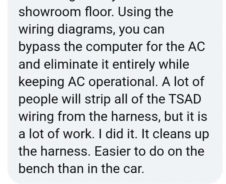

From Facebook post by Randy Nicholson
For a 1985 factory carbureted car, that computer is the TSAD module which does essentially nothing. The AC runs through it, so if you bypass the module, you would have to wire the AC wiring around it. It was for the Two Speed Accessory Drive which was never actually a working system. EFI car is a different story.

Check out this post on Facebook, Randy Nicholson gives some detail about the TSAD module and its purpose.
Interesting read.... He said something about rewiring around it in his reply.

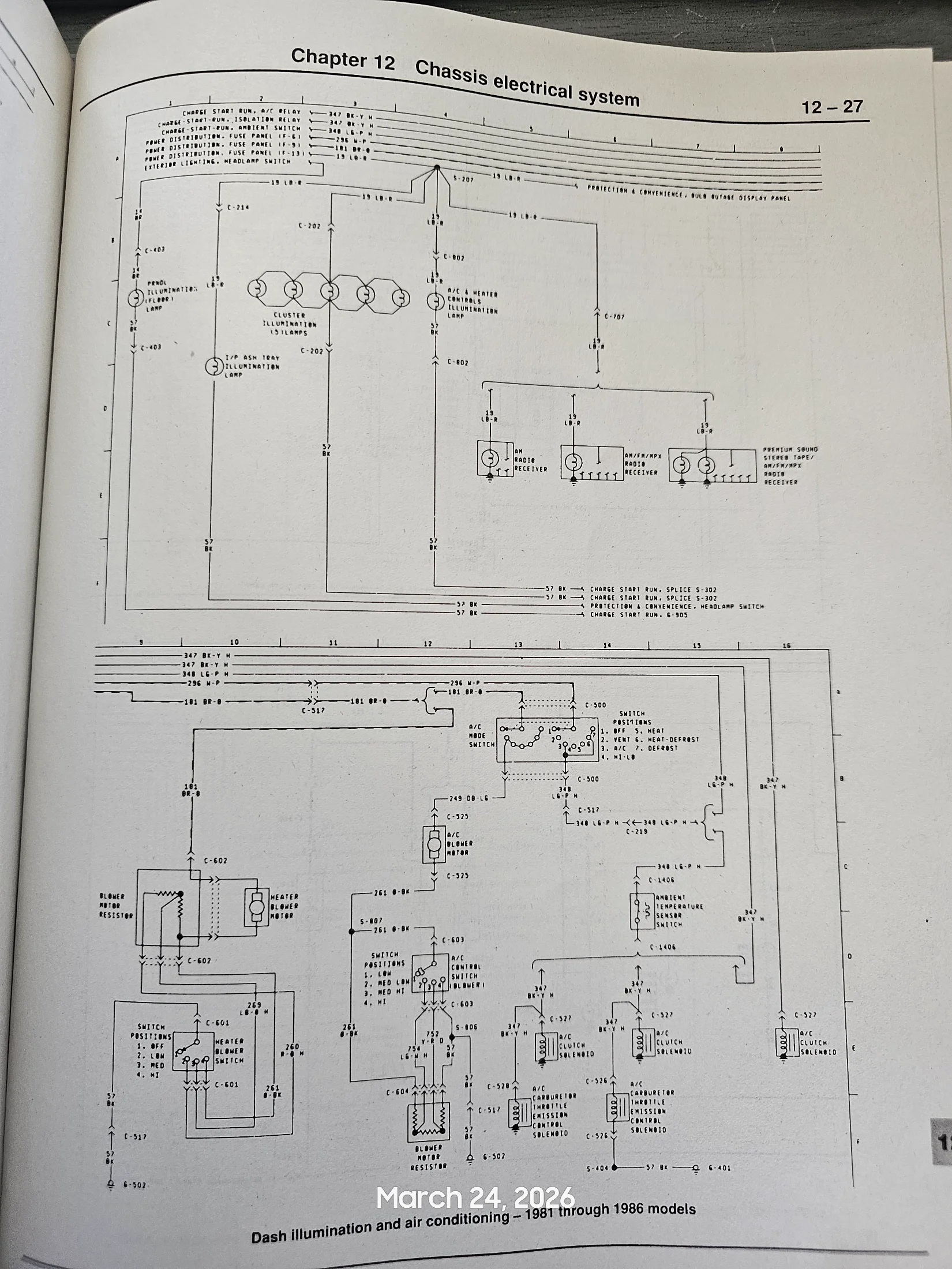

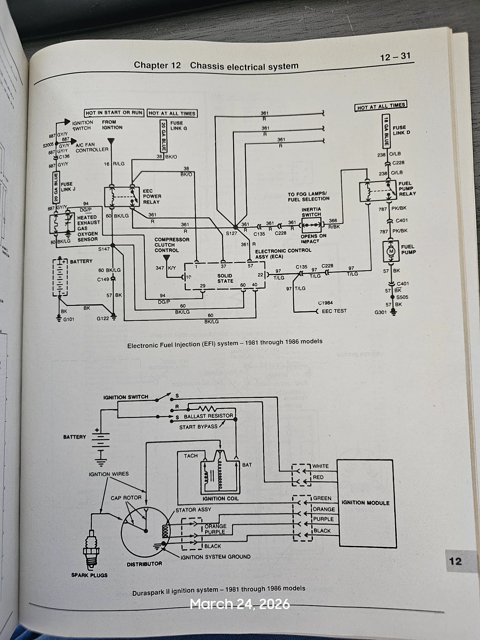

Dug out my Haynes manual, here are a couple pics that I know include the AC system. I didn't spend a lot of time nor did I scour the pages, so there may be more than this.

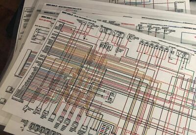

The Haynes manual could be beneficial for you, but I think the Prospero diagrams are a lot easier to read. They're larger and color coded. I've not traced any of them to know if there is something wrong with them, but I think they would be a great addition to anyone's tool arsenal.
Or, you can find them on Ebay (which is where a lot of us have found them to begin with).
I have the Ford electrical diagrams.. though those Haynes ones look fairly simple, if they're complete and accurate. I'll study the factory diagram and see if I need to get the Haynes or Prospero's, thanks very much for the info! I have located the Unicorn 1985 5.0 carburetor wiring harness in a wrecking yard, waiting for them to pull it from the vehicle, so may not have to modify it at all (fingers crossed!).

Figured it out. The v6/efi harness has an A/C pressure switch on the dryer, which interfaces with a full throttle cutout relay and the ECU. Fairly simple to remove most of that and have the switch pass power to the A/C clutch (didnt retain the full throttle cutout relay since we didnt install a switch to detect full throttle).
