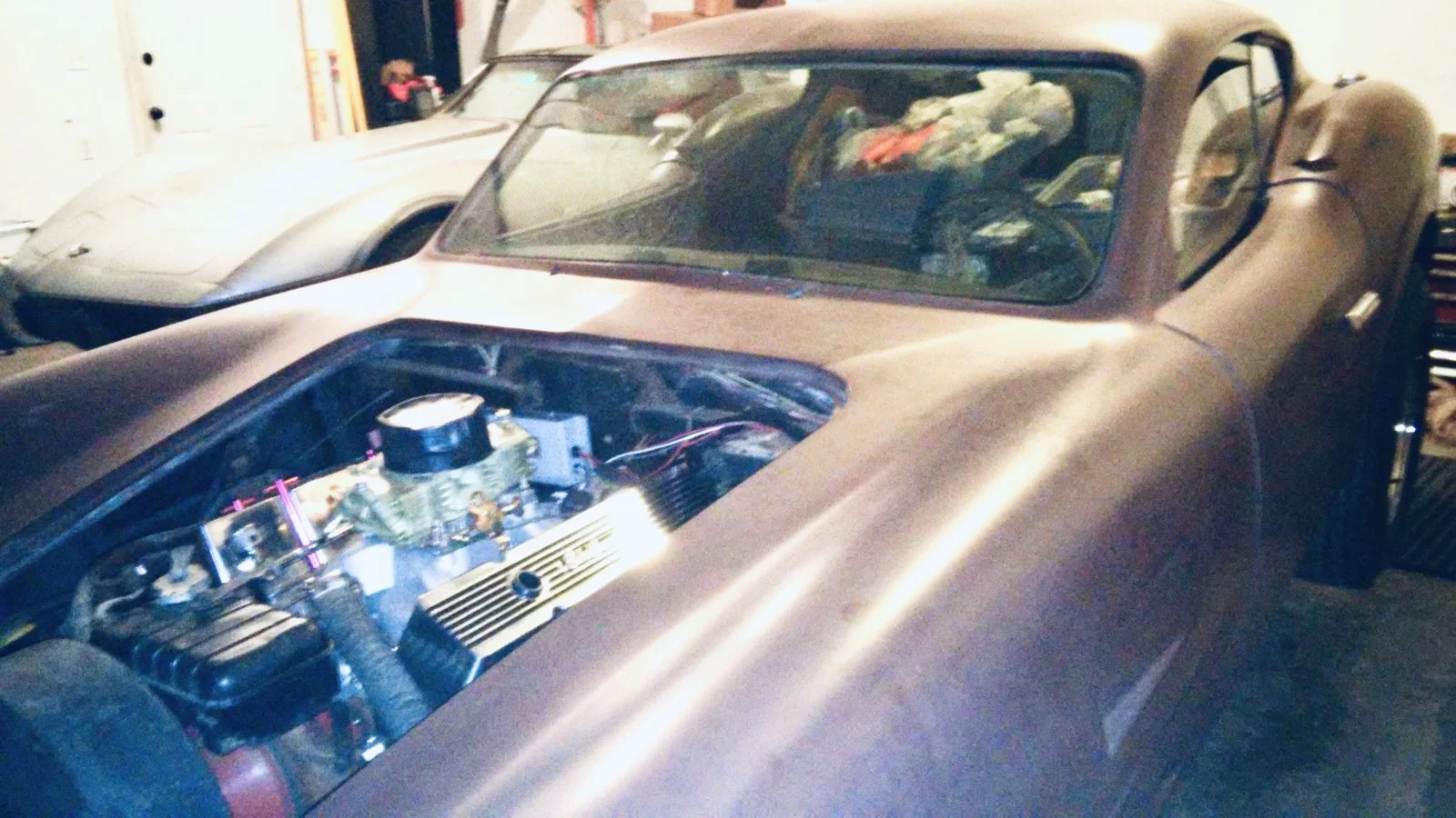

Hi, Pic’s promised I’d post a pic of my 67’ Kitcar. Kellison Astra X-300;-GT, Project, (recognize the Car?). built with 68’ Corvette L-79 327, M-22, 3.73’s, curb weight of 2,100, My 64’ GTO, ran a 63’ SD421- put the 4$&!500-550HP More does it need, ? lol

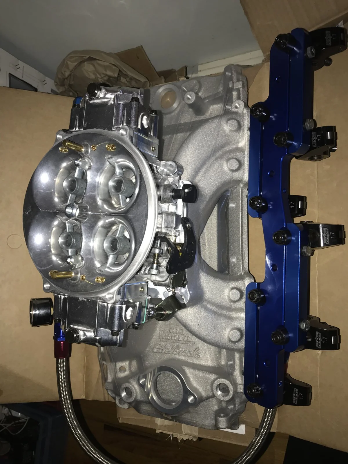

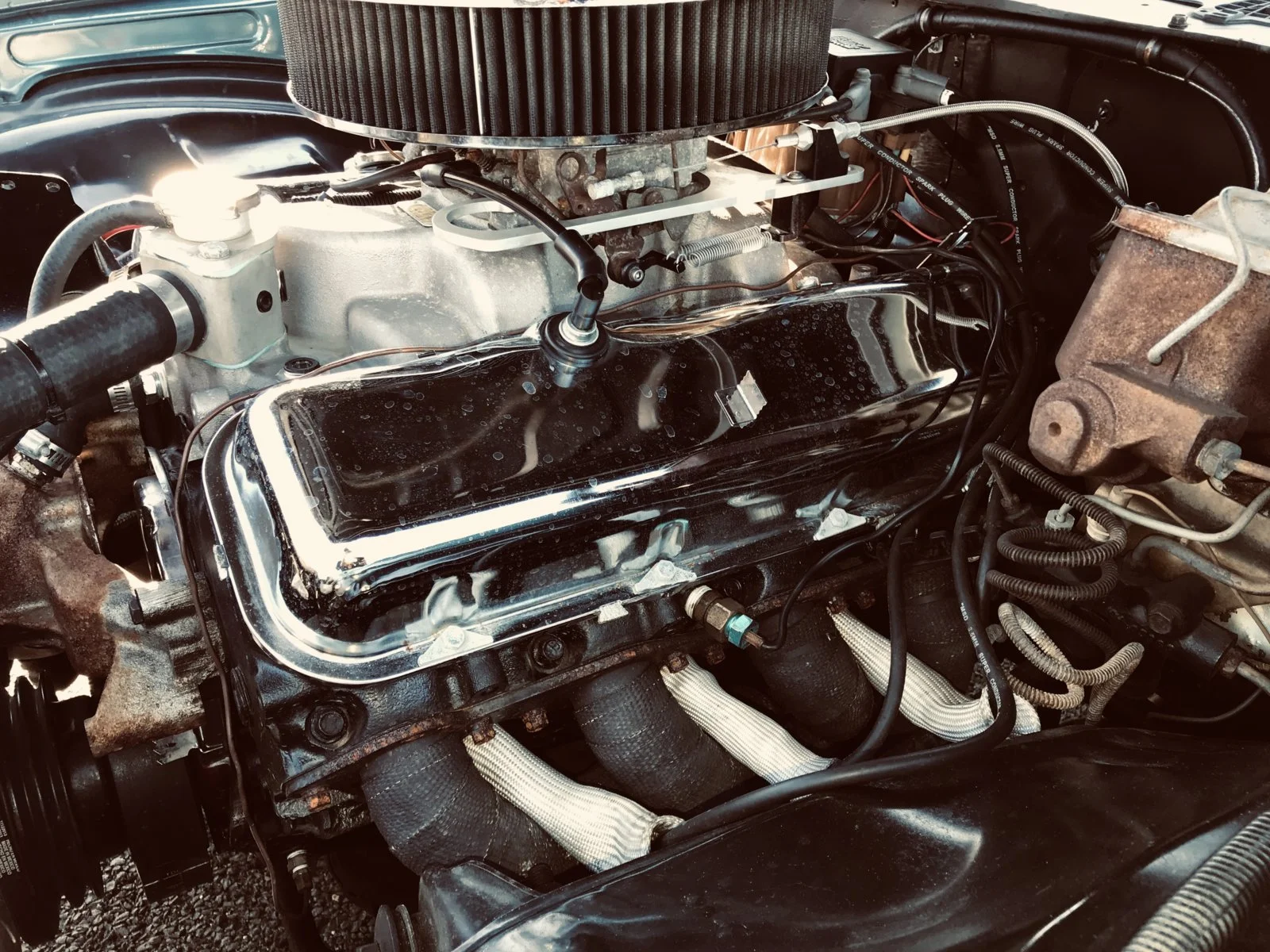

79’ Z-28, Roller 532, M-22, 3.73’s, came with a 70’ Chevrolet LS-6 , stored it, built an aftermarket 4 Bolt Block, 1150 Dominator waiting until the rings are seated. 5 pics per post, I’ll add the extra’s in 1 more.-John

Astra’s interior has the best gauges SW gauges in 1970, going to keep it retro, donor Corvette had original Sidepipes, want sidepipes on this Car, May use the Vette’ VIN # keep the 454 Vette for parts only. If sidepipes were stock, you can legally run them. Just Feels wrong not to restore the Vette, too. Play it by ear...
My 96’, EVERYTHING IS ILLEGAL IN MASSACHUSETTS!
All I have left from my 64’ GTO, I know- “Flamejjob on a 64’ GTO?”, try talking a tunnel visioned 17yr old out of that. Kept the OE 389 $ 3Spd Trans., somebody will come knocking for it one of these days, lol.
Interior of the Astra, all SW Gauges of the period, body came in one piece, my Uncle started it in 68’ schedule was too tight, he wrapped it up and put it on a pad. So I’m restoring and building simultaneously.He sold it to me for 3K, what it cost him in Parts. In the 60’s:70’s. All the parts came from 1940’s-1960’s Cars. Would have been super expensive to acquire them now, replica’s just as expensive, have everything I need- resculpted the body a bit, narrowed the 9”
rear, body ready for final sanding after I add flush mount door handles from a donor Corvette I’d picked up, cheap.
Have to finish it so he can drive it, he’s 76, Aunt 77’, All he ever wanted is to take her on a cruise night, I’m going to make that happen. He was building it for her, wanted it to be a 10th Annoversary present.
