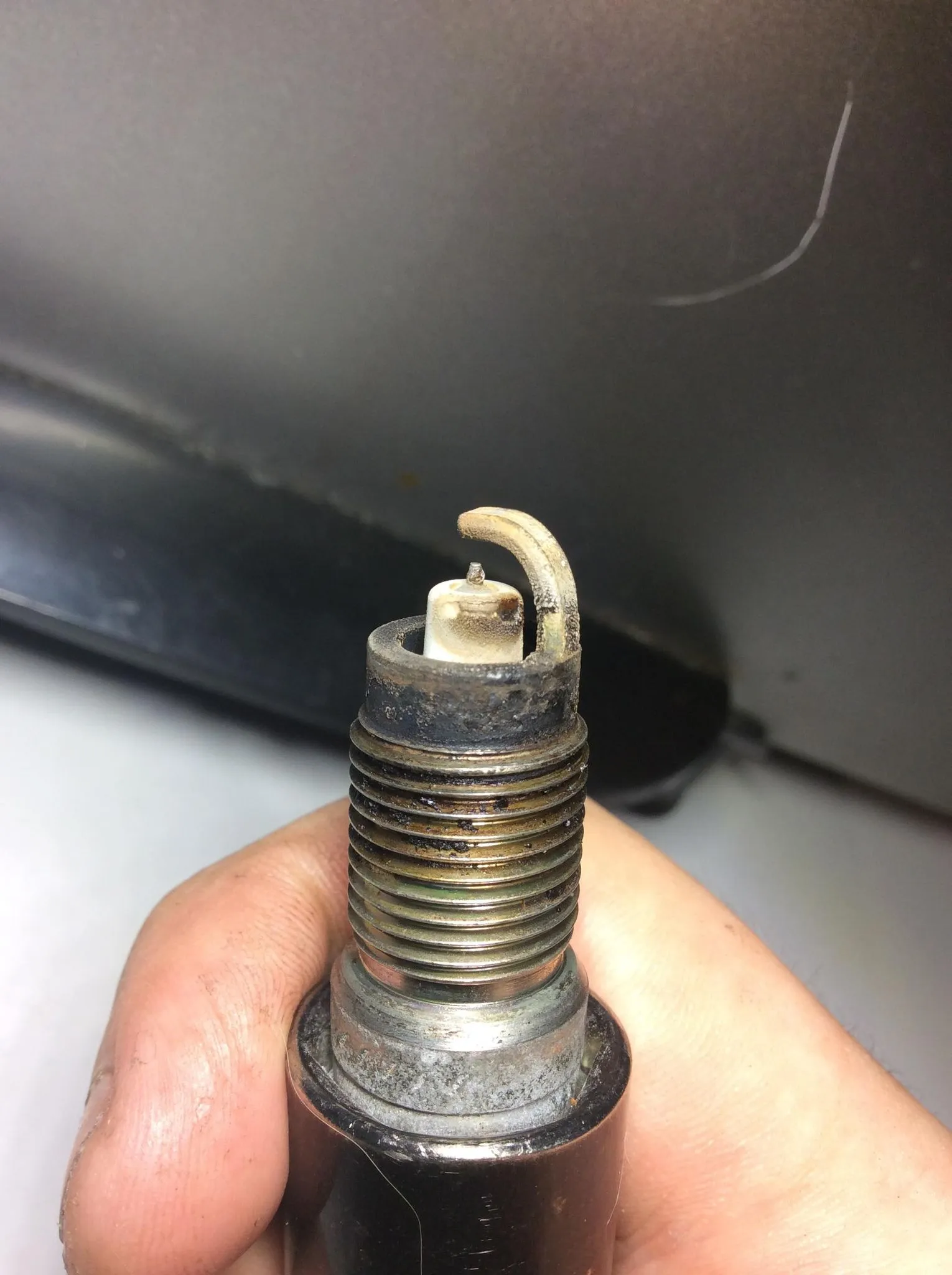

That's an idea. Run the engine tonight once it gets dark and see if there's any arcing.
The cylinder balance test never lies.
It's time to feed this engine a new set of spark plugs.
Good idea boss, but let's take this a step or two farther.
First the plugs, get some regular copper cheap azz plugs, don't need those high dollar irrideum gold plated V stuff.
the only code I would be concerned with is the canister inop code (31?), is the purge valve and related stuff hooked up?

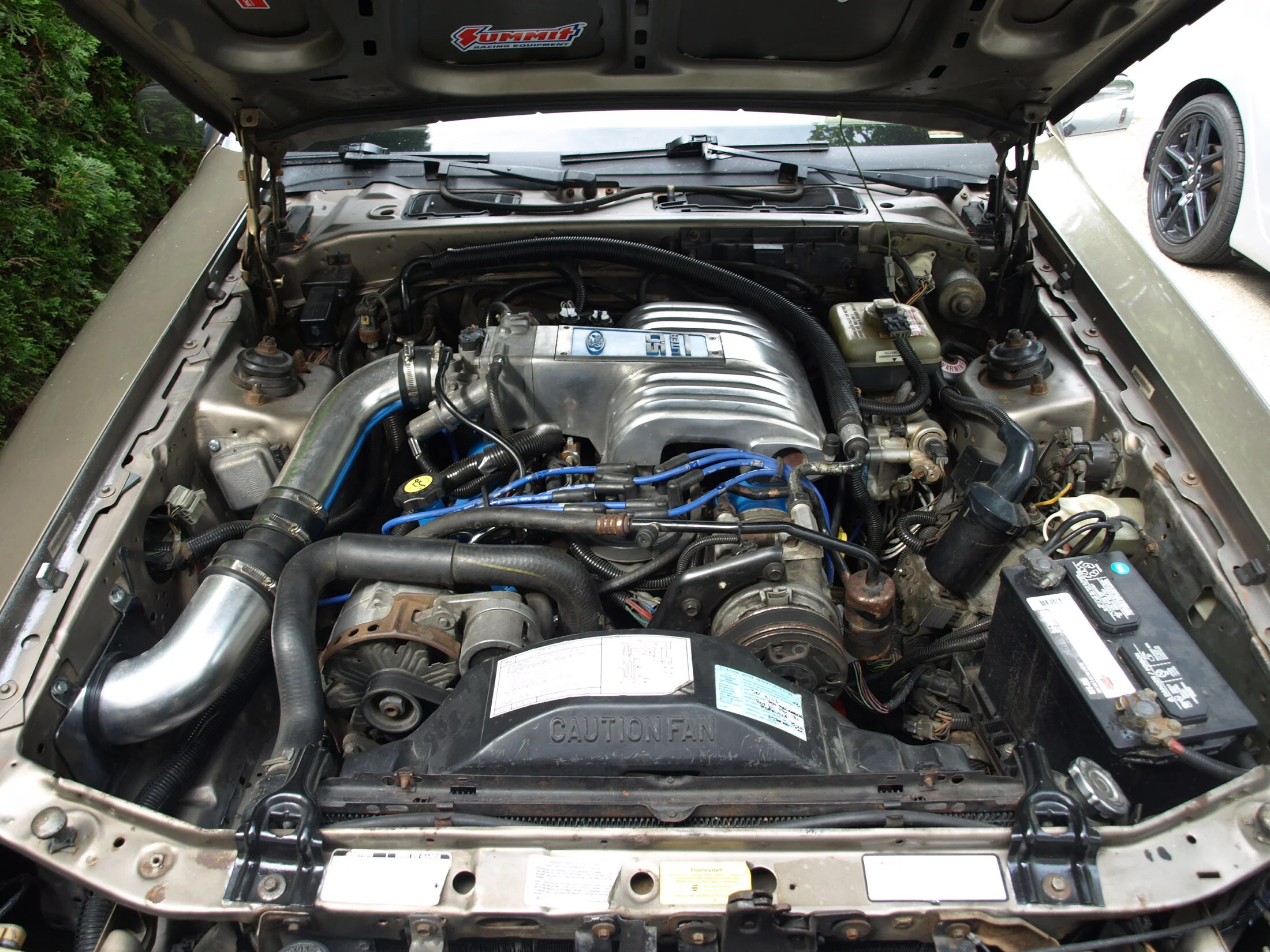

That plug is burned [lean].
You need to be hunting around for a vacuum leak someplace. Hoses, gaskets, inlet tubing etc...
You said this is an 86 so am I right that it has no Mass Air Sensor?
Toss up a clear image of your engine bay when you have the chance.

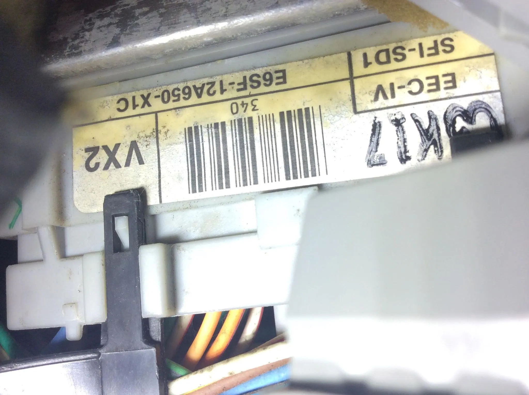

Yeah, I'm not 100% clear on what's going on. Along with the engine bay image, a pic of the EEC would be good too.
Here is a picture of my engine bay (Please ignore the dumb cold air intake. I'm putting that factory box back in as soon as I have to take out the other one for cleaning)
