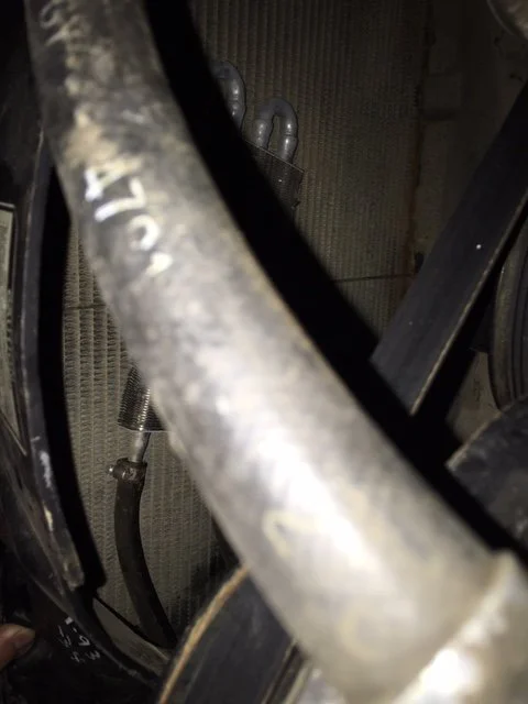

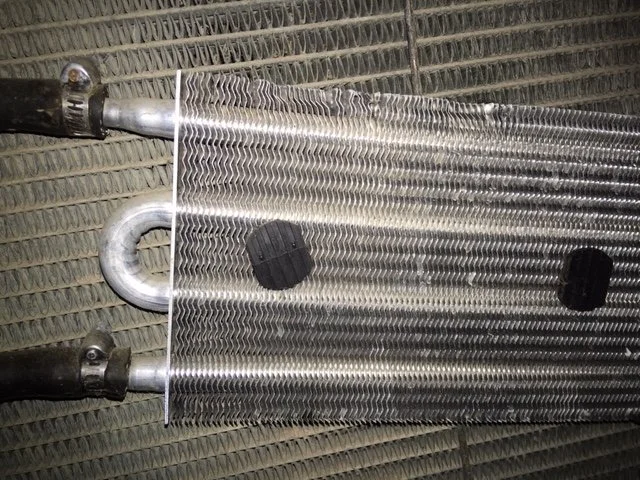

also, dumb question but learning, there are three 'radiators' on this car, the one in the front looks to be AC, the second the main coolant, the third has small lines coming in and is either oil or transmission but I don't see how the smaller radiator (one right by fan that I am guessing is oil) mounts to the main radiator. if I replace the radiator, do I need a special kind of radiator to deal with the small radiator? I see two black things on the smaller radiator that look like they may be mounts but I have not gotten the radiator out yet. I think if I take those small lines off, it will let the smaller and the main radiator out but then I think it will dump whatever fluid all over so was holding off on that. thoughts?
A picture would be helpful. That sounds like an aftermarket cooler ( the little one ).

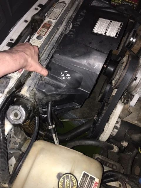

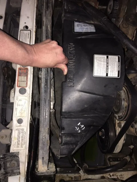

pics as good as I could get. thanks for help
That's an aftermarket transmission cooler. To release it from the radiator the plastic mounting thingies will need to be cut. Usually, not much fluid comes out when those lines are disconnected....just enough to make a mess.
Standard radiator will do. Most new radiators come with the fittings for the transmission cooler built into them. That radiator looks like it was made for a manual transmission car.... on an automatic radiator there are two fittings facing the engine between the radiator cap and the lower radiator hose.
I noticed that the overflow bottle hose is disconnected in the other picture. I'm sure you know it goes to the nipple below the cap.

yes, I have it unhooked to pull it out but stopped when I found the extra cooler. good tip.
