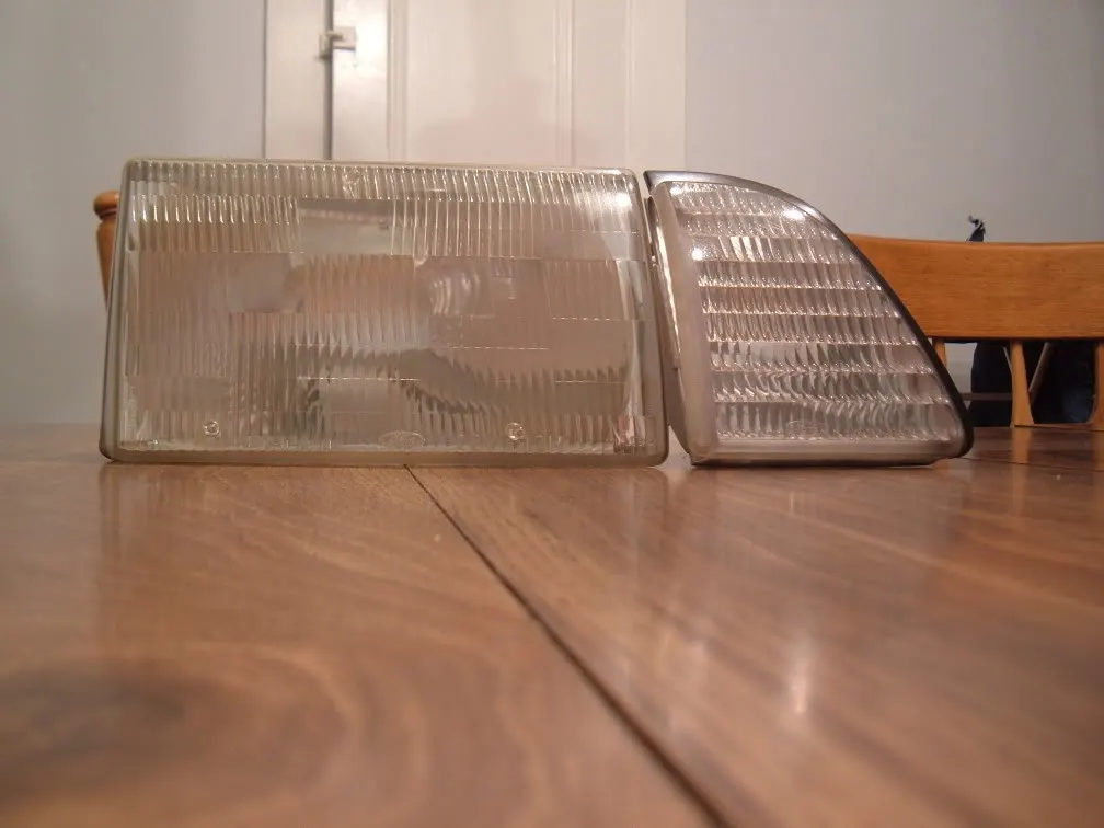

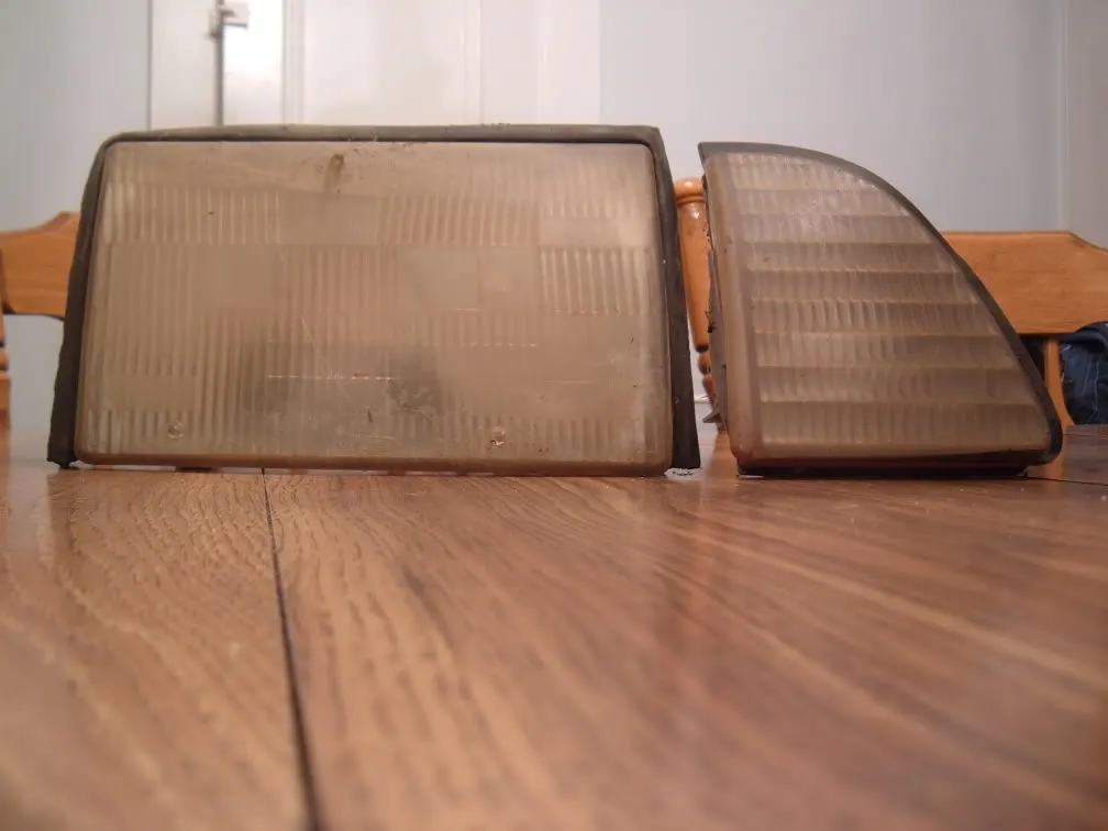

Process:
All products are from Poorboys World
Washed with Super Slick and Suds
SSR 2.5 with white VC pad, via pc at speed 6 x 2
SSR 1 with red VC pad, via pc at speed 5
Pro Polish by hand
Did not wetsand! I let the products do all the work.
Detailed by Reflection Perfection
