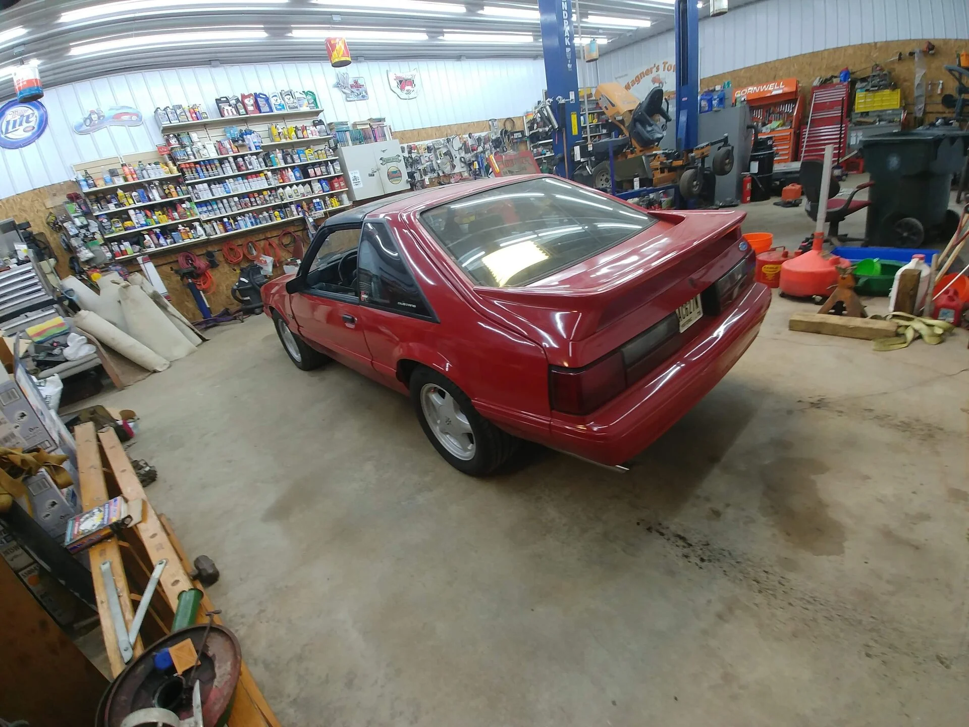

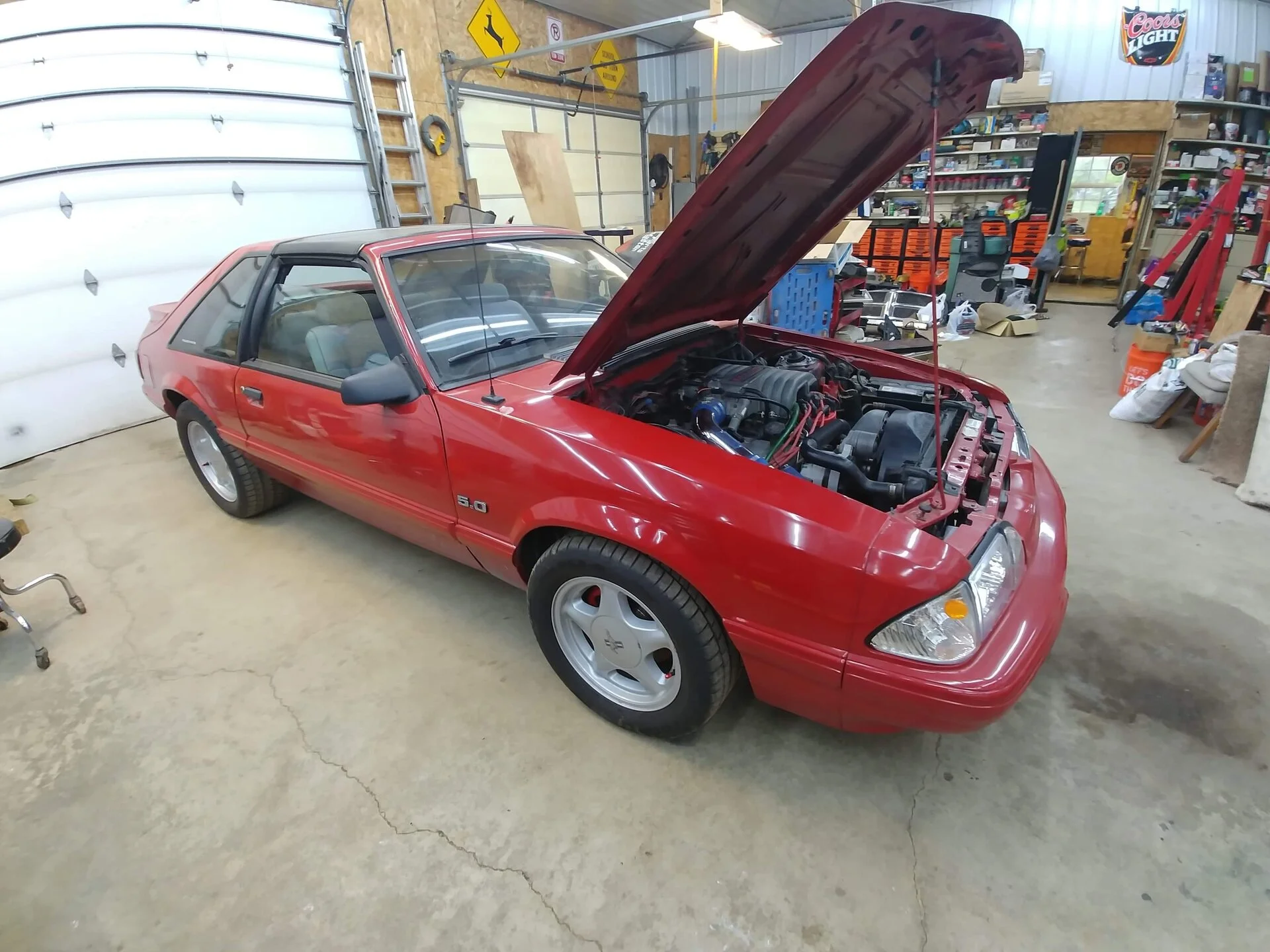

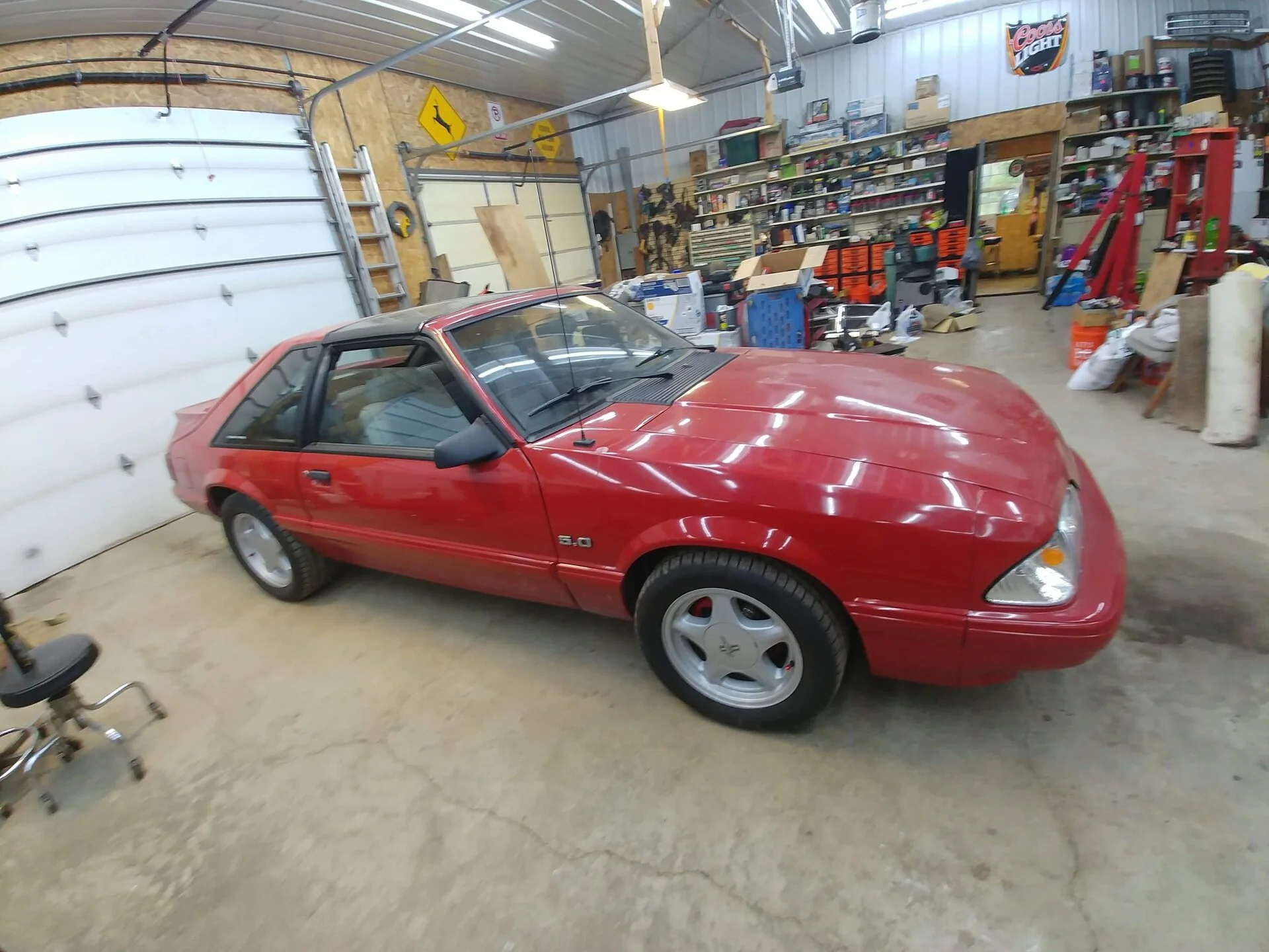

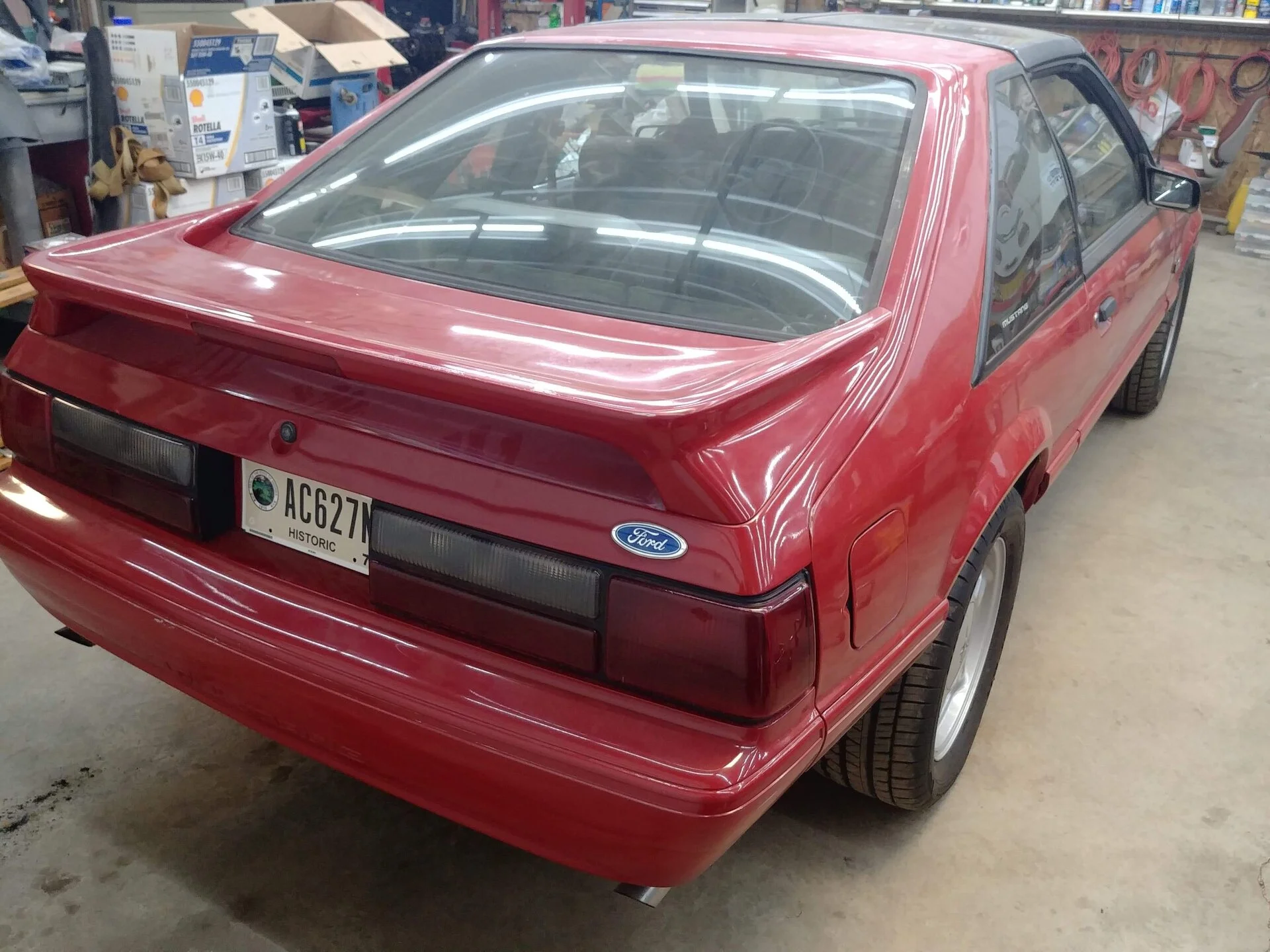

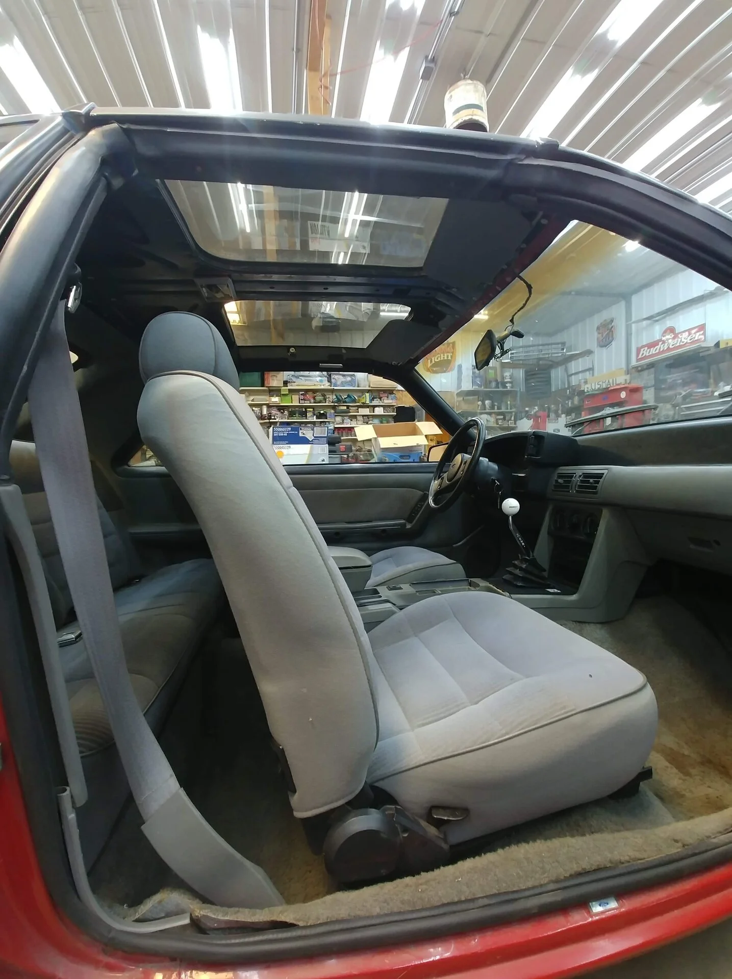

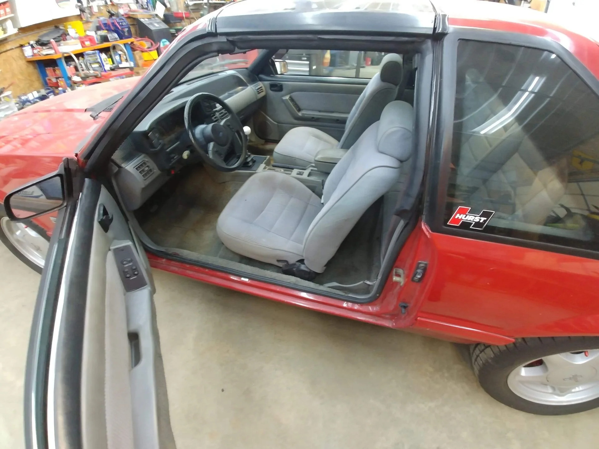

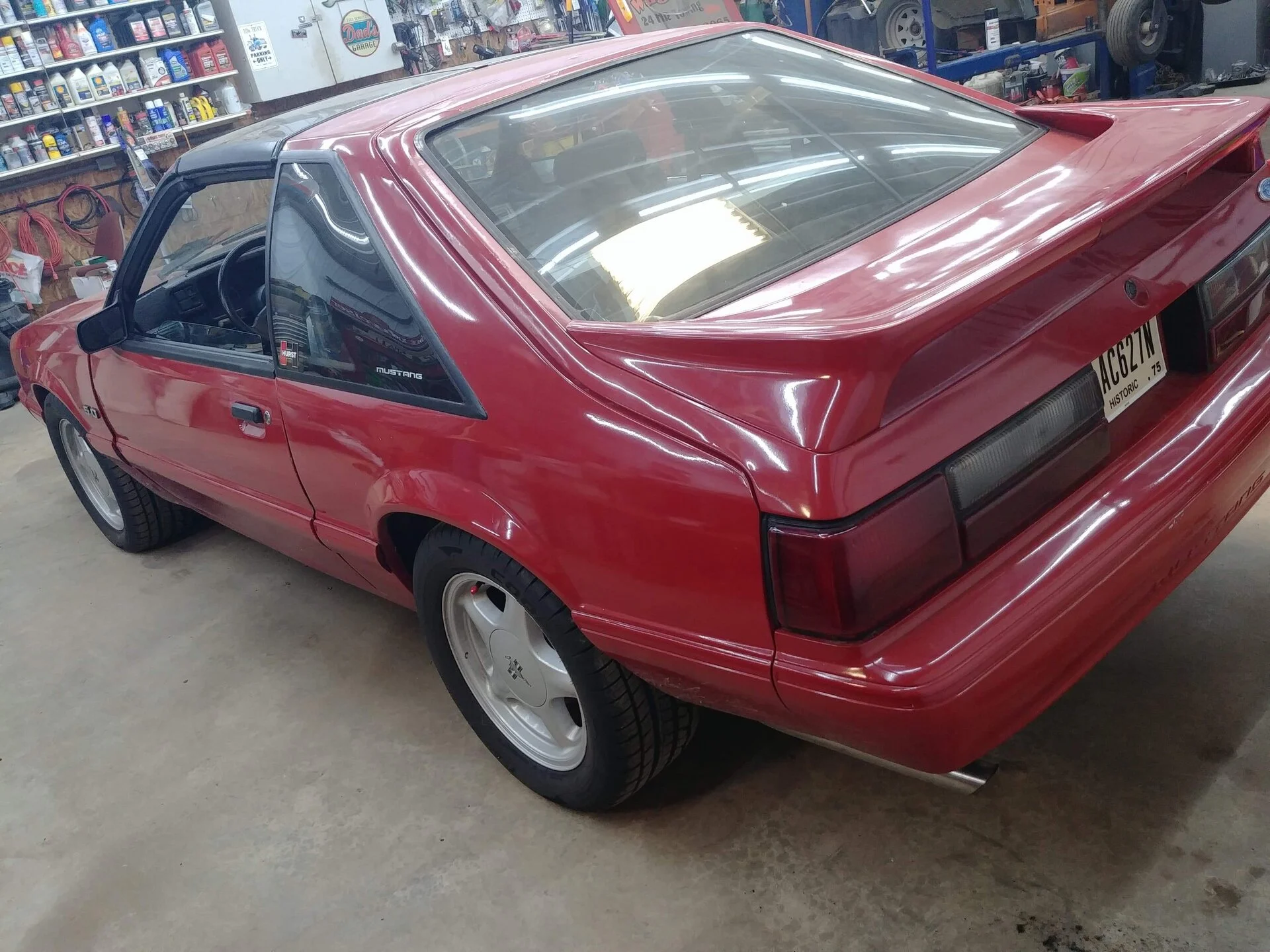

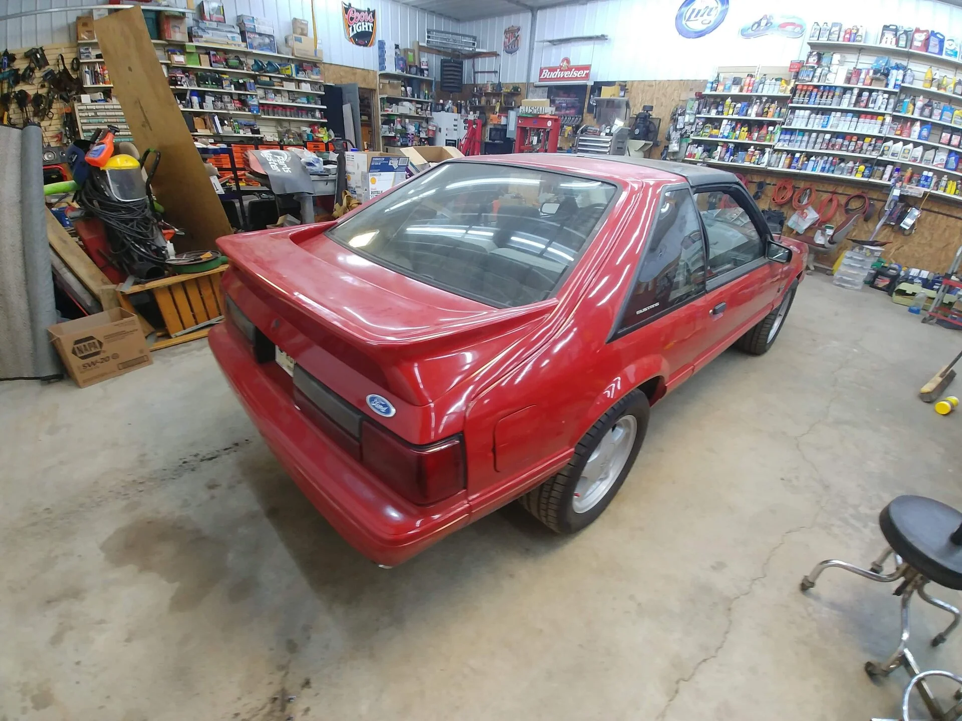

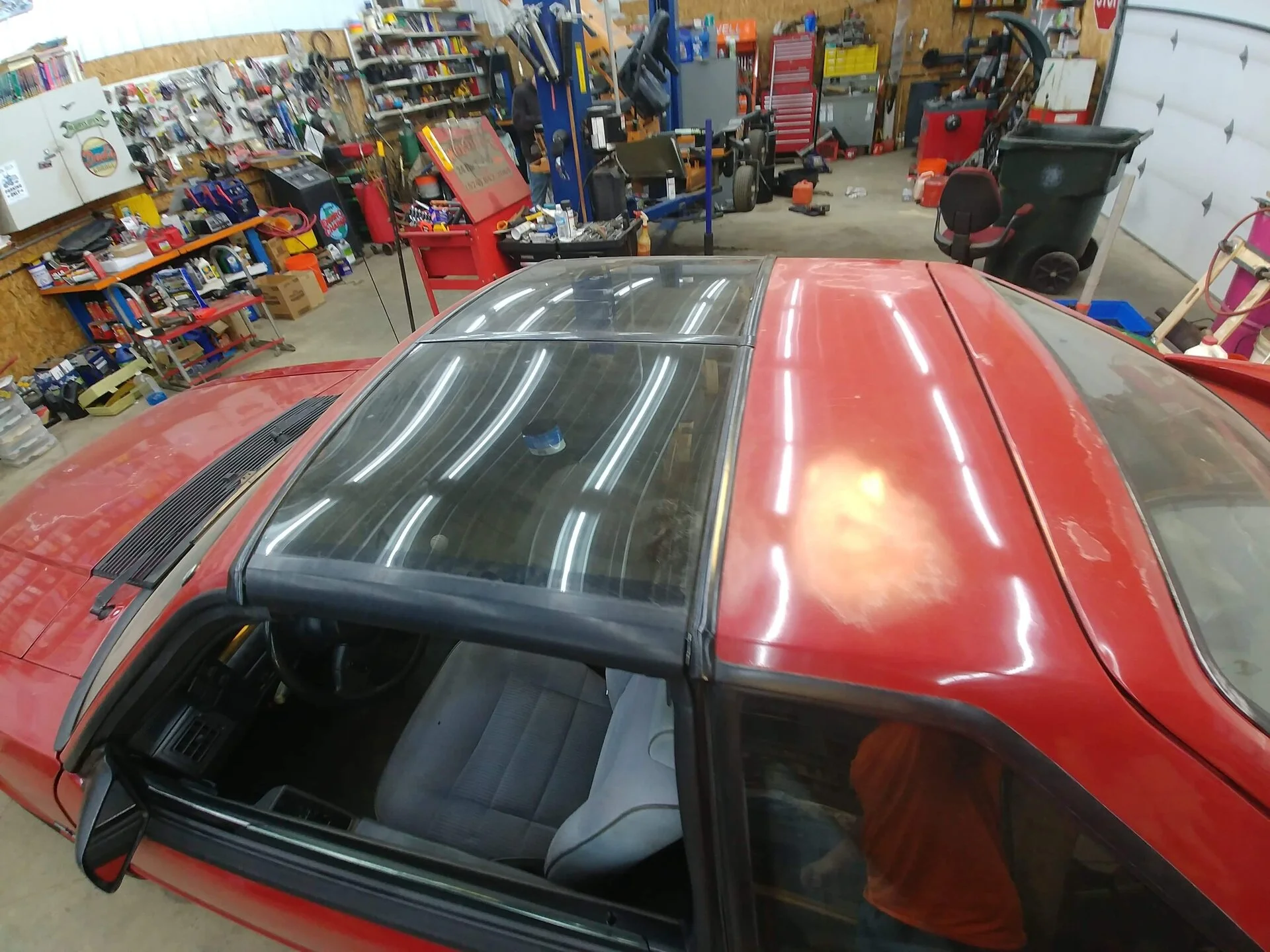

Hi all I found a pretty clean 1987 LX hatchback T-top for sale has 149k miles on it I don’t see any rust. It is all original wheels and all only thing that’s been done is a cold air intake nothing else. It’s got newer brakes and tires all round. Everything works as should.
Said I can grab it for $6,000 as he has it up for 7k. It has some clear coat peeling, don’t see any body damage. Noticed no headliner.

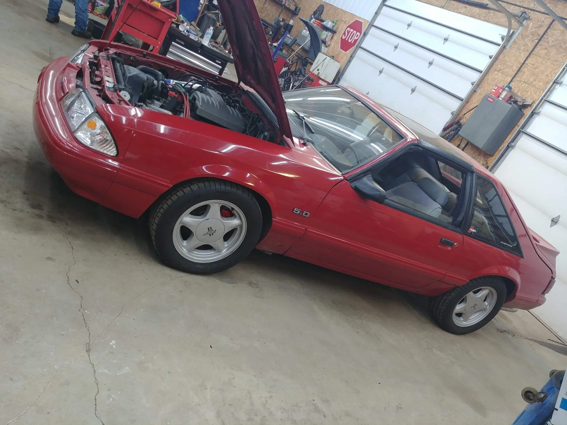

It says it has a rebuilt title he said it always said that on there. It does almost look like the front bumper & hood are a different shade of red compared to the fenders. like it’s a faded red off a different car that had more time under the sun. Could be lighting idk.

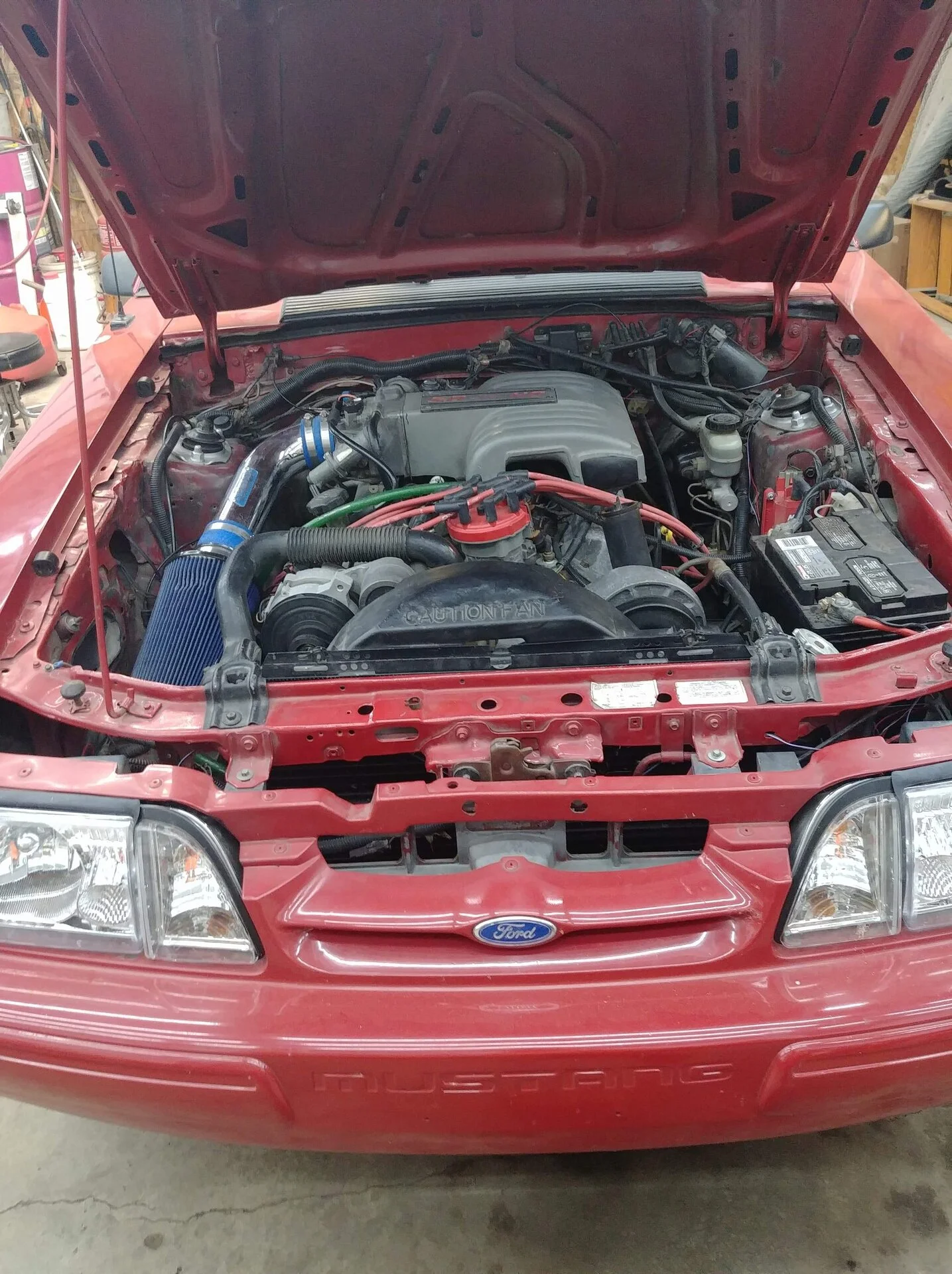

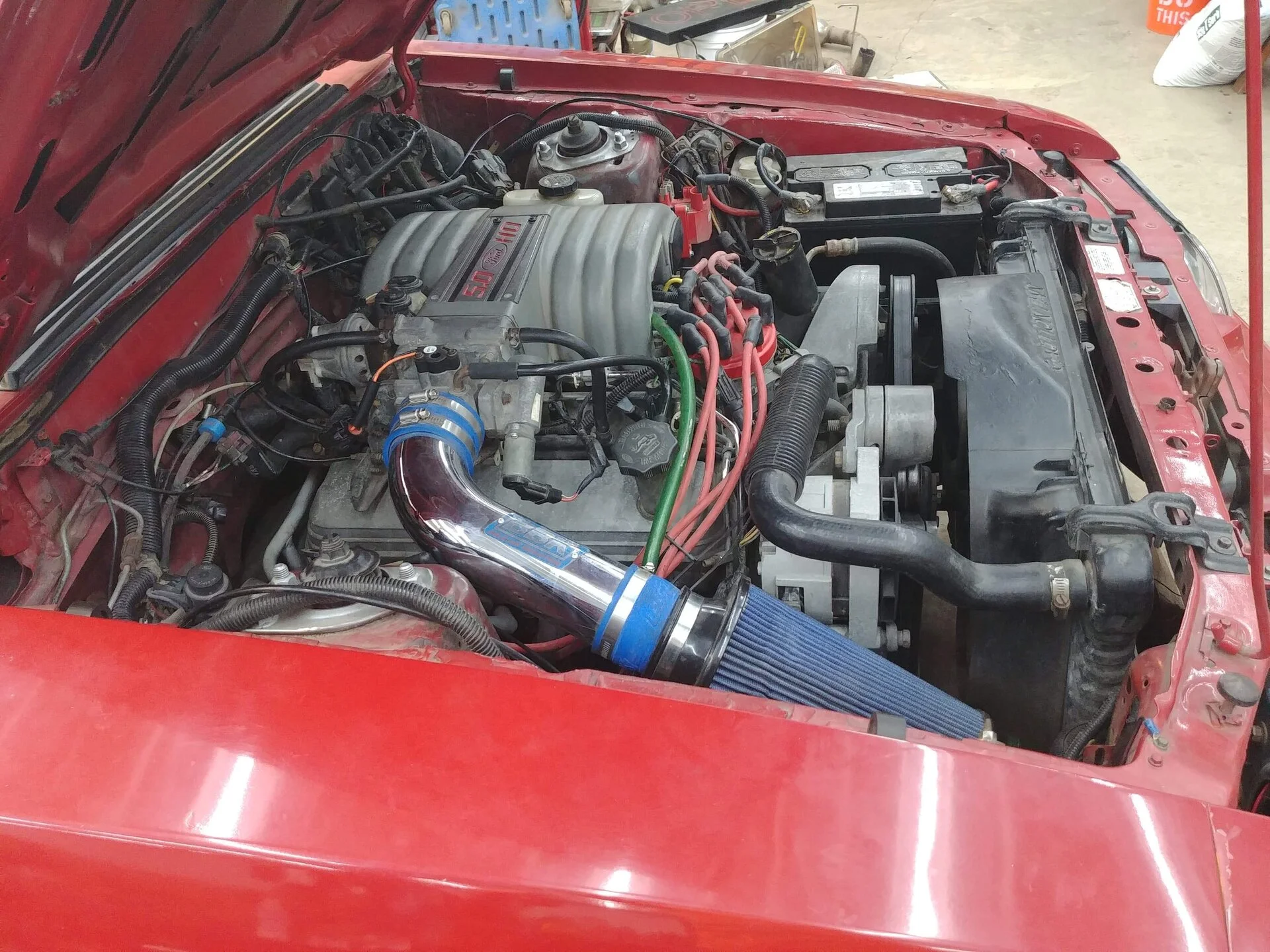

Also if you look at the last picture in this post a front view of the engine with the hood open on the passenger side it appears to have a Gap and a bolt missing in the middle on the passenger side where the fender bolts down & further up does it look crunched a little? or is it just me?
What do you guys think about the title being rebuilt?

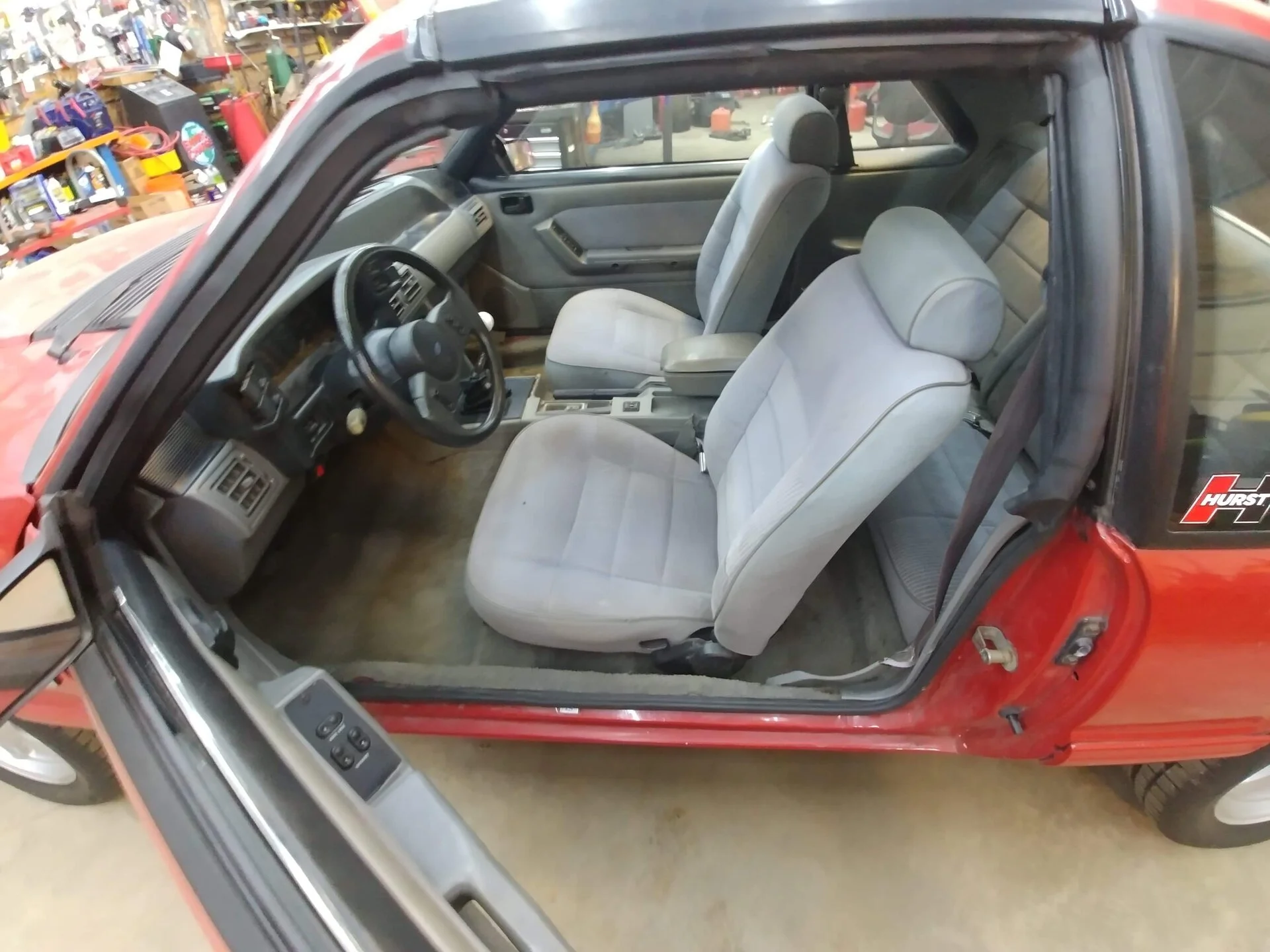

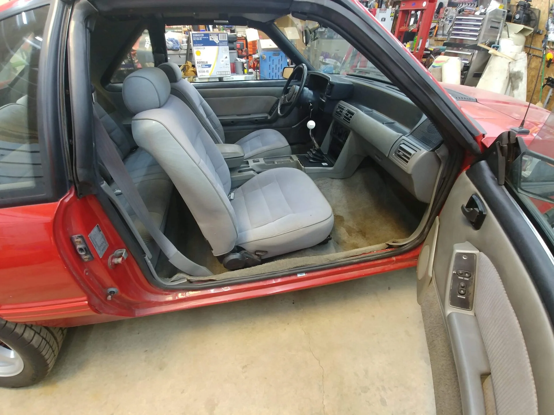

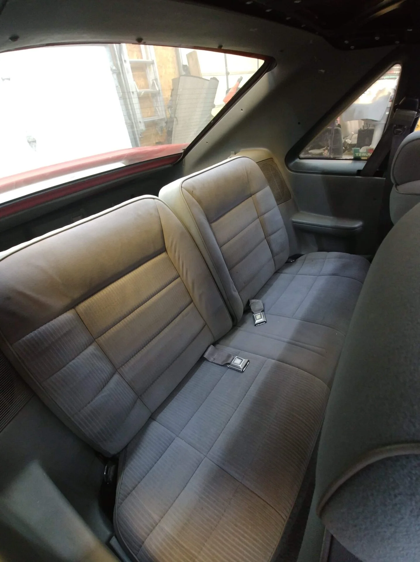

He doesn’t drive it in the rain and said he can’t remember if it leaked in the car wash. I looked at the seats see no stains to see water damage. And see no signs of water up by the t top areas. He is selling it cause he doesn’t use it and it sits cause he’s in college.
I have not seen it in person yet he’s two hours away. I just zoomed in on the photos.
question is. Is it worth buying I heard all these T-tops leak searching on the internet and see replacement glass is expensive and hard to get if anything happened. Also reading doors are the same as a Convertible how ever the glass is 2 inches shorter & you cant buy door glass for a T-Top. I know the T-Tops are very rare to find.
My plans are to maybe put a top end kit on it and get around 350-400 crank horsepower on it. I know t-top is weaker so would need sub-frame connectors to stiffen it up.
I am looking for a fox I miss mine I sold 12 years ago when I was 21. I had a clean 90 lx notch and a clean 90 GT hatch I was stupid & sold.
What are your thoughts?
Pass side inner apron is definitely mangled up. Looks like before and after the shock tower. My guess is that’s the reason for the rebuilt title. It’s obviously been repainted as well. Who knows what other danage would be there if the nose was pulled off.

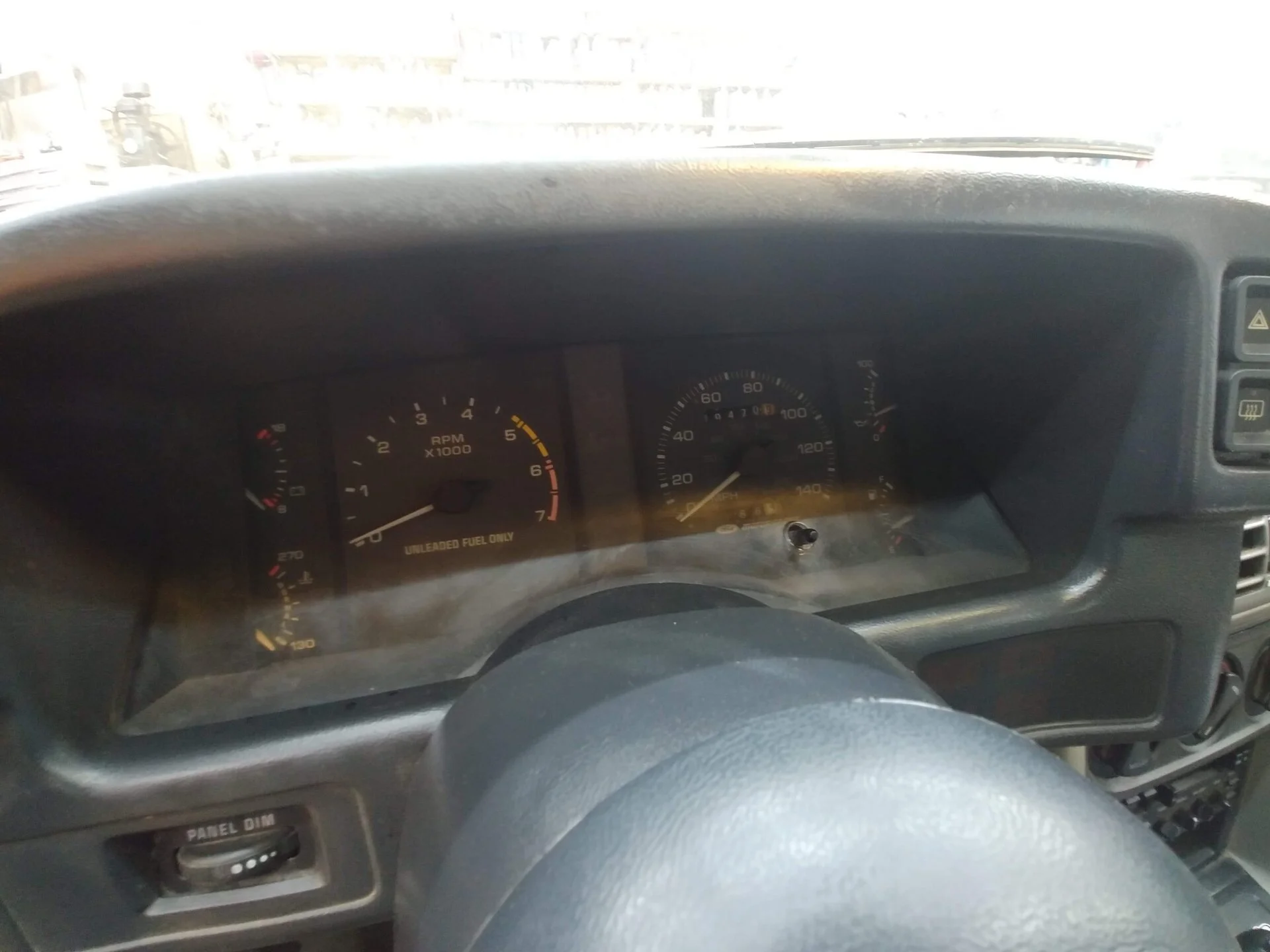

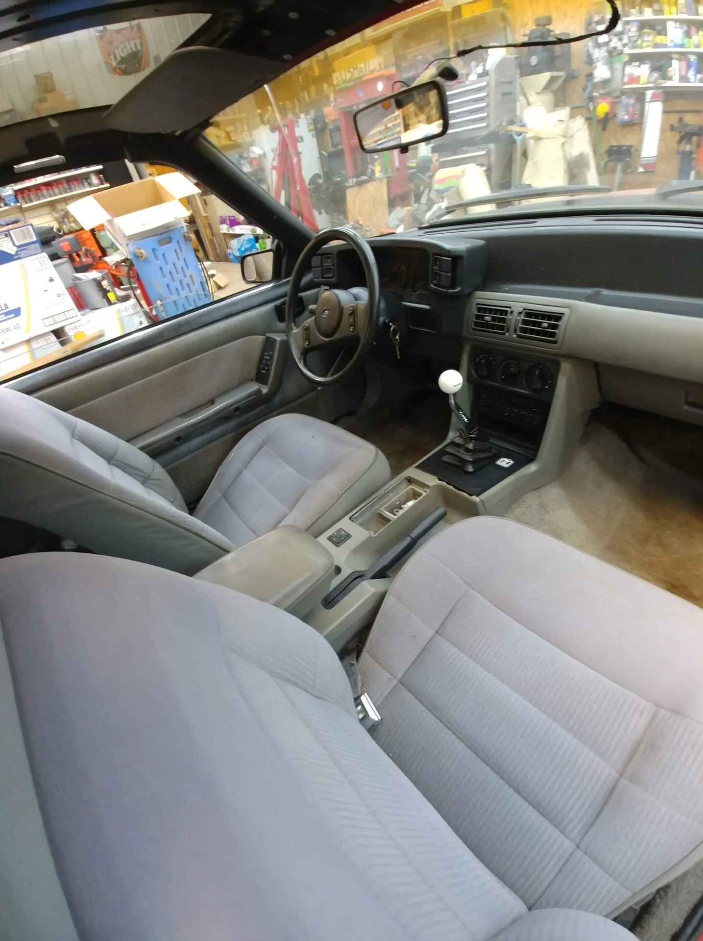

speedo cluster has been changed out to the later 140mph unit, so take the mileage with a grain of salt.
That crunched pass side is a huge turn off. T-top cars are in demand but that damage looks pretty bad. Even the firewall looks damaged at the hood hinge area
I voted no: Here is my explanation.
I grew up with IROC all the guys in the family had one and I cut my teeth in one. Everyone of them has T-Tops.
When you remove the glass its a PITA unless you have nothing in the back or leave them at home. Cons in both aspects.
Take them with you, can't carry anything because you don't want to put it on top of the glass.
Leave them at home, can't lock the car and if you live in a area that the weather changes, well you are screwed.
Stereo was actually the main issue with us. Subs take up the room in the back where you would have placed the glass and if you put them on top of the subs you can break them from the vibration if you have enough of an Amplifier pushing them. My brother shattered one of his this way.
MY stereo issue was that I could not keep the bass at the normal level when raining because the damn thing would vibrate that glass (IN PLACE) so much that it would rain inside of the car.
Other than that.. Great car
I had a T-Top 85 GT. Thought I would love it....I didn't. It became a pain taking the top on and off and it rattled and leaked. I personally would never buy a rebuilt / salvaged titled car. Ever. No exceptions. Everyone will have their opinion on rebuilt/salvage titles but understand it can affect resale value and some insurance companies won't insure a rebuilt titled car.

Same issue with sunroof cars, but in practice it really isn't an issue at all. My hatch is empty 99% of the time (stock radio too, so no sub), so I just store the glass there, but most of the time, I just leave the panel at home in my garage and go out for my cruise. Depending on the stretch of weather (late spring/early fall) the glass will be out permanently and i just leave it on a shelf at home for 2-3 weeks since i would be popping it in/out all the time otherwise.
But your points are valid, just it just depends ultimately on use.

I would do $3K on that car, maybe $4 depending on the inperson inspection. That's only if the firewall isn't wrinkled up in that corner. if it is, that's going to quickly move me into parts donor pricing range.
First thing i'd do is pull the nose off, but new aprons, get it on a frame machine, and get it all welded back up together straight with clean panels.
$6-7K? No way. Not with that damage. To be honest, if the sheet metal damage underneath is bad and the firewall is messed up, that car should be a donor swap into a clean roller. Mechanicals can be swapped and fixed, but you really should start with a good, straight body as a foundation for your build.

Okay all thanks for the replies i will defiantly pass. upon further looking at the photos i have come to a conclusion that this thing has hit something head on on the passenger side corner. Reasons i come to this conclusion is
the passenger side is crunched, the fender isnt all the way bolted down with a gap on that side. also if you look the fender has like no gap between the fender and the bumper its pushed as close together as it can telling me its crunched maybe like 1/4" which is why the fender wont lay flat cause it doesnt have enough space between the bumper and door of the car to fit..
if you look at the driver side picture looking from the back to front. the door & fenders don't match up and stick out with a gap and its not straight where the door meets the front fender .telling me that the whole nose of the car from the firewall forwards has been pushed towards the passenger side.
i thought the dash looked weird but didn't know it been changed. i noticed the carpet i was thinking it was just coming up.
