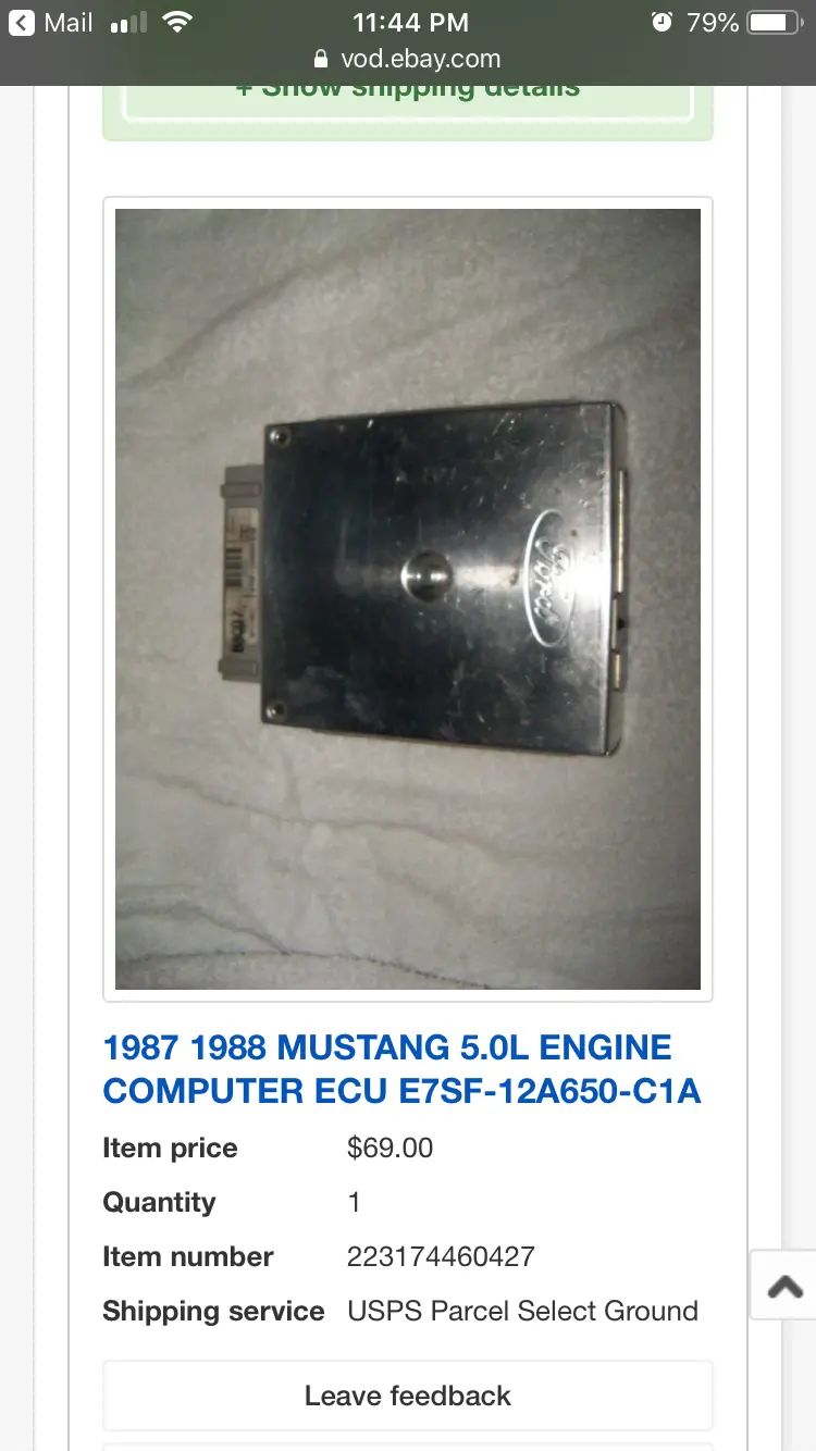

Also- i might add that i had to change out the cars harness and the fella on ebay said it’s for an ‘88 GT but most things were the same. My ECM is as follows

If it is running a non-ho firing order, it won't run properly with a HO ECU as those fire an injector at a specific time assuming the 351/Ho firing order

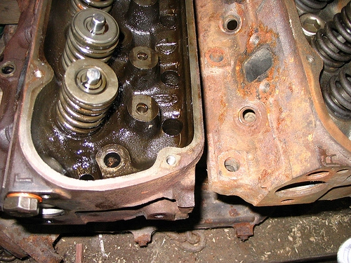

If you can beg, borrow or steal (not really but it fits) a 'camera on a stick' ( bore scope? ) and look for the eye brows on top of the pistons, I've found that non ho engines do not have them, can someone confirm this
According to the pistons, I have a non-HO. They’re flat like the pictures 02 281 GT posted.

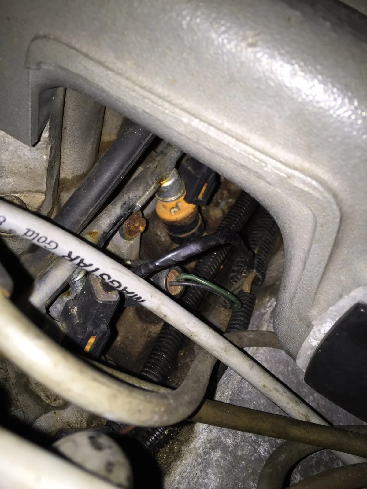

The injectors look like this, orange.

To get right down to it, if the camshaft is not a HO cam, you won't be able to run the HO ECU as it fires each injector in sequence with its firing order which is determined by the cam. The non-ho engines used batch fire which fired each bank of injectors together.
You could rewire the injectors for the non-ho firing order...but honestly I'd start looking for a Explorer engine to use as a swap engine here.

Wouldn’t I be better off getting an ECM that would run the car first? I have performance plans but for now i just want a running car. What ECM would work?
