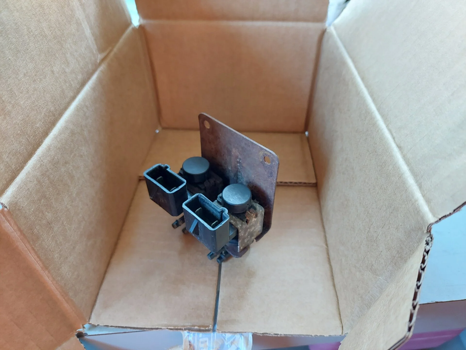

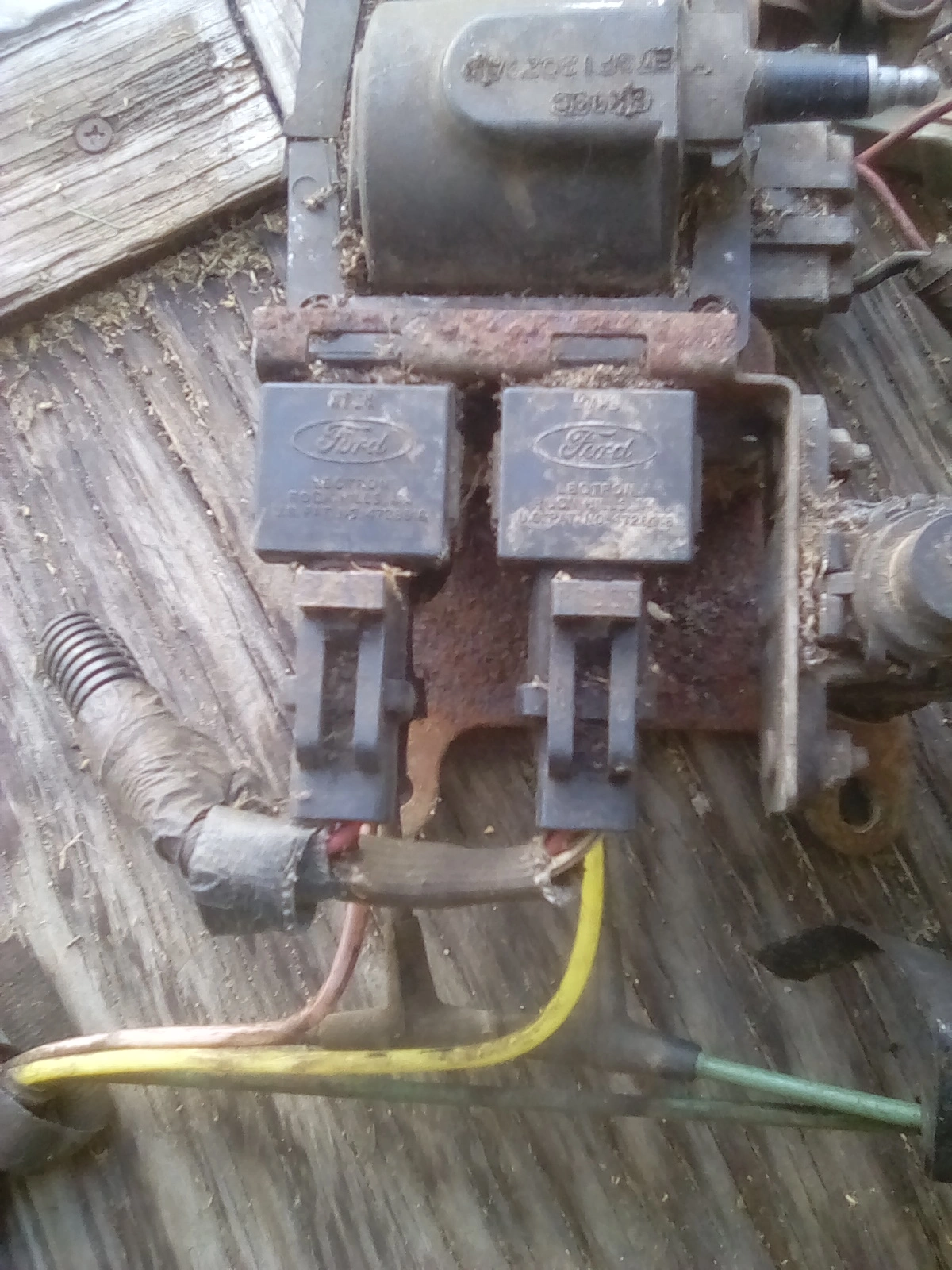

I think I have a spare tab/tad setup in my junk er I mean parts box, I'll look tomorrow. Meanwhile post a pic of yours, I don't know what year mine are.
Here is the 87 TAD/TAB setup :

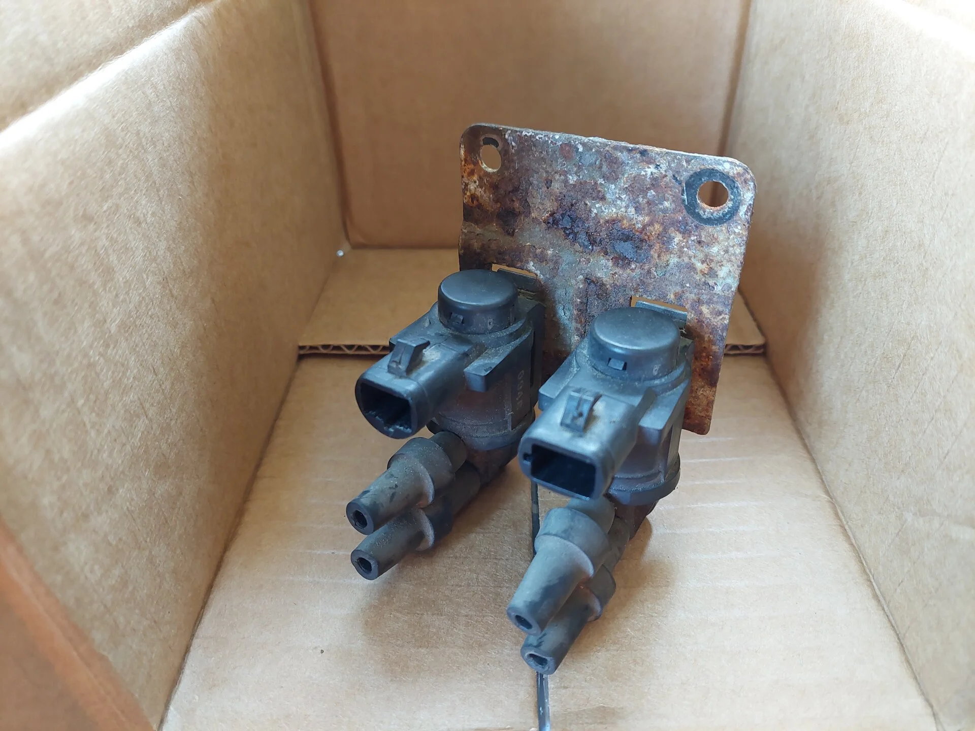

You could just snip the plug ends off for the 88+ version and wire them into your car.
In fact, you might be able to de-pin the connector and just swap the pins from your setup into the newer style plug. The spade connectors look to be the same size.
I considered doing that, but the spade connectors on the 87 are much larger. The picture does not show that very well. It's more likely that I would do some sort of adapter pigtail to convert from one to the other and then use the 88 mounting plate.

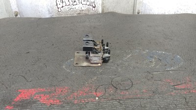

Yes, no part numbers on the TAD. I did not remove the TAB. Found this on Ebay : https://www.ebay.com/itm/1834880894...d=link&campid=5335821607&toolid=20001&mkevt=1
Looks correct. Will see what happens.

That would be correct for 86
