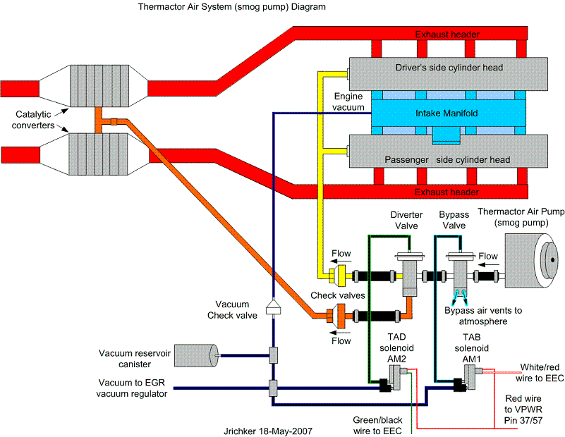

So I have codes 81 and 82 and it is a problem with the TAD/TAB solenoids from what I understand. I jut purchased new ones and cleared the codes ran the car and they came back. What else could this be and how can i troubleshoot this? I found another article that mentions testing the voltage at the red wire i did that and it is 12v like it should be so im kind of at a loss. I do not know a lot about this system so please dumb it down like youre talking to a kid i wont be offended it will be beneficial to me Thanks.

Are they plumbed correctly in terms of the vac lines connected to the two valves coming off the air pump? Are they connected to the correct valves and do they work so that the ECU is detecting a change via the o2 sensors?

All the vacuum lines that i can see are connected correctly. 2 yellow lines to the TAB and 2 yellow lines to the TAD i traced them back and are plugged in.

I would double check to make sure they are connected to the right valves
ok someone on forums said only speed density cars use those so i was confused. I will disregard it. THANK YOU for the diagram i will check in the morning and get back to you i appreciate the help. Been chasing this down forever
