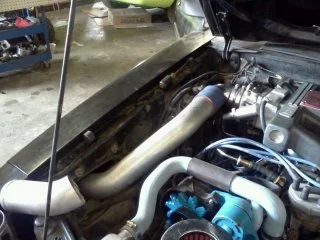

Since this video I've converted to MAF and started making my own custom CAI. I'm gonna cut the flange off a MAF sensor housing and have a welder weld it onto the custom piping.
