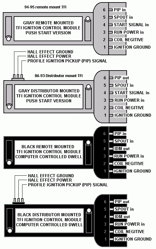

High speed miss on a warm engine
Revised 7 Nov-2016 to add PIP sensor as possible problem and dumping the codes to help determine if it is the TFI or PIP.
The TFI module mounted on the distributor is one of the culprits for a high speed miss on a warm engine. The other suspect is the PIP sensor inside the distributor. If the problem does not occur when the engine is cold, the TFI module or PIP is definitely suspect. Dumping the codes may help determine which one it is. You may need a special socket to remove the TFI module, but most auto parts stores will have one for $5-$7.
Be sure to use plenty of the heat sink grease on the new TFI and clean the old grease off the distributor.
See Automotive Tools Specialty | Auto Mechanic & Technician Diagnostic, Testing Equipment | Thexton
tfi-module-troubleshooting-gif.586550
diagram courtesy of Tmoss & Stang&2Birds

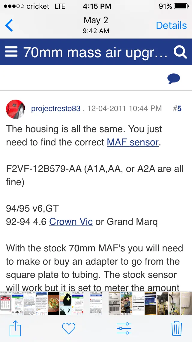

That Theread in the pic on 70mm Mass are said that sensor came on all those cars and will work. I found the same sensor on a 94 3.8 mustang. Are you just saying it won't work on my specific computer?
1992 Lincoln did not have 19lb injectors.
You missed that one...
The OEM Ford MAFs are not calibrated to injector size. The injector sizing is done in the computer’s internal programming. Aftermarket MAF’s “lie” to the computer in an attempt to fool the computer into changing the injector pulse on timing to match the increased airflow.

That's good to know. I figured it was like that since I found the same sensor on many cars. Once I fix the high end miss I will try one of these out. Anyone seen any real world results swapping one with a stock foxbody maf?
So is it the sensor or the housing that's calibrated for 19 pounds
Sensors aren't calibrated. That's strictly and aftermarket thing. The sensor outputs a specific value for a know flow through it. The ECU then takes this signal and operates the injectors based of that flow. Each ECU is tailored for the injectors on the car, so basically if input signal from the MAF is x, then output to injectors is Y.
Aftermarket mAFs being calibrated basically output different values than the oem MAF. By telling the ECU a different value, it "tricks" the ECU isn't adding less fuel due to the larger injector.
Oem systems are grouped in families of compatibility. What those families are is still up for debate.
