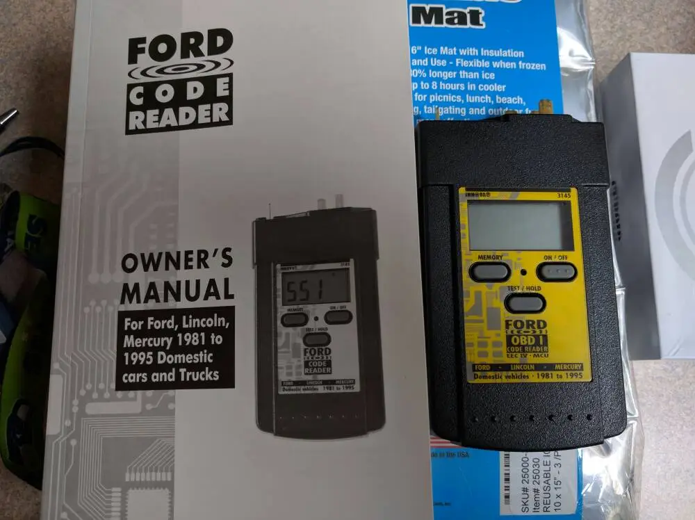

So I went into autozone and purchased a Innova Ford Code Reader. I go through all the instructions and found the connectors I needed under the hood. But when I plug everything in, no codes are read from the device. I looked all over the manual and couldn't get any solid connection to the cars computer to do a self test. How should I go about checking the codes now?

What displays?
Have an assistant press the clutch pedal in (if stick) plug in the reader and hit the Test button. You should hear some solenoid a click under the hood, and then codes should start to display.
Do you have a positive connection with both plugs on the reader?
