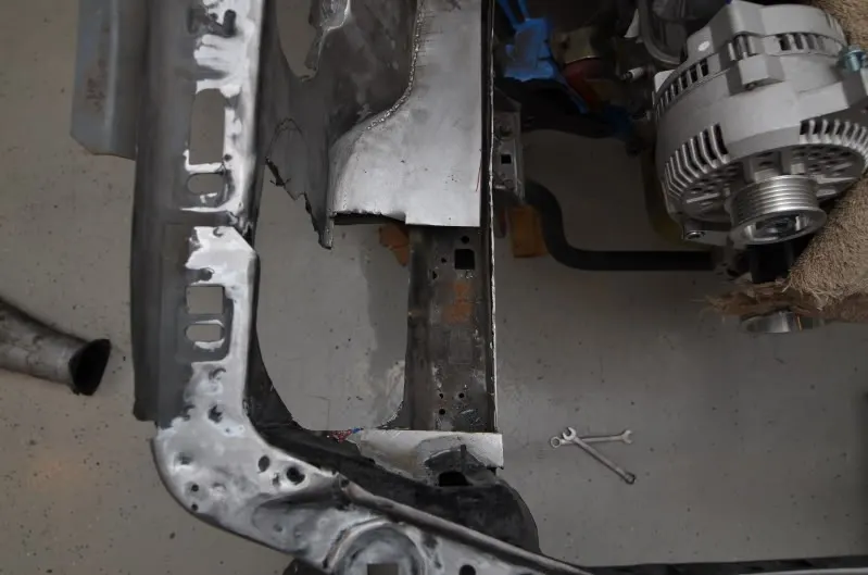

It didn't take long for me to run into my first snag. I temporarily bolted up my MM k-member and mocked up the engine in the car with my HP Performance hotside installed. I going to have to do some trimming on the passenger side for the turbo to fit, which I knew. I'm going to modify the boxed in frame rails to give a little more clearance to the header. Nothing hits on that side though....

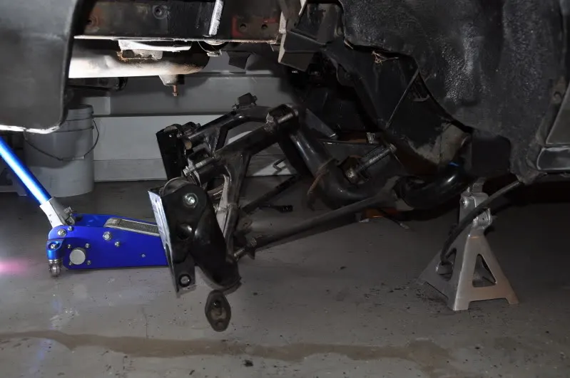

03 Cobra IRS installation
This is essentially the original write-up that I saw regarding the IRS install: http://www.mouthbreather.net/IRSSWAP.HTML .
The write-up is very good and well detailed, however, I had one issue with some aspects of the install that I think may have been overlooked. My main concern was that the author made no mention of reinforcing the frame rails that the...

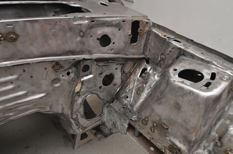

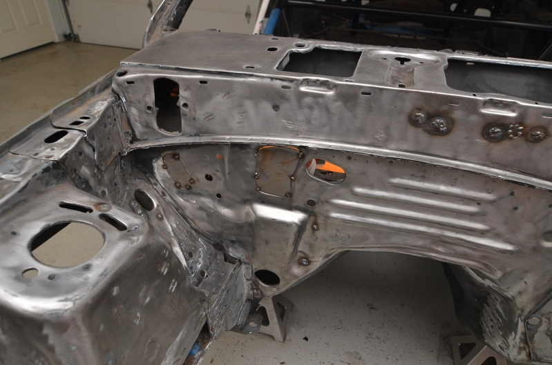

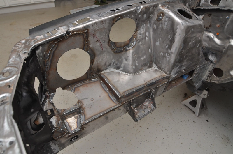

Just to recap, here's the mess I had to make of the inner fender apron to get the turbo to fit:

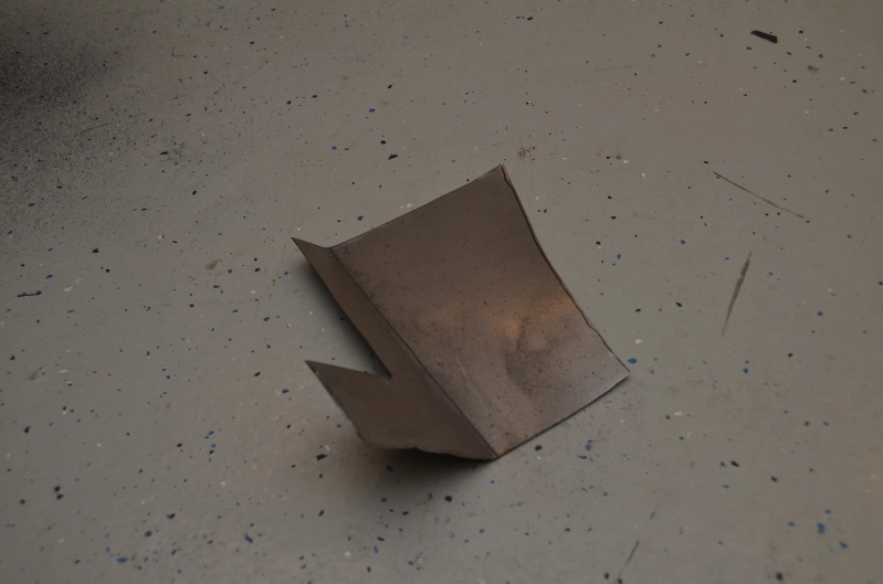

So, the solution was to box in as much as I possibly could to make everything look better and a little less butchered. Took a lot of paper templates and metal trimming to get it done.
Used a cordless jig saw to cut a 5" hole for the compressor inlet...
Read the rest of this update entry...
