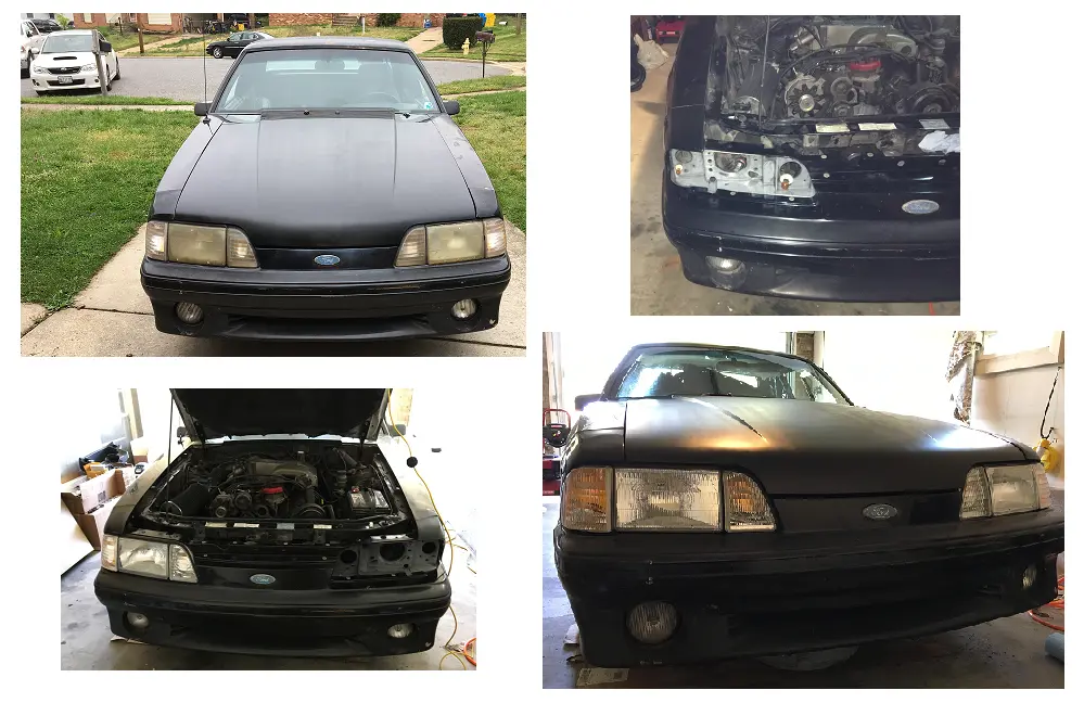

Here's what it looked like when I first got it home...
Jason
I was looking for an old foxbody mustang- just like I always wanted back in the day (but couldn't afford!).. Here's what I got: a 1989 hatchback, 5.0 with T5, radio & AC delete, manual windows and door locks- pretty much a stock base model that somehow made it this many years without being modded. Carfax and odometer seem to agree (even though the odo has rolled- twice!) 247k miles! No registered collisions (although it does appear to have 1 replacement front fender on it), clean title, mostly owned by the same dude as near as I can tell.

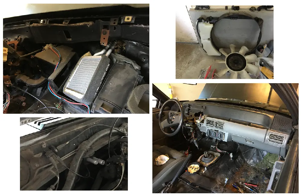

4) Replaced heater core (I consider this cheap insurance, even though when I got to the heater core- it appeared to have been recently replaced. Oh well, now it is new and replaced.

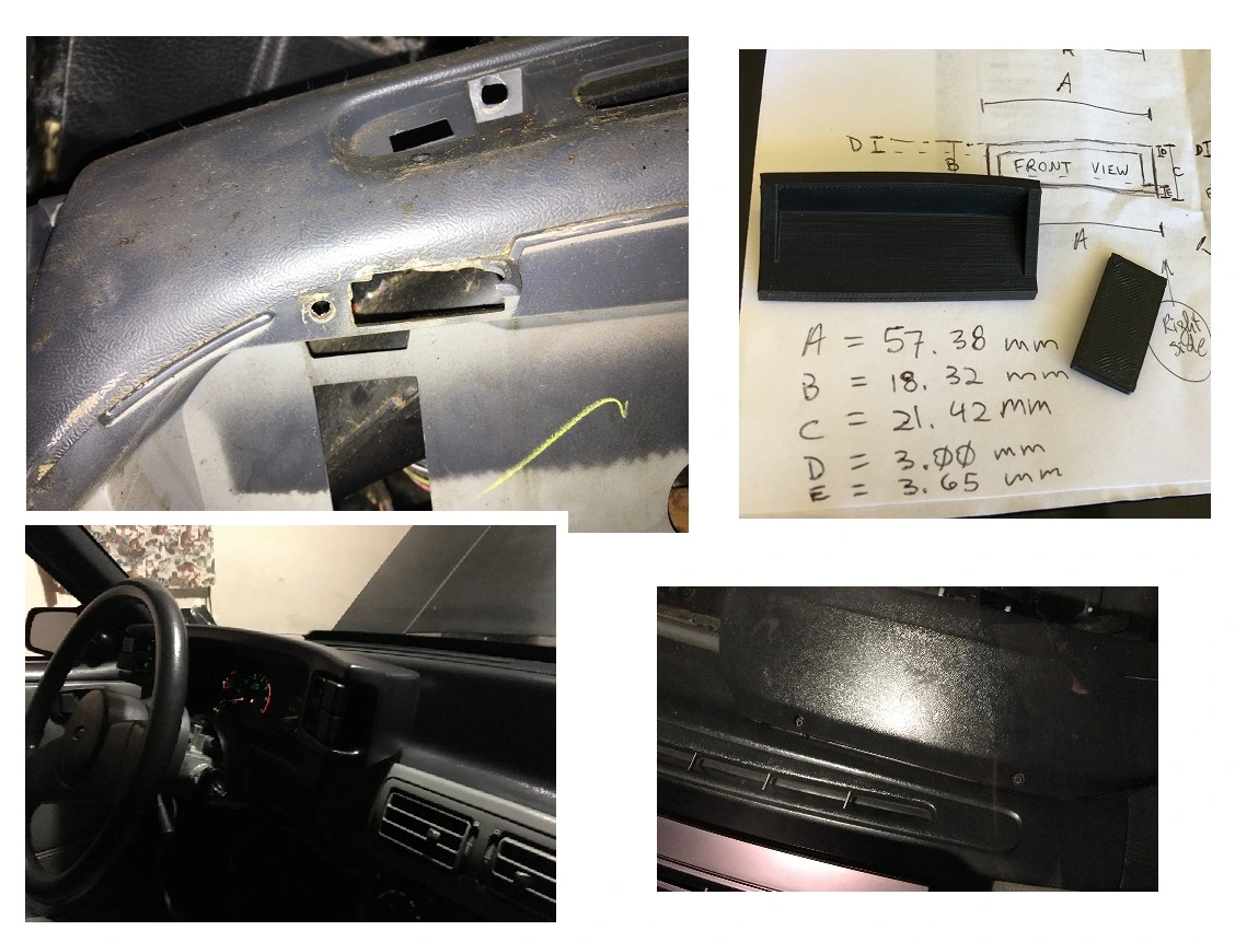

5) While I had the dash apart, I fixed several small cracks on the dash, replaced the broken instrument cluster cover mounts with epoxied in, 3D printed replacements and new speed nuts, cleaned instrument plastic, replaced all bulbs and cleaned contacts, re-assembled. Now dash lights work, no vacuum leaks caused (vents still motor around). Added missing speed nuts too, and made sure all screws were in place. Quick rustoleum on slightly surface rusted metal dash mounts.
6) Got off eBay replacement instrument cluster cover (mine had broken screw holes and extra holes in the back to match the broken dash mounts), mounted to fixed dash- looks great!

8) New water pump, thermostat, thermostat housing (motorcraft direct replacement), radiator and radiator cap, reservoir tank, all 6 new hoses (made sure heater core flow restrictor was in place!), serpentine belt, and idler pulley. Had a leak on the water pump backing plate bolts (and I torqued them too!) so I'll be replacing the gaskets with Felpro ones this weekend hopefully.

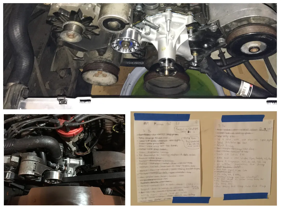

Some progress pics:

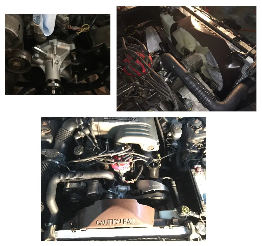

On the car front- I've re-done my water pump.. (funny, I used to be a Ford tech- and so I've gotten a "come back" on my own car! lol The culprit? I was over-thinking tightening those backing plate bolts, and had cautiously torqued them to 10ft/lbs.. This time, I made sure they were good'n'tight, leaving the torque wrench in the toolbox. Overall I'd cleaned everything up again, put in felpro gaskets between the plate and pump, and also between the plate and timing cover, and bolted it back up (15ft/lbs on the bolts/studs). Refilled, burped the system, topped off, and have run through a few heat up to operating temp. and cool back off cycles (plus it's sat for a few days too)- and knock on wood, still dry as a bone. While I was in there, I stupidly paid the 70 or so bucks for the Steeda aluminum idler pulley (stupid of me, because the car needs so much other stuff, but, hey- the car has earned it!) You can't really see it when the fan shroud is back in, but it runs silent! Plus, I know it is there! :) A high quality unit for sure- just make sure if you get one, install it with the circlip pointing towards the engine or you might have clearance issue with it spinning. New serpentine belt too. Good stuff! Idler tensioner system wear indicator is now perfectly in the "you're good" range.

Well, I had a few minutes to work on the car- so I cleaned the IAC motor, and re-installed it with a new gasket. No change to the idle- idles high, with occasional surging. I pulled the codes, and got an 81 and 82- related to thermactor bypass valve I think... I wouldn't think this would affect idle, unless there's a vacuum leak somewhere? I still need to test/adjust the TPS, and wanted to set the timing, but my timing light wasn't working last night- hope it only needs a little TLC to get going again!
The IAC was pretty dirty, so it was cleaned. Testing with ohm meter, it registered just higher than 10 ohms, which I think is good. testing each terminal to IAC case/ground, I got open circuit on one size, and a slight value on the other side, consistently.. Is this a short? Or, does this sound normal? I want to say it was like 3 Megaohm or something...

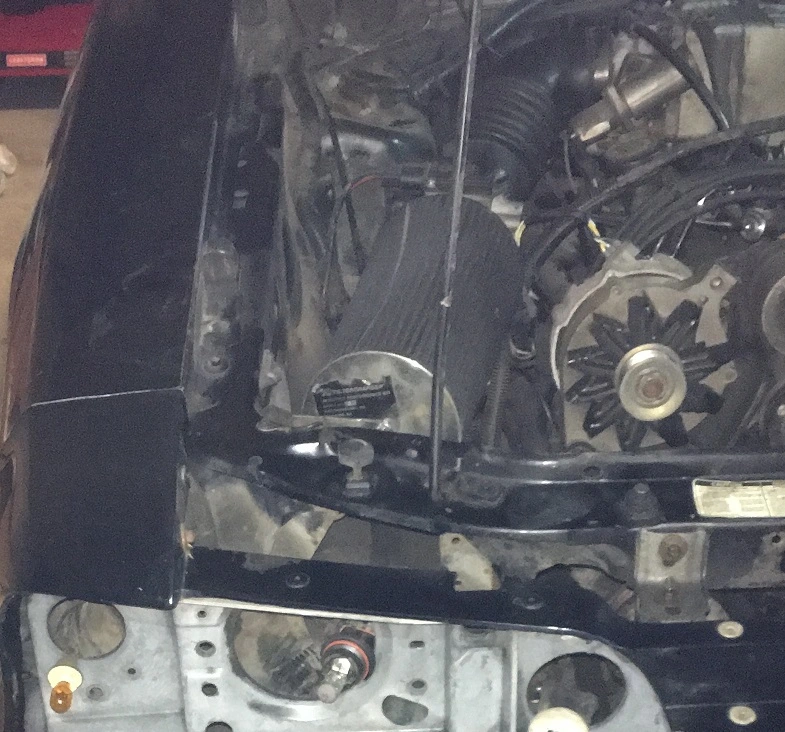

Also, I'm wondering- if the car's aftermarket airfilter (a long, inside the engine bay "cone") could contribute some MAF turbulance? You dudes might think I'm crazy, but I'd love to convert this car back to 100% stock, including the airbox (if I can even find one!) Anyone know if there's an online partsfiche kinda place, where I can see what parts are involved? Obviously there's the top and bottom of the box, and the filter, but wondering if there's anything else. Here's what my filter currently looks like:
