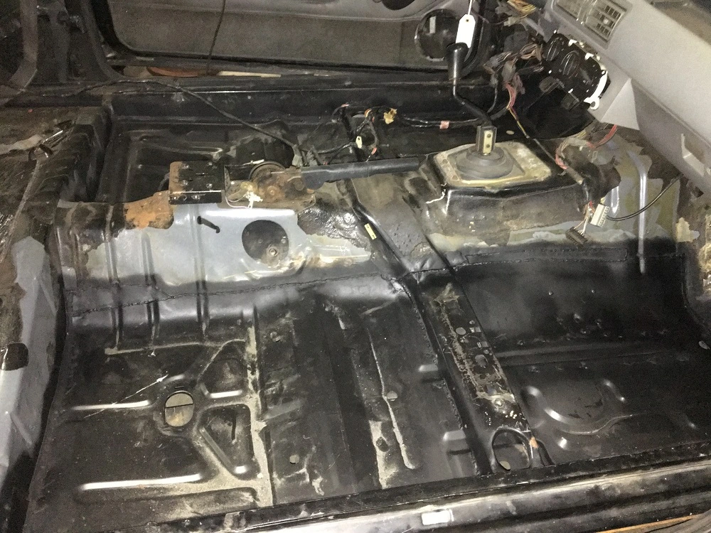

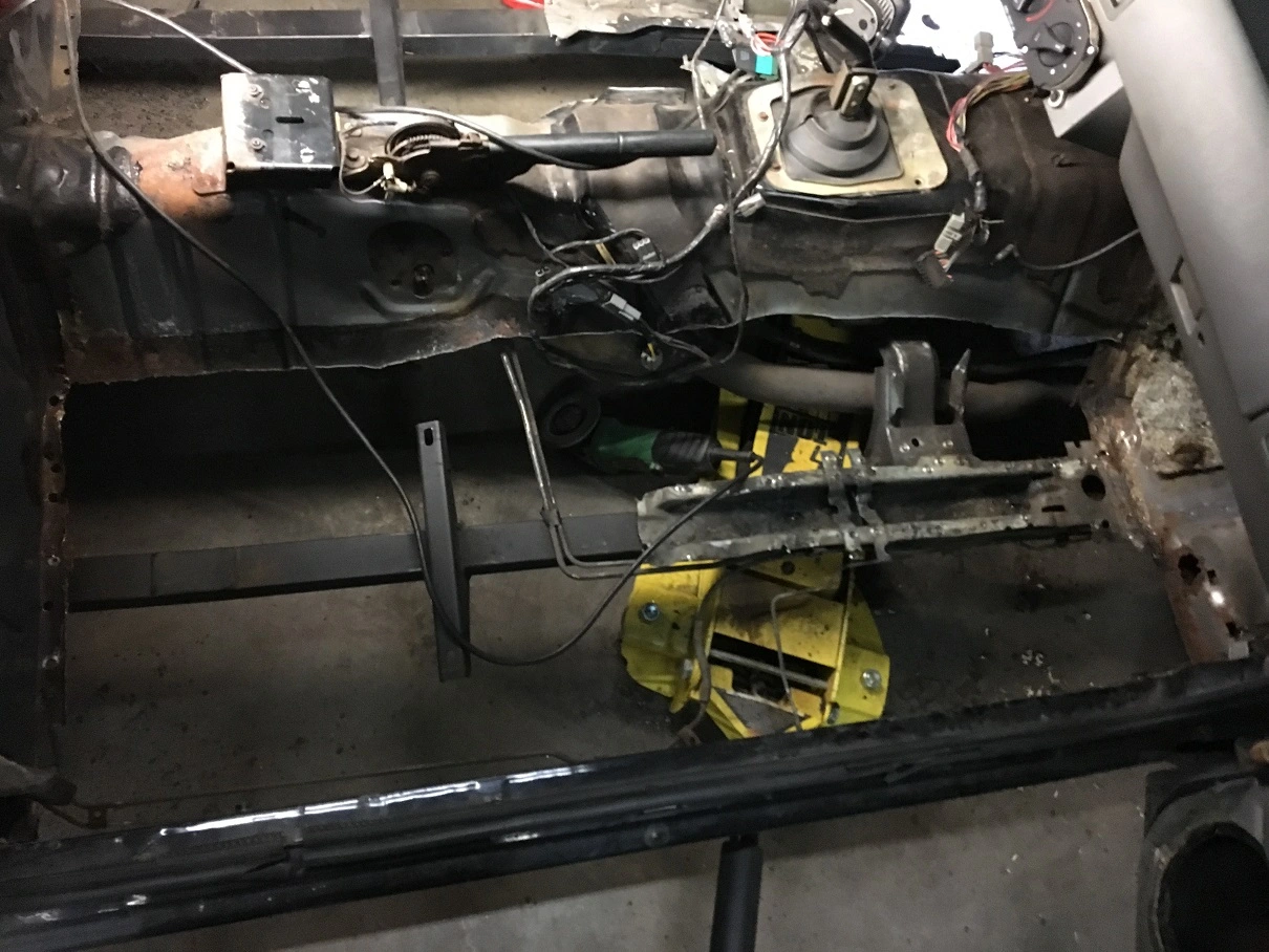

Well.. The good news is, the subframe connectors are installed. Yay.
However....

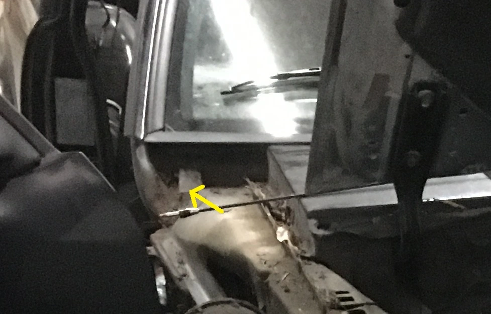

There's some bad news: When they cut away the rusted out floor plans, they discovered the drivers' side A-pillar rotted out at the bottom.. And the bottom of the front drivers' side fender. And the passenger side outer rocker panel. We won't know the full extent until they get the front fenders off.
Suddenly, my "good deal" I was telling others about- isn't such a good deal :-)
On the bright side- the shop is confident that it can be fixed, and fixed right. I sure am glad I didn't excitedly buy up a bunch of parts to finish the build, anticipating the floorpans being the limit of the damage. And very glad I didn't "go big" on the stereo equipment! Hope this doesn't get TOO expensive!! (just think, I was thinking that I'd be installing the stereo soon. ha ha ha!) :rolleyes:

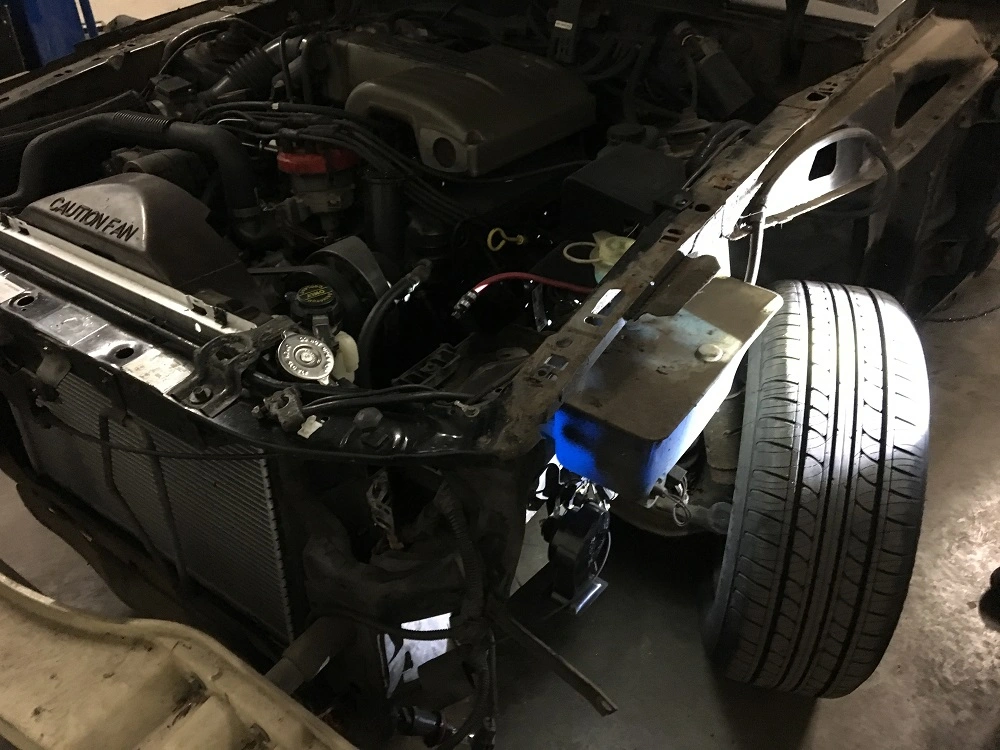

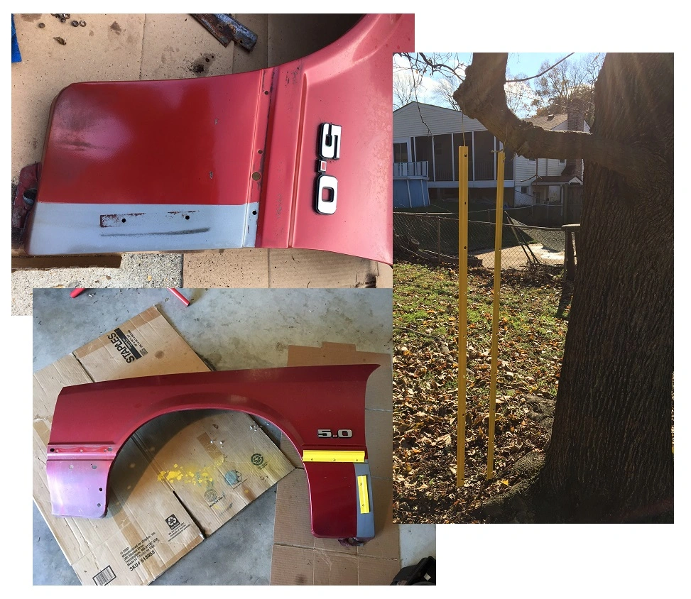

Before I dig into super research mode: Anyone got any quick summary info about fenders:
a) Do all 79-93 fenders fit? Or are the 79-86 fenders different than the 87-93?
b) Can I just swap over the GT aero stuff? The lower airdam/scoop parts, and the rubber trim?
c) OEM -vs- what's easily available today... Big difference in thickness, quality, fit?
Anyone got some OEM fenders they want to sell? Don't care about the color- but would like them to be relatively straight and rust free.
Hey look: from this angle, it doesn't look to bad! :-)

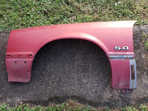

Got a fender- from an '89 GT no less, no rust as near as I can tell, other than the ground effects brackets- which I'll R&R later this week. $75, but I had to drive 1.5 hours each way to get it.. Still beats $200+ "freight" ones I found out-of-state wanted to charge.. Well, this one was out-of-state too, but, you know what I mean!
Yup- I did a little research- using this book (not sure if it is 100% accurate- but seems good?) It claims 1990 was the last year for the turbine rims; 1991-1993 got the pony rims- which I know are bigger. Would only make sense, that is when they changed the fender opening size- but who knows... I think I lucked out finding a 1989 fender locally.. The prices of the OEM stuff (even used) seems to be getting up there!

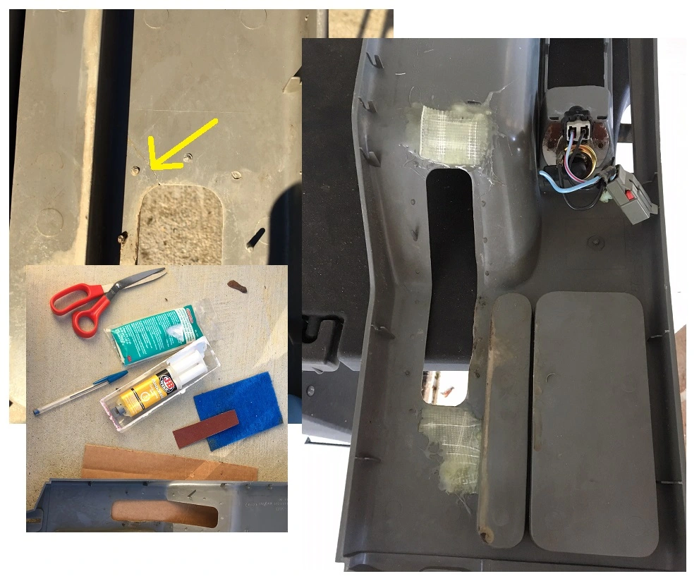

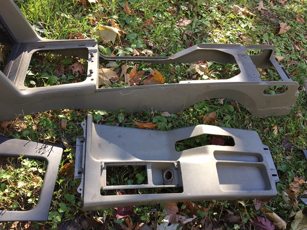

Ok.. Finally did some stuff this weekend. First, I painted some new brackets (geeking out, after having to have rust repairs at a fab shop- now I'm priming and painting all metal parts that go on the car!) and riveted them on the fender. I also painted the rocker panel brackets (which the fab shop told me I also need to replace), and I'll be taking this stuff to the shop tomorrow am, so they can hopefully finish the car up this week. It will be good to have the car back! I do think I need to figure out a better way to paint stuff. Rustoleum (and any other consumer level spray paint in my opinion) is just fragile. You look at it wrong, and it will come off. That's with self-etching primer, and then color coat (lame a$$ yellow no less. At least no one will see it once it's installed!)

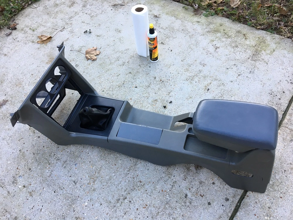

Next up- I got some "purple power" spray cleaner, after seeing some dudes on YouTube kick butt with it cleaning interior panels. I went to my parts pile, grabbed the center console stuff, and went to work. First spraying with purple power, and scrubbing with a scrub brush, and then paper towel dry. The paper towels turned brown- yuck! Maybe the previous owner was a smoker? Or, just 30 years of nasty = brown stuff on your paper towel.
Before:
I should mention- on the plastic piece that has the ashtray and the slot for the emergency brake lever, there was a crack on each side of the emergency brake slot. I put some blue tape over the crack to hold it together first, and sanded it a bit on the back side. I considered trying plastic welding, but decided to stick with what I know (fiberglass and epoxy).. So, I cut a two patches for each crack- one bigger than the first for each side.. Then mixed up the plastic two-part epoxy, put the smaller fiberglass patch on each crack, put more epoxy on it, and put the bigger patch down. Finally, I put more epoxy on each side so all patches/fiberglass is embedded. Then, once dry, I flipped it over, and removed the blue tape. There's just a tiny bit of overlap epoxy going around the edge to seal the crack on the top side. You can't even see it if you don't know what you're looking for.
Ok... Now that the cracks are fixed, time to get back to cleaning.. The purple power appears to be some pretty strong stuff, so, I decided the next step should be soap and water with scrub brush action, and paper towel dry.. Now the paper towels are coming back clean looking- I think this is a good sign. Finally a few spray downs with armor all, and dry with paper towel- as I think the purple power cleans well, but makes the plastic look chalky.. Now these old plastics are looking pretty good! (Good for 30 years old, and cleaning and armor all. I'll have to check out that SEM paint I see for sale on LMR if I want the ash tray door to match.)
After:
I've just got the new carpet kit from ACC (dark smoke I think it's called?) and the ash tray repair kit- so once I get the car back, and I've installed the sound matt, these items will be next, along with the stereo install.

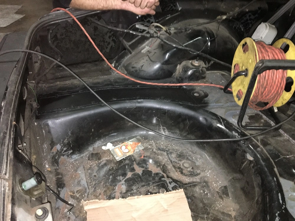

Stopped in to the fab shop to drop off rocker panel #2. The one obtained from NPD seems to be a better fit. While I was there, I took pics of the car- work in progress, but getting close (just needs the rocker panel welded on)..
Here's a pic of the floor pans, installed now:

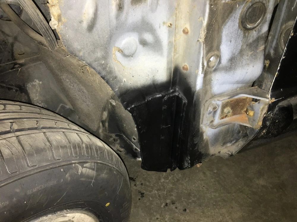

This show shows the repaired bottom of the A-pillar:
The trunk/spare tire well rust is now repaired:
Here's an overall pic- fenders and front bumper cover off:

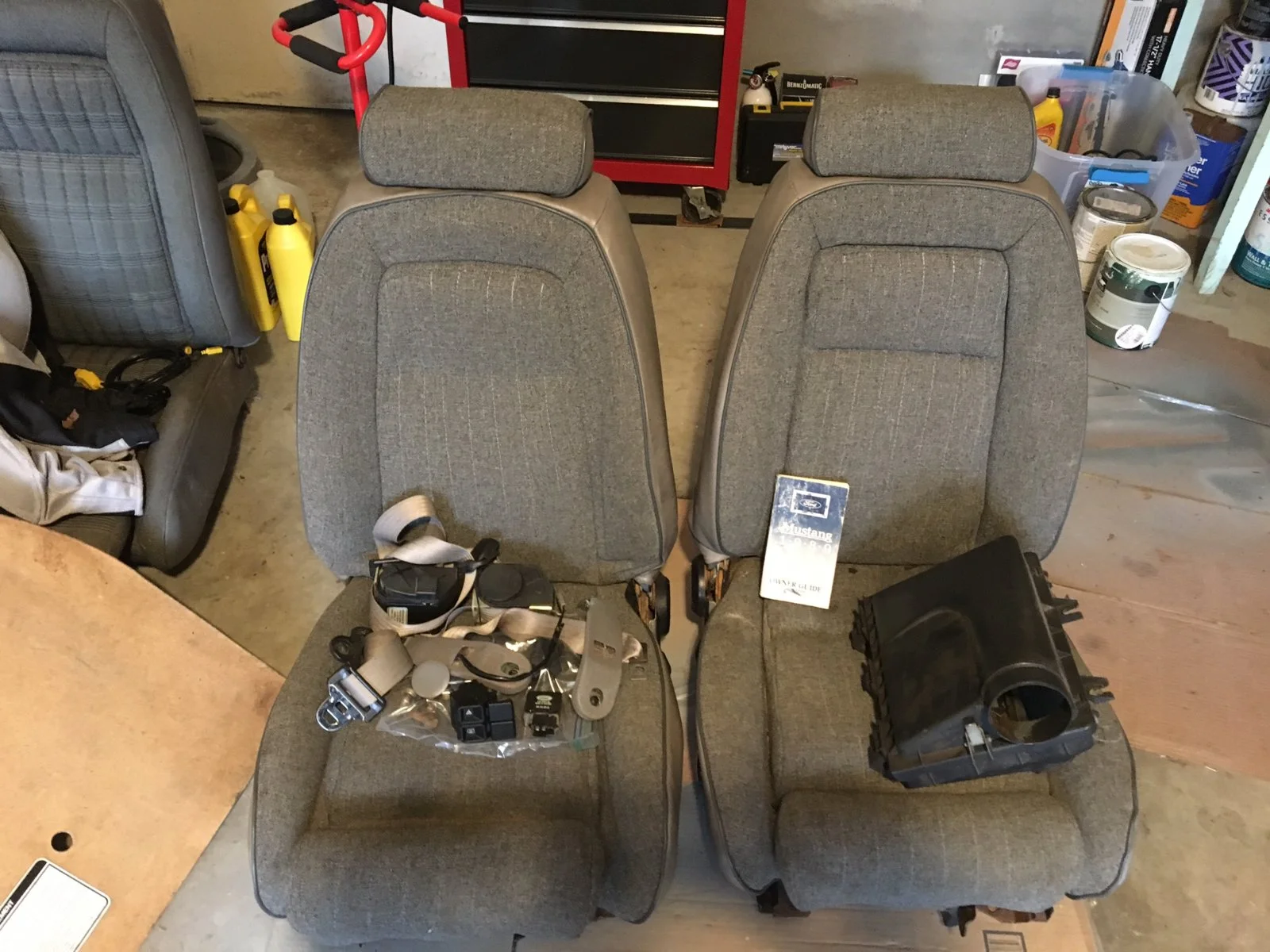

The car is gonna need a major vacuum and clean out before I do anything else. We found a couple of small instances of rust- one right near the driver's side mount for the sway bar on the frame rail, and one on the passenger side windshield base (was hidden by the fender).. Both are not too bad (lots of good metal still there)..
Once they get the rocker panel on, I've asked them to evaluate the frame rail part; I'd rather they fix this one now.. The windshield one I'm debating: I'd really like to get the car home to put the interior back in. What do you guys think? Fix now? If this is fixed later, does the dash and interior need to be yanked out? I don't have a good pic of it, but this one sort of shows it:
Thoughts?

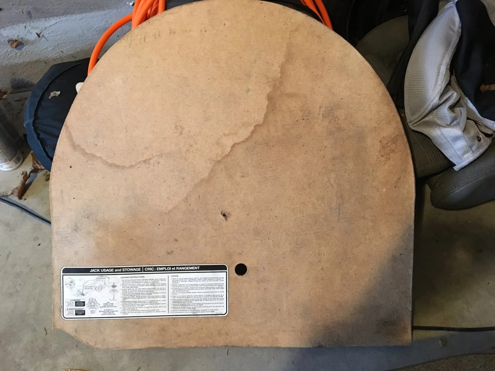

Well, Craigslist to the rescue!!! I found a guy 1.25 hours away, who has many foxbody mustangs in various states of parting out, plus multiple "buildings" on his property, filled with parts. I bought two front seats, front seat belts (the ones that came with my car are ripped and stained), another 85MPH speedo (bought for insurance- as my wires are starting to delaminate off the film circuit board on the back), all the seat bolts and plastic seat bolt covers, a spare tire fibreboard cover, the two round plugs on the center console armrest, a 1989 owner's manual, a stock airbox, and the parts I needed to get rear-window defrost enabled (the hazard switch with the defrost button, the defroster relay module).. All for $150.00. The seats are in good shape- not bent (like my drivers seat is), and recovered (they did OK.. no rips, looks nice, but they must not have used new foam, as they look just a little bit deflated..) Oh! The head rests on the two seats I picked up look a little short.... Wonder if these were originally from a convertible?
The spare tire cover appears to be from an SN95, but I here they have the same exact tire well? Hoping this works...
