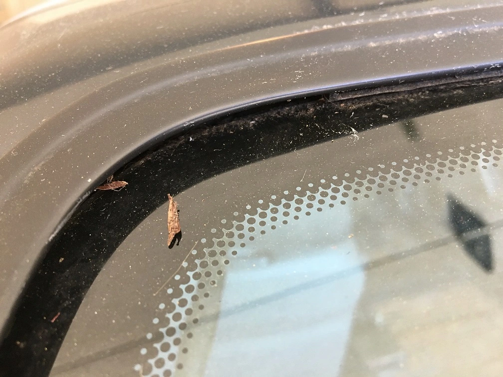

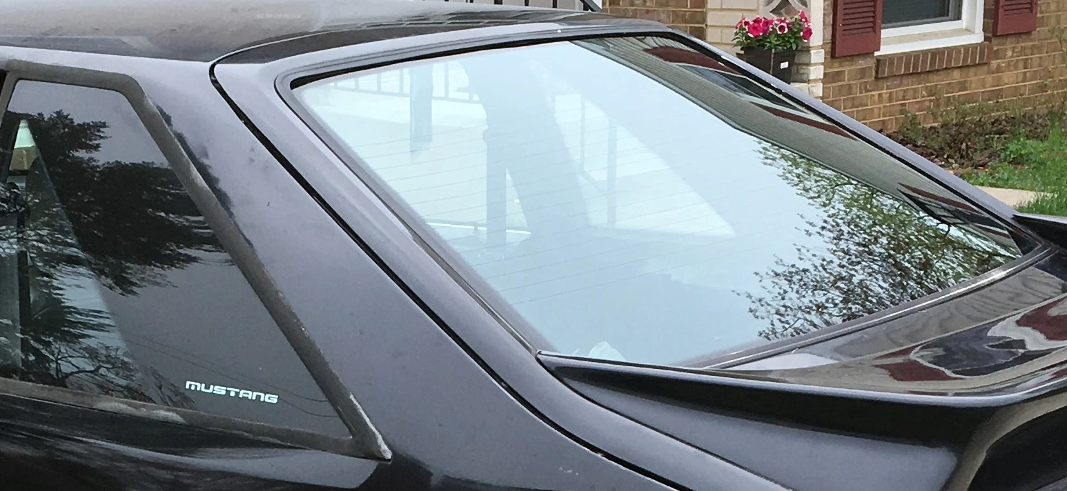

Here's another question I have for you guys: What's going on with my rear hatch window? There is a pretty sizable gap between the the glass and the seal/trim.. Not sure what this is supposed to look like (can't remember!). Here's what mine looks like:
And a closer look:
I've seen windshield kits, and rear quarter window covers (I guess the trim comes made on to those quarter windows? Any other way to replace this but use the stock windows that say MUSTANG on them?)... but no rear window kits. Are these available?
The glass trim, and the door window trim/felts is of course blown out.... At some point I'd like to have the car painted- but there's a lot of other things that need done first. Therefore, should I hold off to do the window trim after paint? Or can it be done now without wasting effort? Sorry to ask such a newbie-ish question, but, never had a car painted before. Same question goes for the "Ford" oval logos front and back, and the 5.0 badges (which are OK for now, but the ovals are totally thrashed looking!) Guess I should wait on these?
That gap isn't unusual. You can take the trime off and lightly bend it down a little in the corners. It's not too tough.

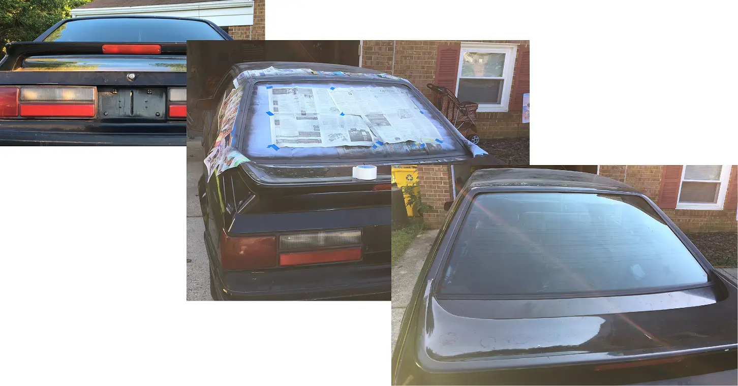

Well, it's been a while- have had lots of non-mustang business, as we all here have. Finally got back into the Mustang project today.. Sometimes, you just gotta do little stuff. For example, I masked off the rear window trim, and painted it back black (it was mostly black, but had lots of boo-boos.. Also, the car has wipers once again, now that I've re-painted the wiper arms, and put on new wiper blades. Is it normal for them to sit up this high? I can't remember!

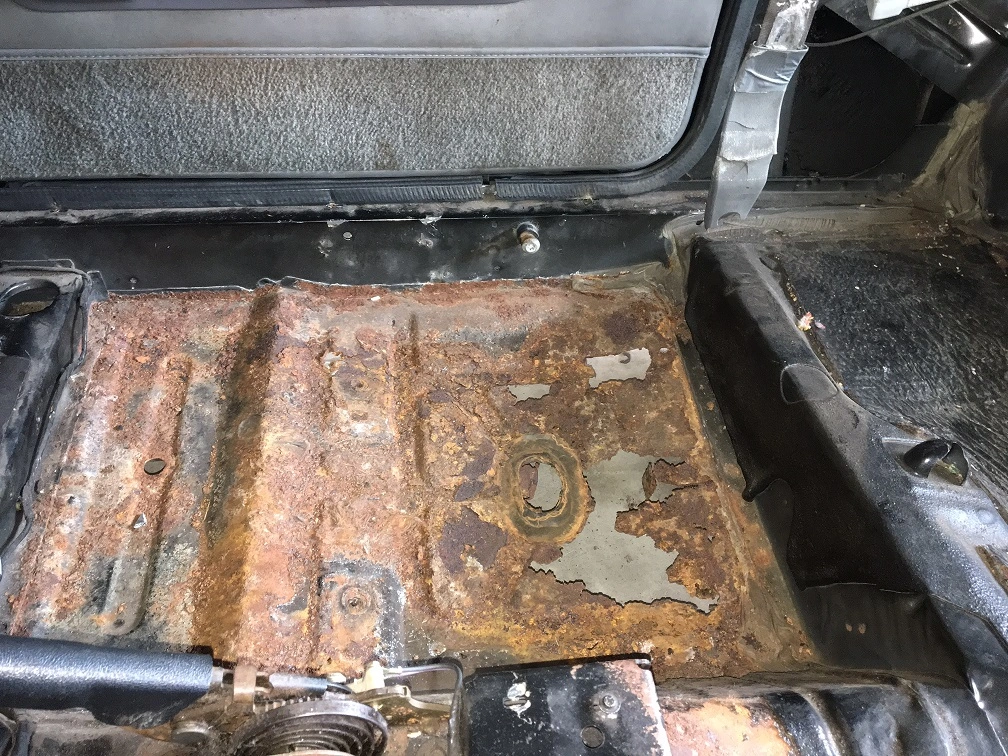

Next up (hopefully!) is to fix the passenger side floorpan, and get this thing road ready!

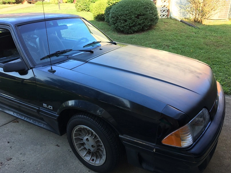

Yeah, the sit high. I normall take my wipers off and store them in the hatch. I have rubber sleeves that fit over the splined shafts to clean up the look.
I don't drive in the rain so only time they go back on is inspection time

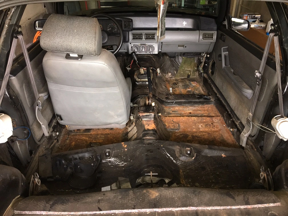

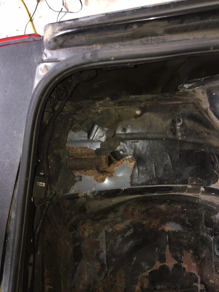

Ok, update.. Unfortunately, in this wonderful state of Maryland- apparently folks are so prosperous, it seems like NO ONE is willing to take on this work- none of the highly regarded body shops around here. They say they have new cars to fix, all day long, and don't want this thing messing up their shop I guess.. I know it's just business, but I am very frustrated by this!!! :mad:
I know I know- I should take a deep breath, and contemplate- if this is the worst of my problems, I got no room to be complaining! First world issue, eh?
So, I am not quite sure how to proceed. I can start calling fabrication shops (sounds expensive and timely).. Or, I can buy a Hobart handler, learn to do this stuff myself, do this work myself, and then sell the welder. Thoughts? My previous experience with a torch is limited to a cutting torch.....
From what I’ve seen, many of the “body shops” are actually just collision shops and focus 99% on Insurance work. I’d look for restoration shops.

I suspect maybe I have a level of ignorance when it comes to "body shops"... I felt like the ones that have turned me down could do the work, but are too busy riding the gravy train? But, perhaps as you say, I need to look for a restoration shop. I just think it sounds like it is three times more expensive? Just like when you take a BMW to the shop for a brake job, the estimate is like 3 times what the dude driving the old Mazda got- for essentially the same work? I could definately be wrong- and perhaps they're just specialized?

And I realize I'm being stupid about this- typical entitled right-now guy that I'm trying not to be, getting the best of me. I just got off the phone with a fabrication shop, that just got done doing floorpans in another foxbody. Looks like they'll get my $$$$ to fix my ride.
Ask the 'fabrication ' shop to show you some of their work. Not the painted up pretty stuff, you want to see something in progress. Be patient, I've seen a few hack jobs that looked good all prettied up.

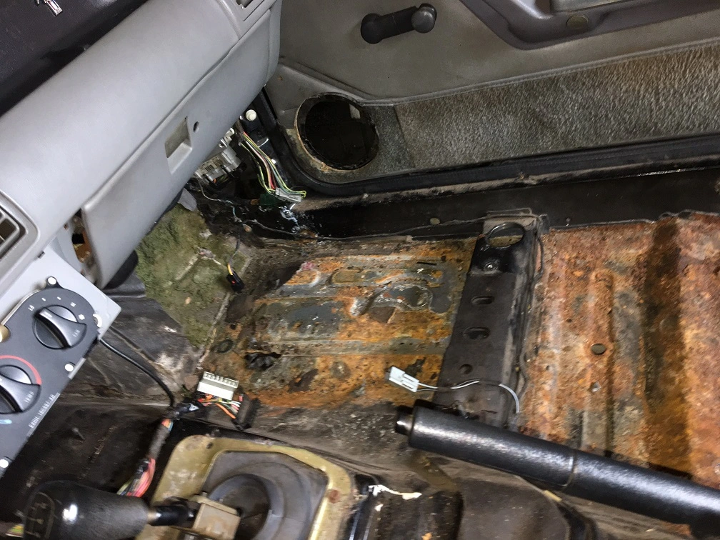

I've been talking to the fabrication shop that's going to do my floorpans.. I was at first only going to replace the passenger floorpan which has through rust- but decided, for not much more $$$, I can replace the driver's side floorpan too- and why not if I'm going to all this trouble. AND, this lead to sub-frame connectors being purchased- because, I'm right there, and having welding done, I might as well while I'm here.

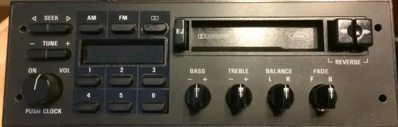

And about the radio- I'd love to have a touchscreen or GPS/nav radio- this would be my only car with one, as I could add it for MUCH cheaper than the factory wanted for stock nav radios with my other cars (3k+ option! No thanks!) It's certainly not period though.. And, it would be kinda cool to find the stock radio to put in (even though according to my VIN, this car was factory radio delete too!). Anyone familiar with the stock radio unit- any chance there is an AUX-in channel on the back, so that I could integrate a phone or another music source?

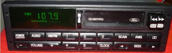

I'm pretty sure this is the year/model correct factory radio:
...and not this one:
...however, I remember radios looking like the second one when I worked at a dealership in 1993-ish, and I also remember those radios having an option of a CD-disc changer.. So, I wonder if anyone here is familiar with either of these units (looks like they both mount the same way too- perhaps same harness on the back end?) enough to know if either has a CD or AUX input on the back, and support in the head unit so you can select a source other than AM/FM/cassette...

Top radio was factory until 1992, but you can install the bottom more modern radio or the 1993 CD player (if you can find one) only the 1993 radios can control a changer but the Ford cd changers are rare as well. Some explorers and mark8s had them. I made a thread about putting the 93 system into An 87-92 car, but I've been getting the itch to just install a nice cheap double din with gps, Bluetooth, USB charging and app capability just to get with the times. I don't even own cds anymore.
