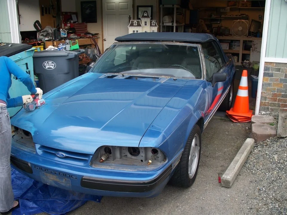

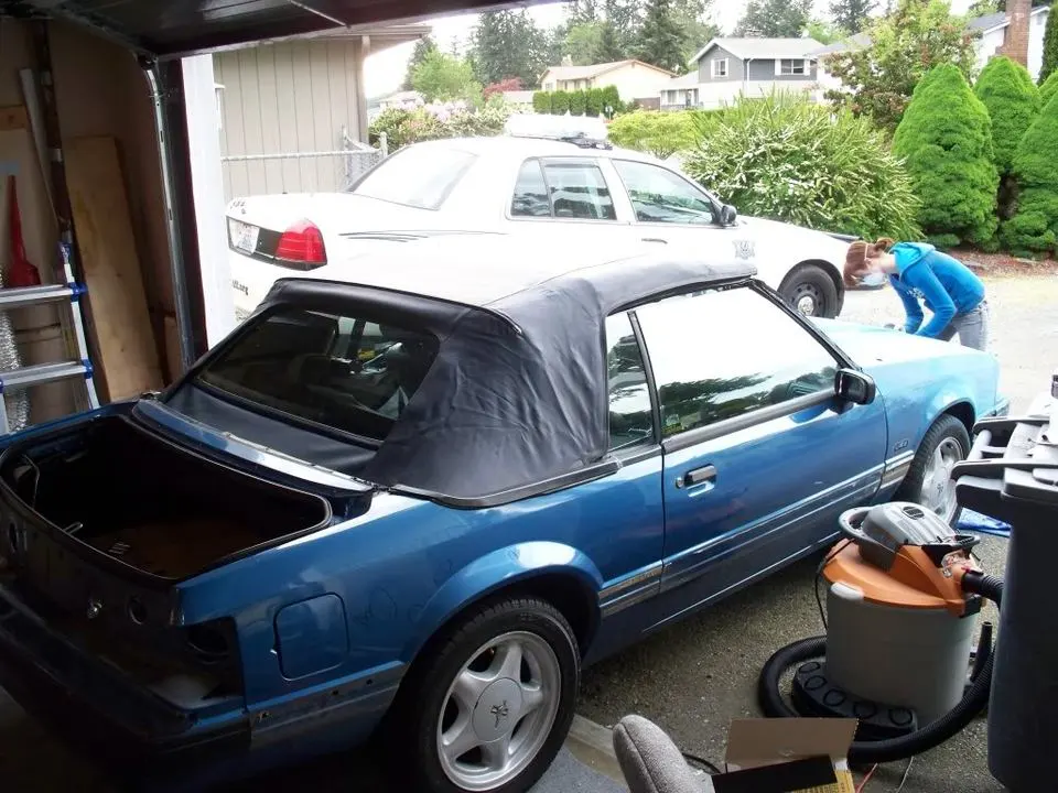

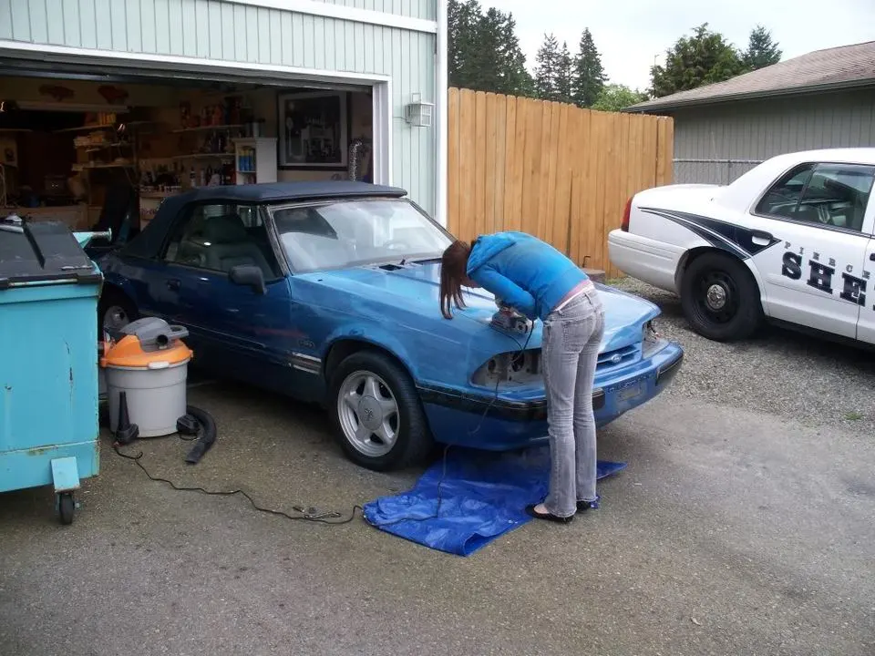

I started the tear down on my DropTop This weekend. I will be getting after it next week pretty hard as I have some time off:D! My Daughter grabbed some tools and a sander :jaw: and jumped right in made me very proud! :nice:
I love seeing teenagers getting interested in these cars, especially girls. We have several friends whose kids give me hope that there is a generation coming up that will still love these cars.

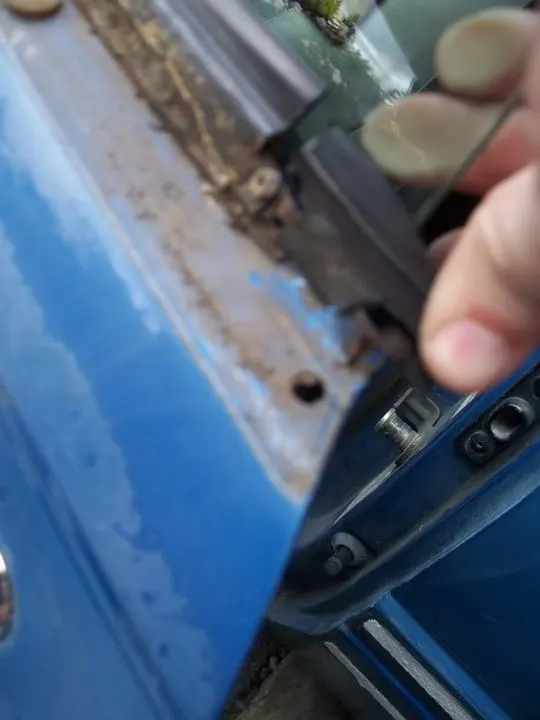

Thanks Guys. I was quite suprised when she came out into the garage and asked What can I do to help. My youngest (16) would not get dirty if she had too. My oldest (19 boy) never sticks around to see or learn anything. The paint on old blue was excellent on the passenger side but the driver's side had been repaired at on time on the door and clear coat was peeling and paint fade was horrible. Getting a smooth trunk lid for it. Looking at some diffrent cobalt blue to bright blue metallics. HAving trouble getting the door mirrors off. Any body got a secret for these as well as the top of the door molding? I will keep the pics coming next weekend as I have 5 days off and plan on sanding her down and starting some body work (little nicks and dings) She is pretty straight with 82k on her. Thanks for looking Brian:nice:

Brian -
First off, you need to take the belt molding off the door. Open the door and you will find a sheet metal screw underneath at the back of the molding. Unscrew that and the molding will slide back about an inch with a little help. It will then come off. Now pull the door panel off the inside and pull the plastic sheet away from the upper front corner. The mirror is held on with two nuts and a power plug. Note: Be careful to not drop the nuts down inside the door. They're a PITA to get back out. The front molding piece is also held on by two nuts. More than likely, the studs that the nuts thread onto are very rusty and will probably break. If not, consider yourself lucky. If they do, Latemodel Restoration sells new ones for reasonable. Again, be careful to not drop the nuts as you take them off.
Hope this helps.

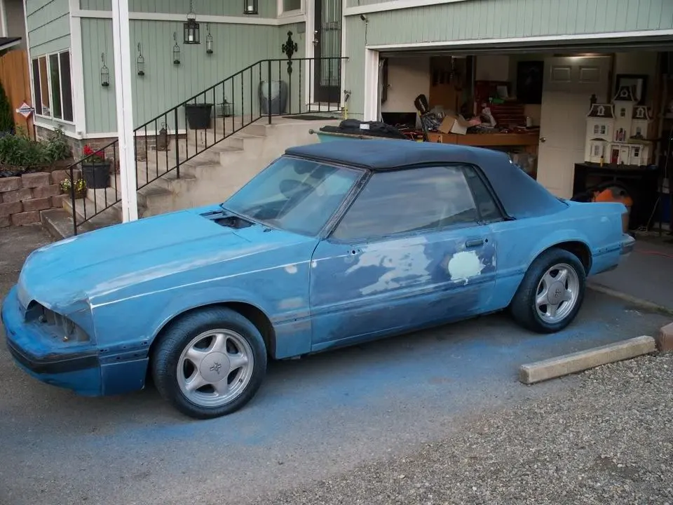

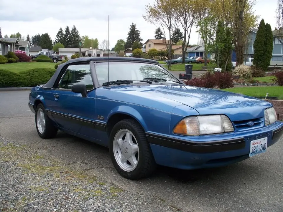

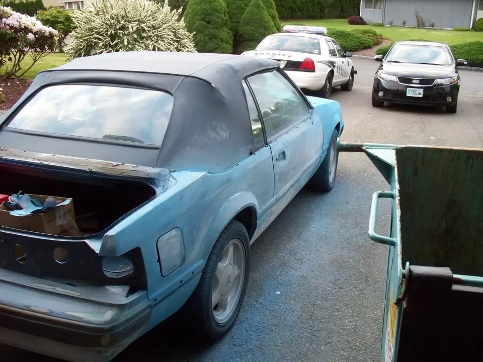

Repainting whole car I was driving it around last Saturday looked like this
Sunday I tore it down and My daughter came out to help:D

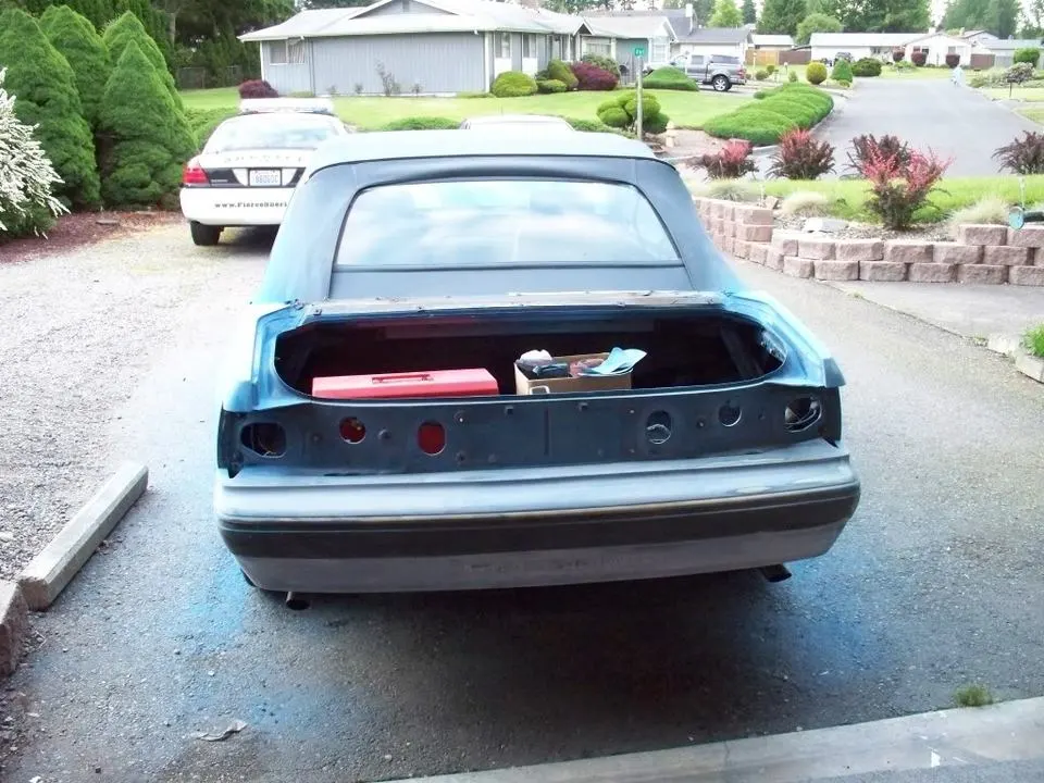

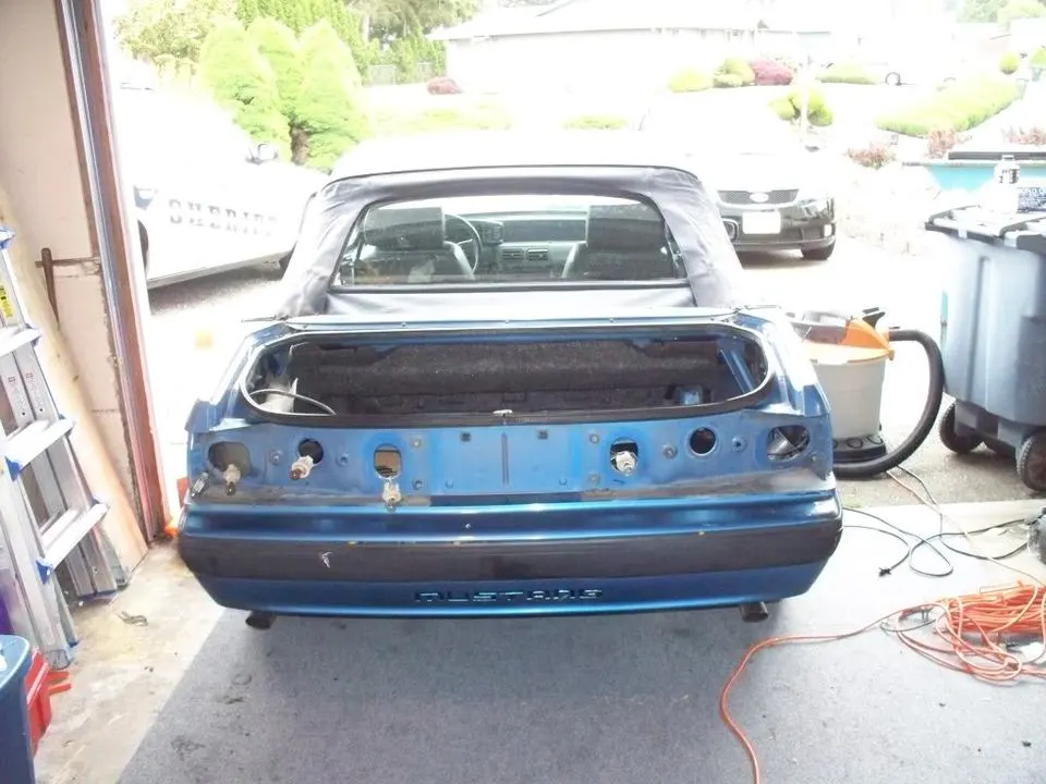

Will Do!!! Quick update on slow progress:( Finally got the mirrors and rest of the moldings off the car. The corner moldings for the convertible top were a pain in the arse and both of them broke. Now I get to shell out $129.99 each to replace:mad: Oh Joy! Back to work tomorrow so wont get to play with it to much this week. Have it ready to sand and strip down after it gets a good bath with Dawn. :nice:

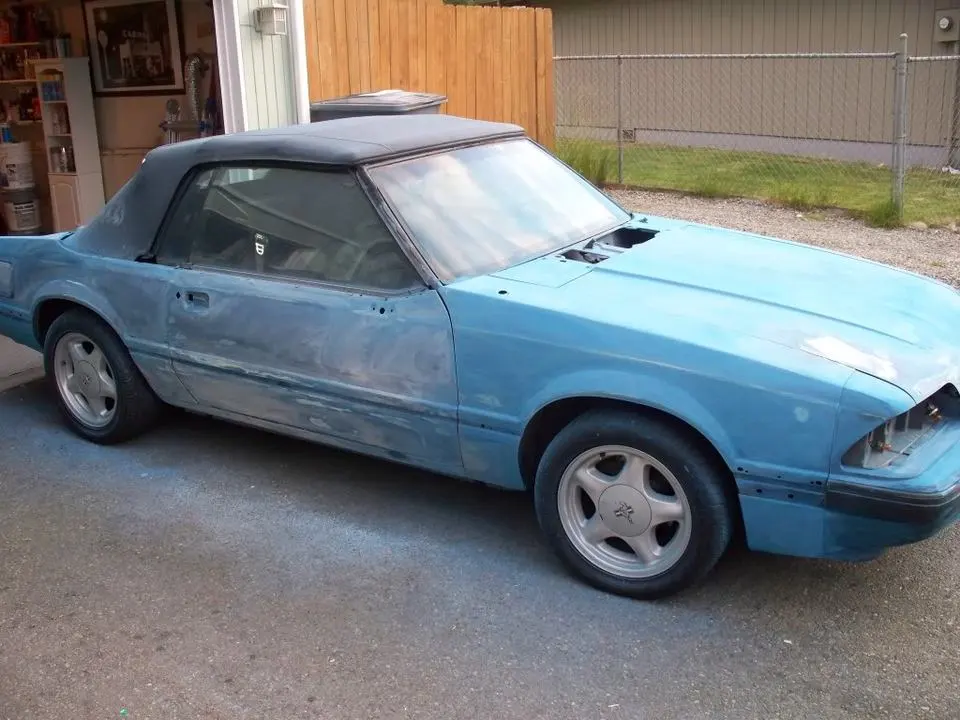

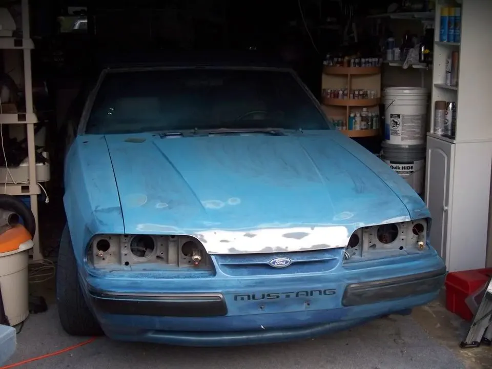

Here she is in her present state
Well after working 10 straight I get to finally work on the car again made a trip to the auto body supply store today and walked out with 4 rolls of sandpaper and some wax and grease remover and my wallet $192.00 lighter:mad: Oh well the things we do for our cars. I will get to sanding today as I finally have the paper I have been needing!
