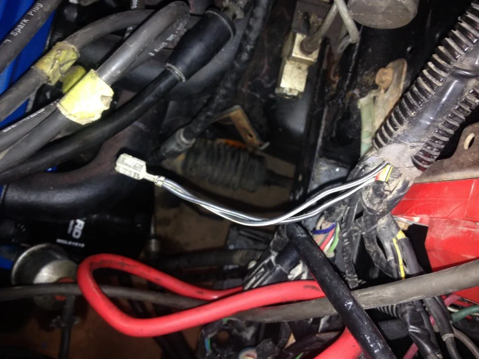

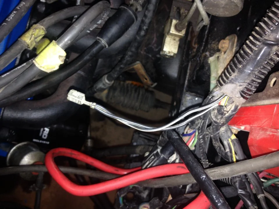

I need some help, I have a 1989 that I bought as a roller that already had the wiring, I put my 93 motor in it and it's all wired up correctly I think, , I'm getting 12 volts to the coil but still no fire I know the coil is good and the distrubutor, also it will not turn over with key switch but ignition switch and key switch is all good
I have power from battery to ignition switch but not from ignition switch to starter relay when trying to crank
When jumping starter relay I have no spark off the coil, checked all fuse able links and all are good have my c3w computer out of my 93
Have pictures of the coil wiring not sure if it's al right
Also has a wire that looks like a ground coming out of the harness
