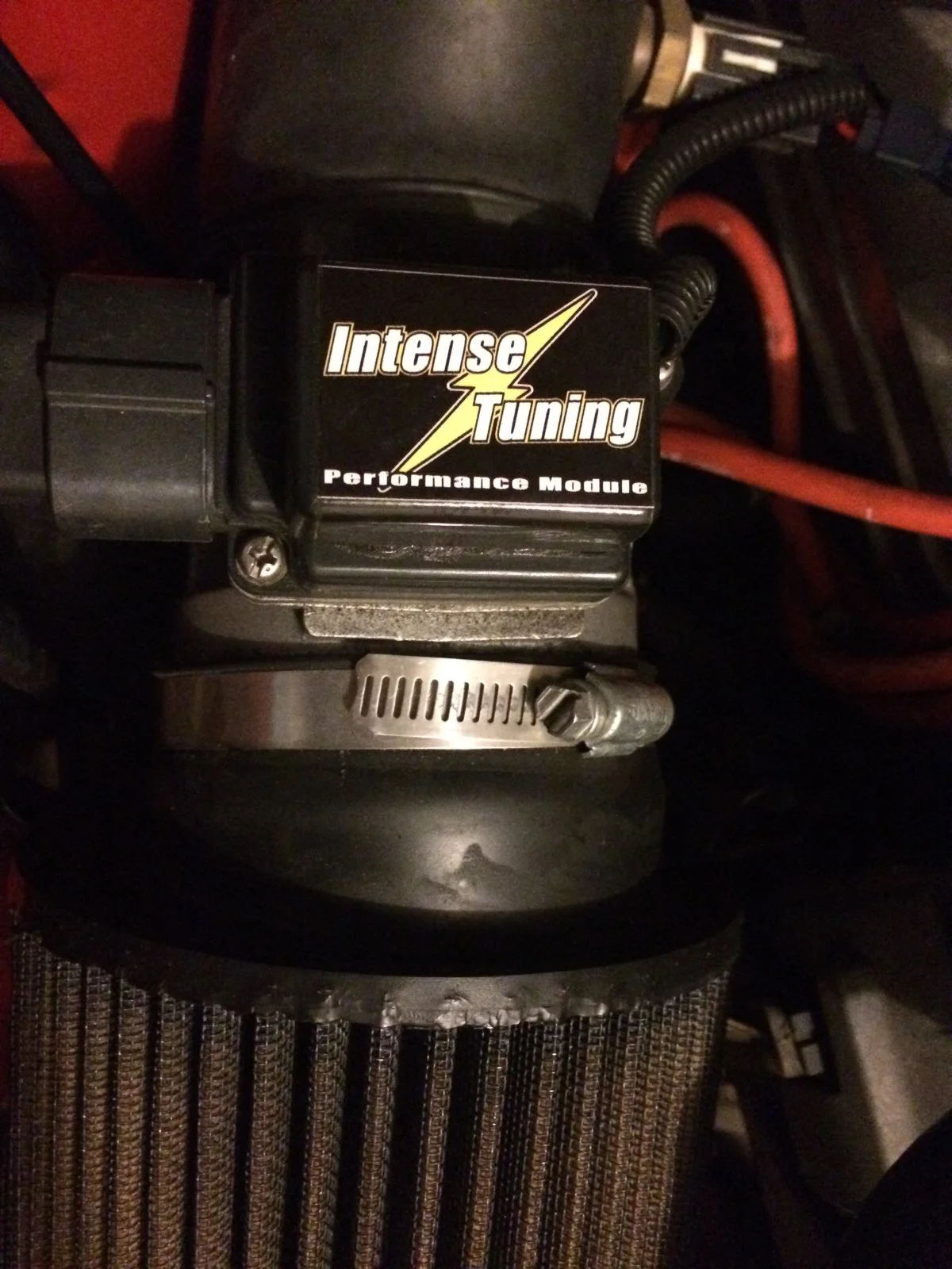

Supposedly (as told to me by the guy I bought it from) it has a 303 cam and Explorer upper/lower intake and this "Intense Tuning" module. (please see attached pic)
All my years of fooling with cars told me it was a plug wire going bad. So, I put new plugs, wires, distributor cap and rotor. The miss is still there!

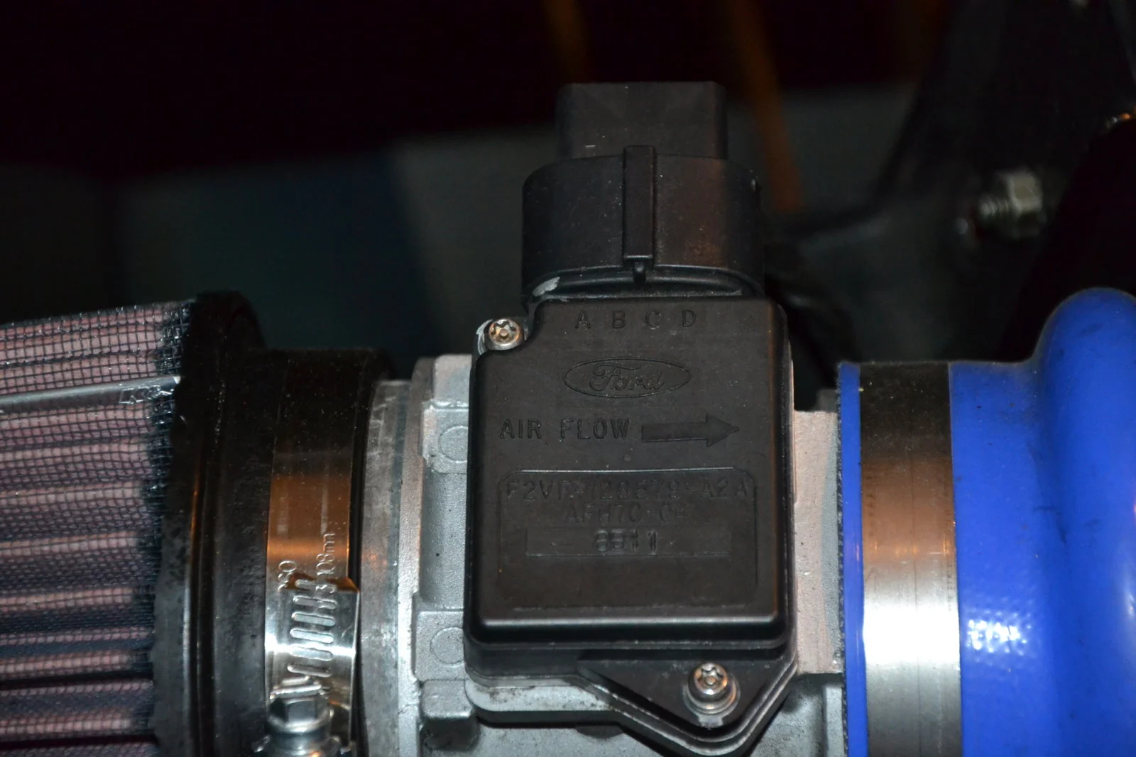

I had a problem like you mention.I took the MAF sensor off (cleaned it with the "proper" spray cleaner). IT looked "clean" (before I cleaned it) ,but I figured W.T.H and did it anyhow. after it was cleaned, I noticed a Hugh difference in how clean it was...........Reinstalled MAF sensor 1/2 hr later after it was completely dry
..........and problem solved.!:) Purrs like a kitted :)

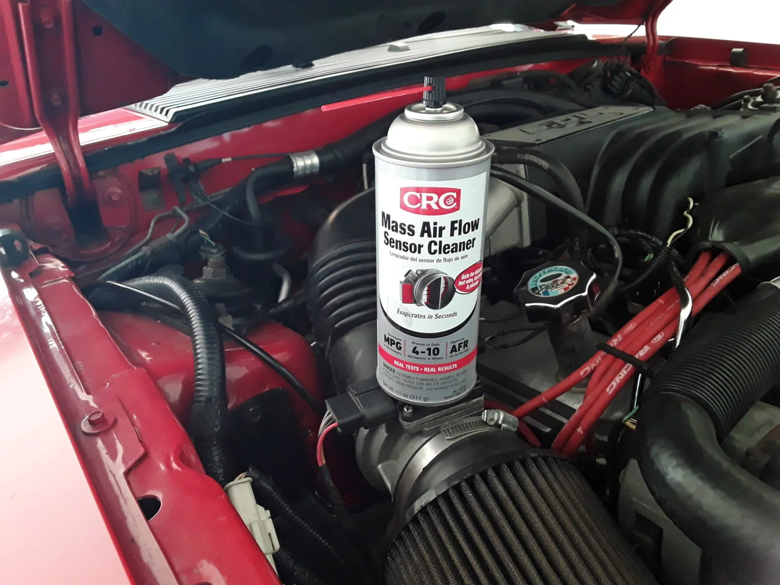

So...I removed the MAF and sprayed it good. Replaced it after I was sure it dried good. Drove it 60+ miles this morning and (knock on wood) it hasn't acted up!
Thanks for the tip. If anything changes, I'll be sure to post because I'll be looking for help!

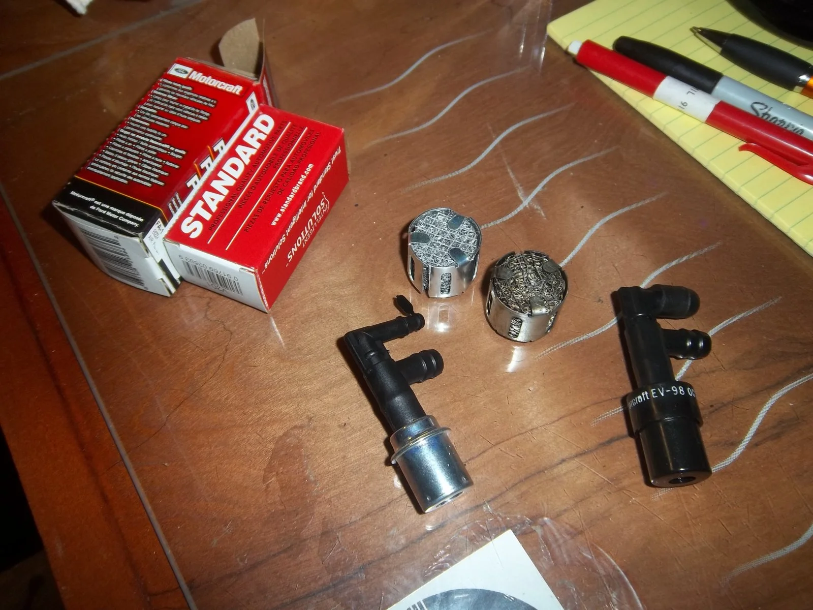

Also sometime take a look at the PVC Valve and filter/screen that's just under the PVC
valve.Here's pix. of the old and new one(old on the right,new one on left) .
See how dirty the old screen is.........

Thanks for the update. I was being "cheap" and figured I could pick up another 10hp for $20. I guess I got what I paid for!
If you look at my updated pic in the thread (that shows the can of CRC MAF Cleaner sitting atop the MAF housing) you'll notice that the "Intense Tuning" module is gone. I removed it as part of trying to get me engine running correctly again.
