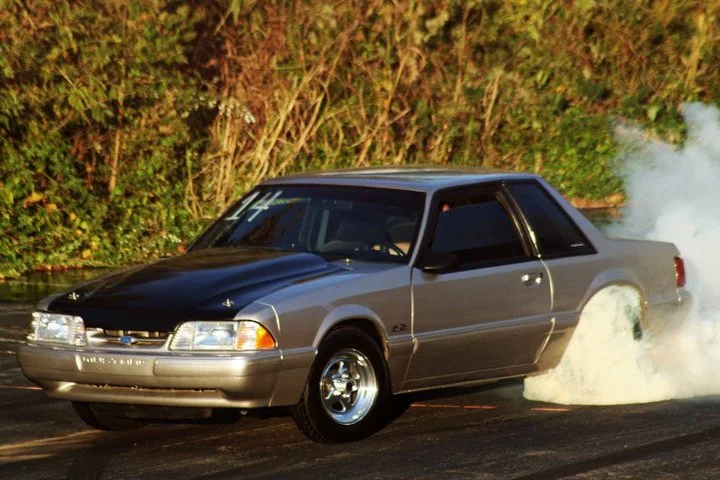

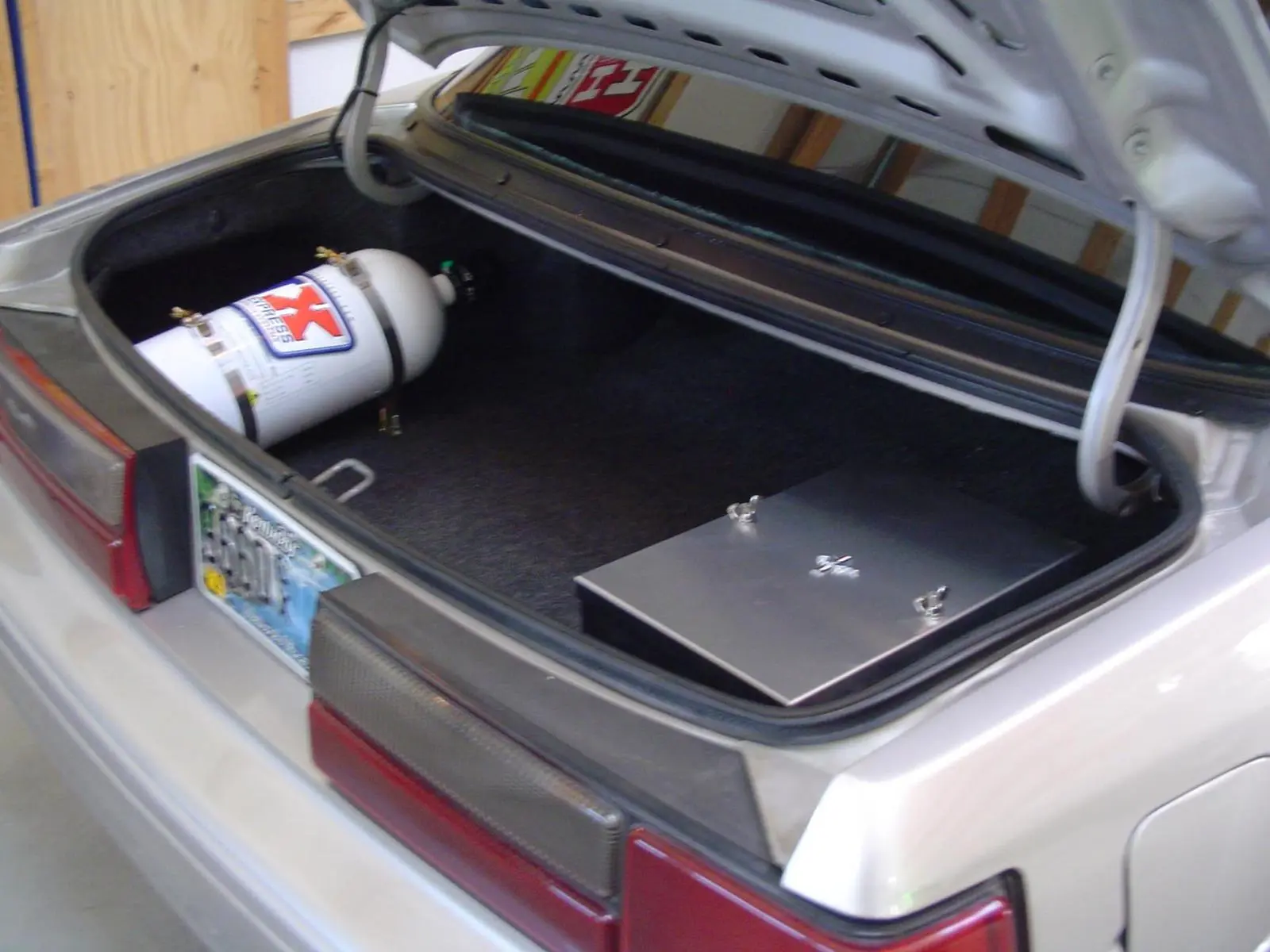

Hey guys i have a 1990 Coupe Mustang. I have been work my butt off on it here latley gettin ready for spring (all winter). Anyway, I installed a DSS 331 Pro bullet, AFR 185 heads, Comp Cam xtreme engery 282hr cam, Bassani headers, 30lbs injector, Holley systemax intake, aeromotive fuel rails, lines and reg, Nitrous Express plate system (150shot). 255 pump
Trans is a PATC AODominater (wide ratio) custom built 9.5 inch converter 3000stall,
3.73 gears
6 point cage
MT ET Streets 275/60-15s
K member, coil overs on all fours
tubular contol arms
adjustiable rears
fiberglass hood, trunk, fenders and VNG nose piece
full interior
manual steering
smog pump delete
battery mounted in truck
I could go on but, I was wondering what you all would think its goin to run this spring. It will be ready late March first April

There are so many variables its hard to say what it will actually run, could go anywhere from a high nine second pass to a high 10/low 11
Usually, a Nitrous fogger system will seriously increase the fuel pressure which will help the 30 lb injectors. However, I'm not a nitrous pro, so hopefully someone else can chime in about that.

Unless its a dry kit, the 60's would be overkill. I think the 30's with a wet kit might will be fine if it runs good with the 30s on motor. The nitrous kit should have its own source of regulated fuel
