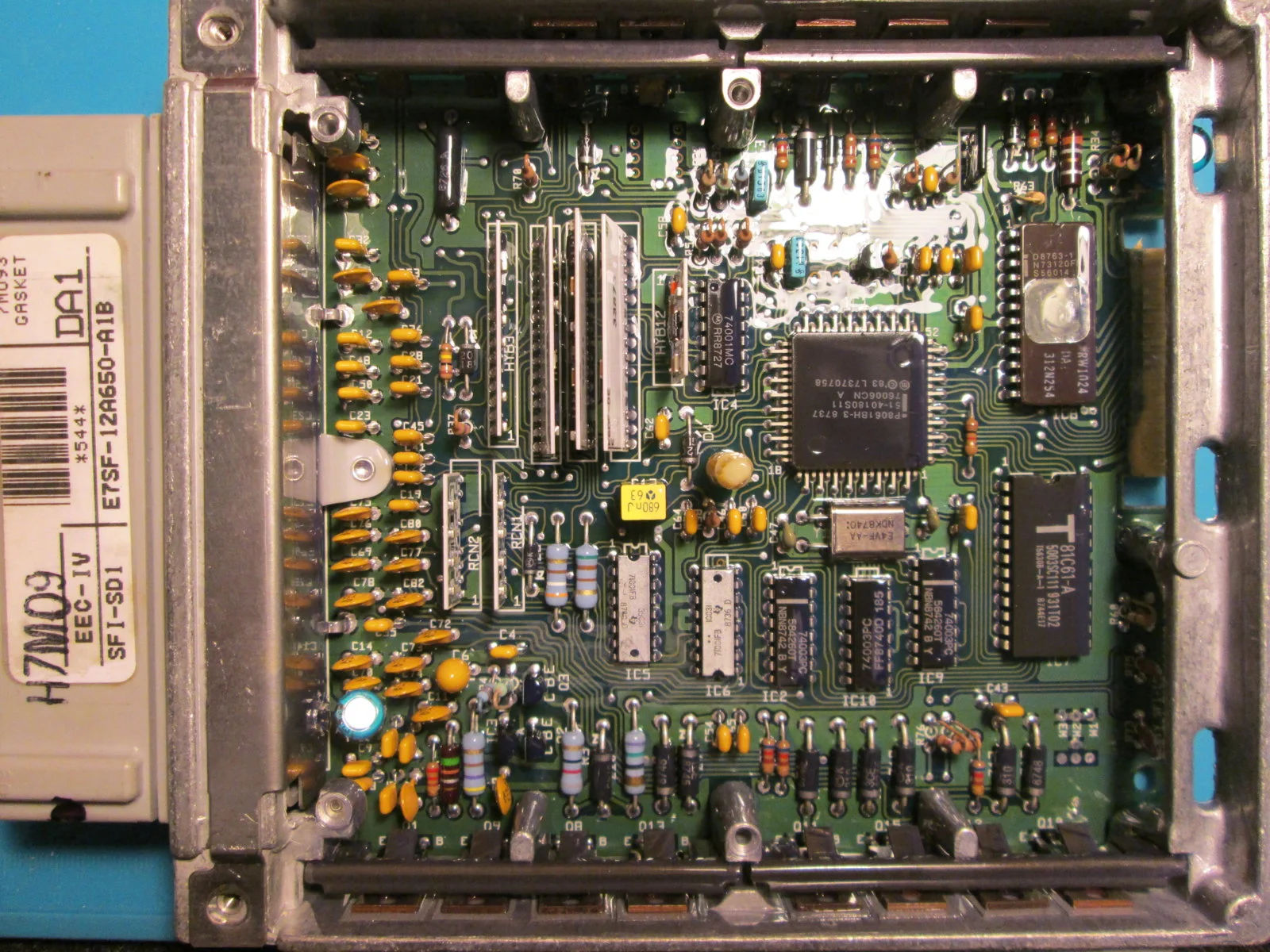

I got the not running codes I will check the running codes ...last night I unhooked the battery and plugged the o2 harness back in and all is fine which is vary odd

That is really great! You actually opened the case of the ECU and found the problem? WOWIE ZOWIE!!! I had an old ASUS motherboard that needed the electrolytics replaced. A new installation of Windows would last a month or so until it was so corrupted by bad writes to the hard drive it would stop functioning.

Yes sir I’ve never been so happy to discover a issue lol

update changed caps out fixed the surging idle but not the popping and and miss fire in closed loop ...moving on to fuel pump planned on changing it anyway for the nitrous ‍♂..any input is appreciated
