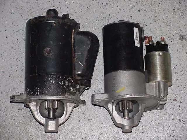

yes it does, usually the nut holding the metal strap from the solenoid to the starter comes loose or the strap corrodes so check that first. on the pic on the right its the smaller cylinder with the copper strap going to the starter.
Hey Thanks! that picture helped me out alot and now I can see the diff in starters. I def have the smaller one on the right.
