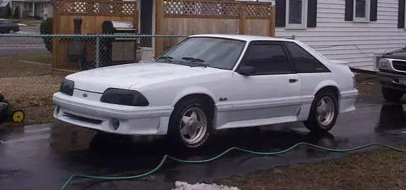

Here she is. I put 17" Cobra Rims on it this year, right before I had to put it away for the winter...Those made a huge difference.

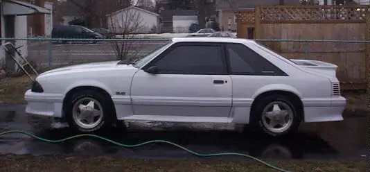

Another Picture of her

if you are asking if the stock block can handle 300 horsies, yep. there are folks running blowers on stock shortblocks at the track with 200K+ miles.
nice lookin ride too.

Instead of the parts you chose, have you looked into the Trick Flow engine package? It is a set of Twisted Wedge heads, a Stage 1 cam, and their Street Heat intake. I have seen it for $1600. Much more likely to hit 300 with it than the package you mentioned. You may also want to look into upgrading your exhaust to 2 1/2 inches and long tubes if it's in your budget. Honestly, with the AOD, you will probably be shy of 300, but you'll be closer. Nice looking ride BTW.
