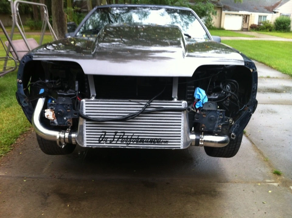

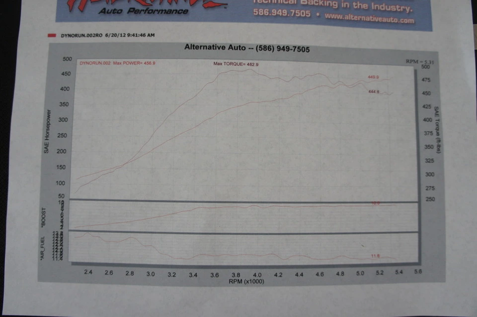

Well i bought this mustang 4 weeks ago in non running condition the person i bought from tried to moates tune and didnt have all the stuff on right but i lined it all up sold the moates and got it professionaly tuned. has windsor sr 200cc heads, eld intake, fcam, 42# injectors, 75mm mass, 70mm tb, 255 pump, no ac, no smog, elec water pump, 3"aluminum radiator, f1 stage 2 clutch, and on3turbo kit 10#'s boost..

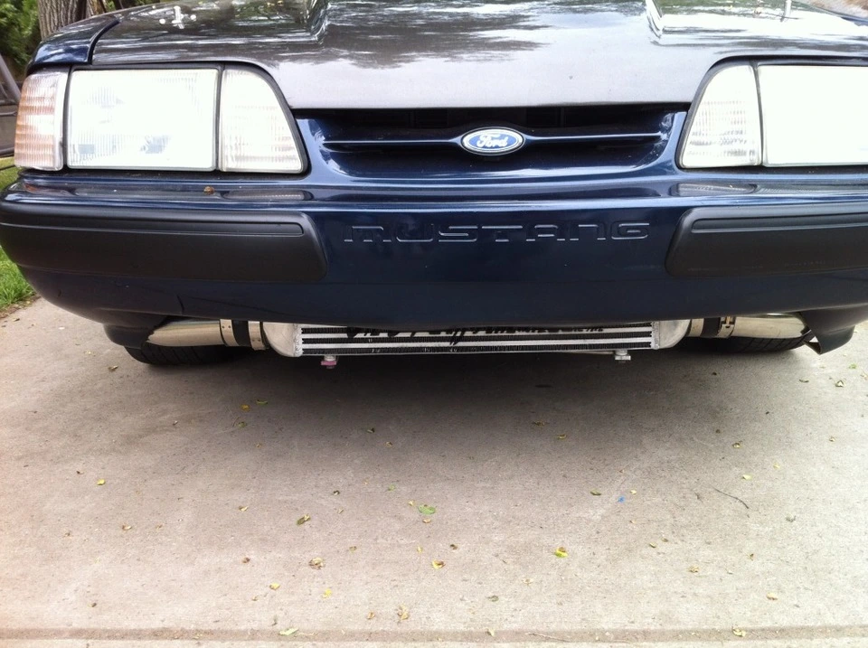

I have always wondered about this,...How is an air-to-air I/C doing any good 2/3rds covered by the bumper cover? I see in the pics that even then there were mods to the lower portion of the cover to even get the 1/3rd that's on the bottom exposed.:scratch:

aluminum still helps pull heat out of it.
