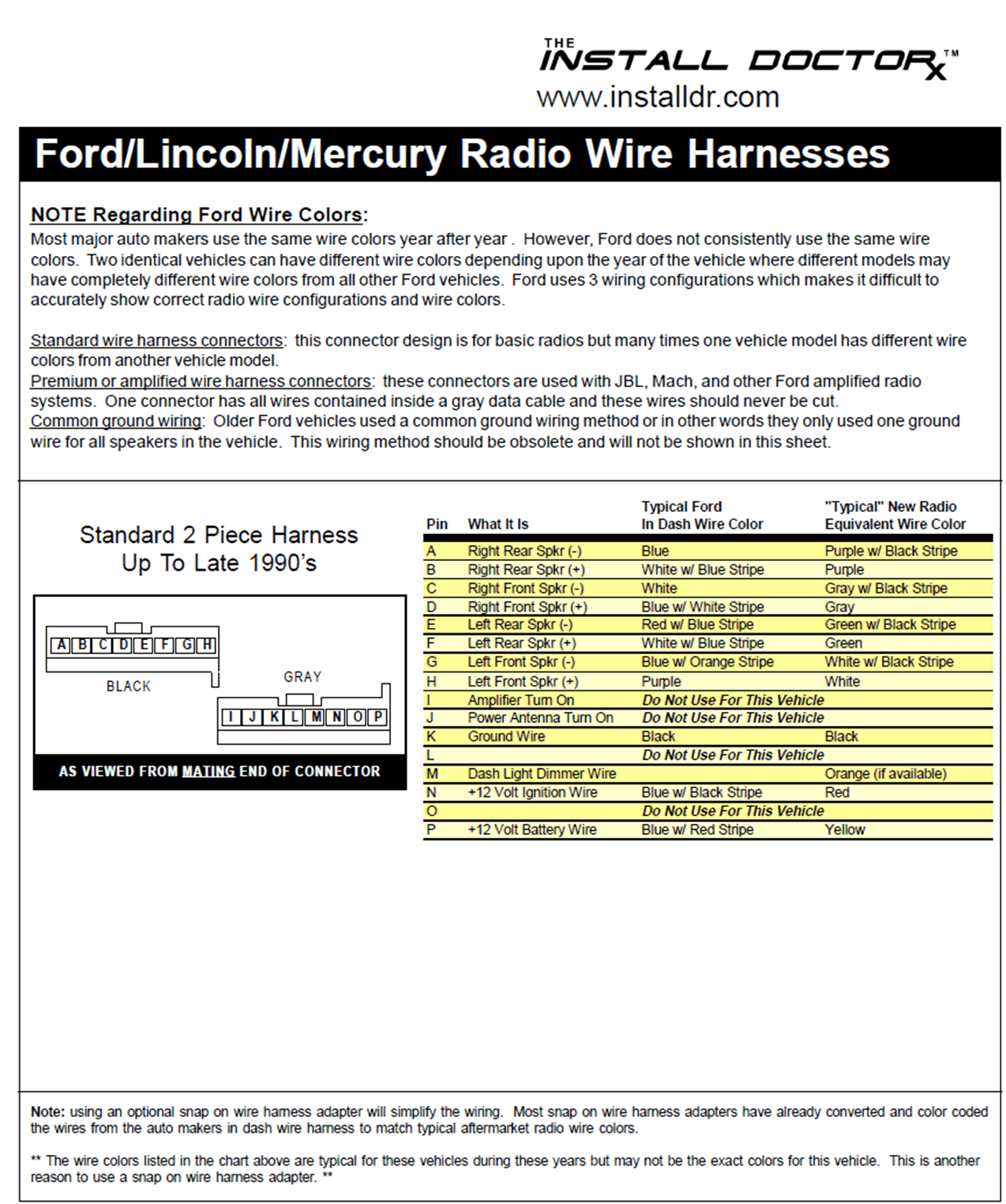

In some recent wiring work I had done on one of my Foxbody cars I seem to remember looking at one of the wiring diagrams and or fuse diagrams. I seem to remember seeing a dedicated circuit for radio display. Maybe there’s a specific circuit for radio display and memory. Maybe it’s not receiving power on your car.
Ford radio harness wiring
