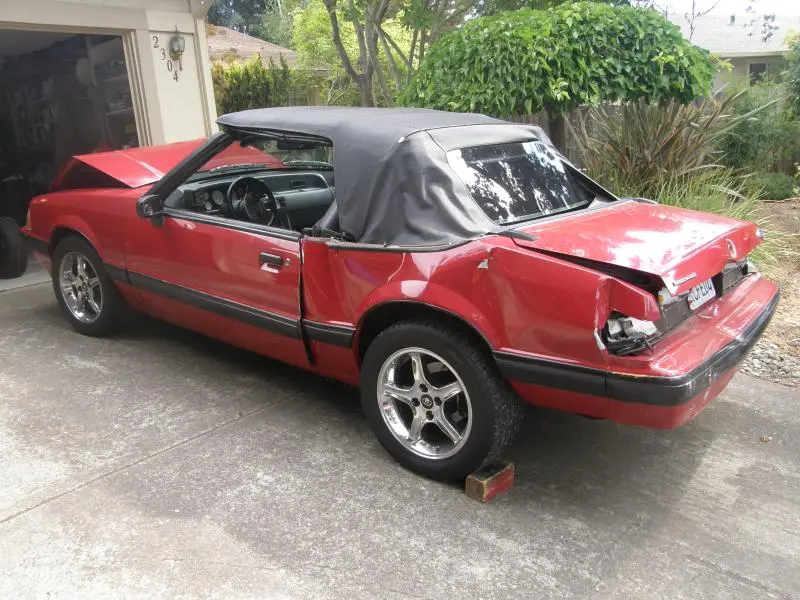

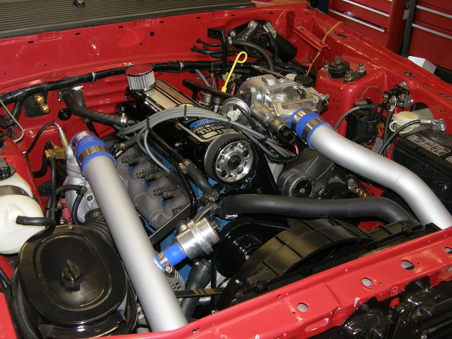

Here's a step-by-step wiring conversion for an '88 LA2/3 into a '90 Mustang.
I did the conversion when I built Thunderstang.
Unfortunately, about 5 years later some clown rearended me and totalled the car.........

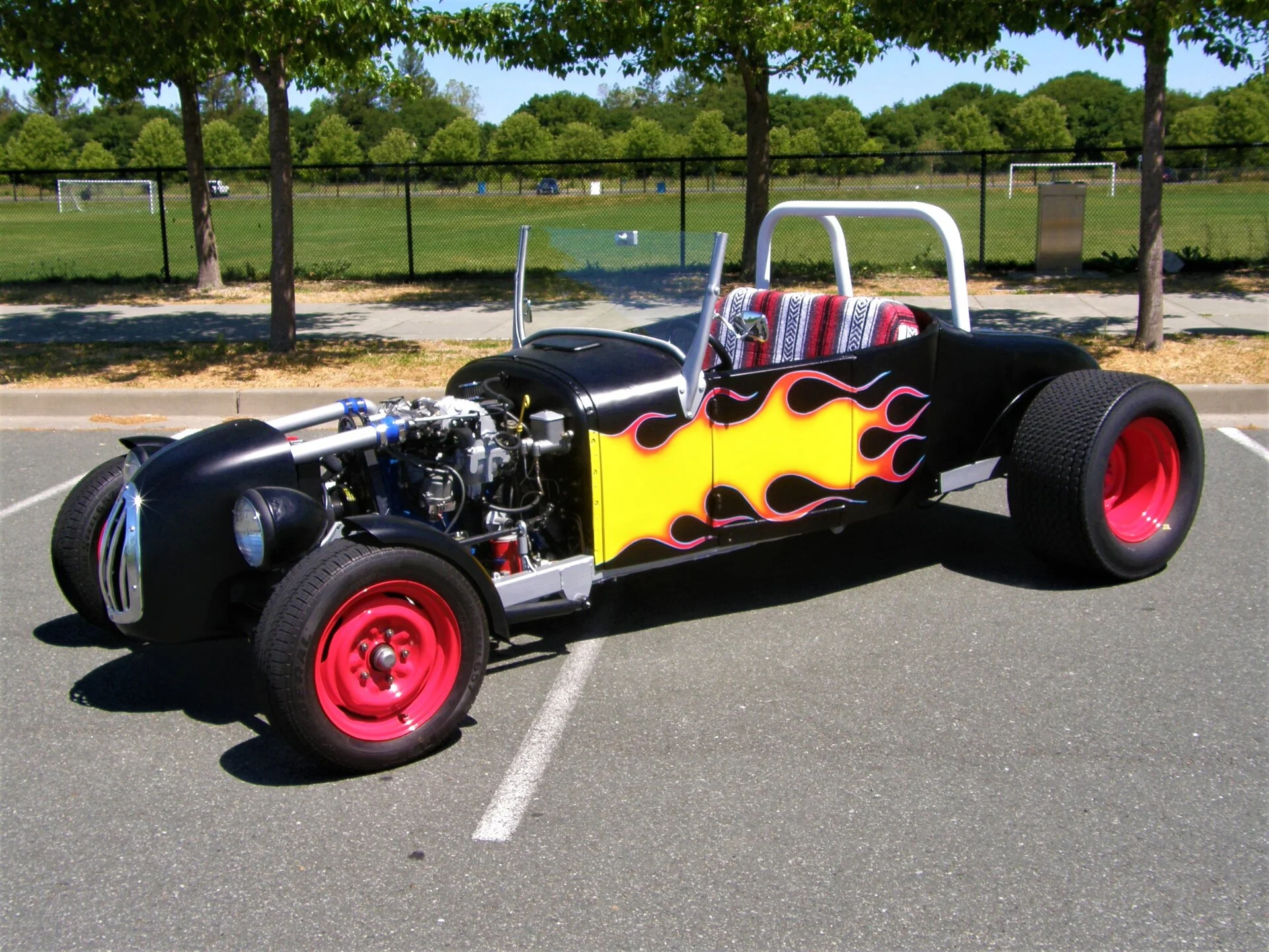

However, I was able to pull the motor/trans and dropped it into my '27 roadster so.........Thunderstang lives on!
