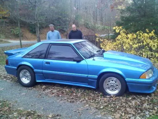

thanks for the help guys, here is a pic of my rusted out junk
