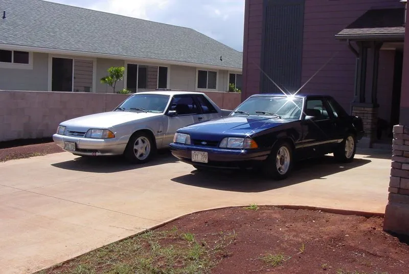

This is mine and my friends SSP's....exactly how they were delivered to Windward Ford from the factory except for the pony rims.. His was Silver, mine is Royal Blue. Both SSP cars.
Chris

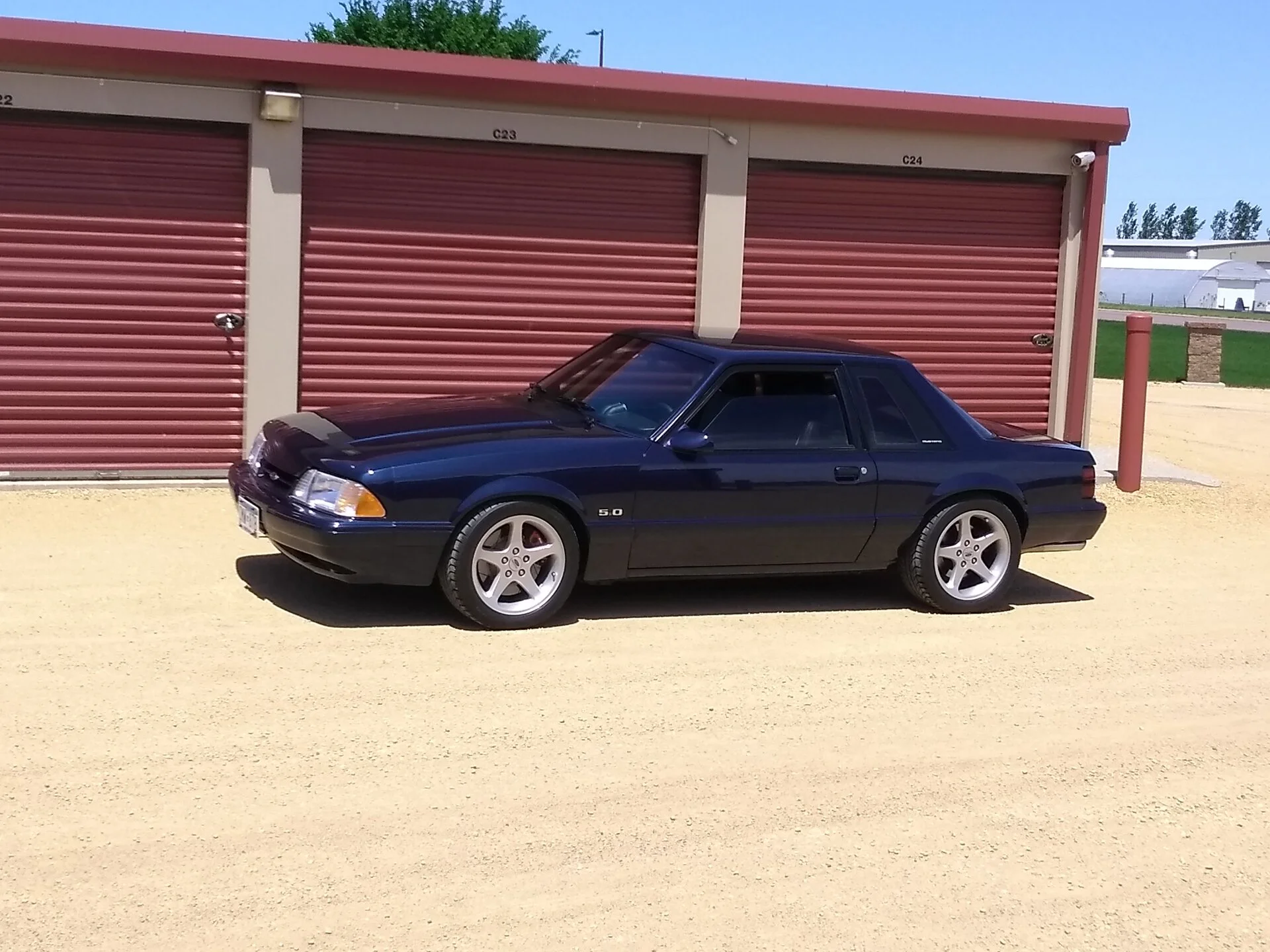

It's been repainted all black at one point in time I believe. Then true blue.
