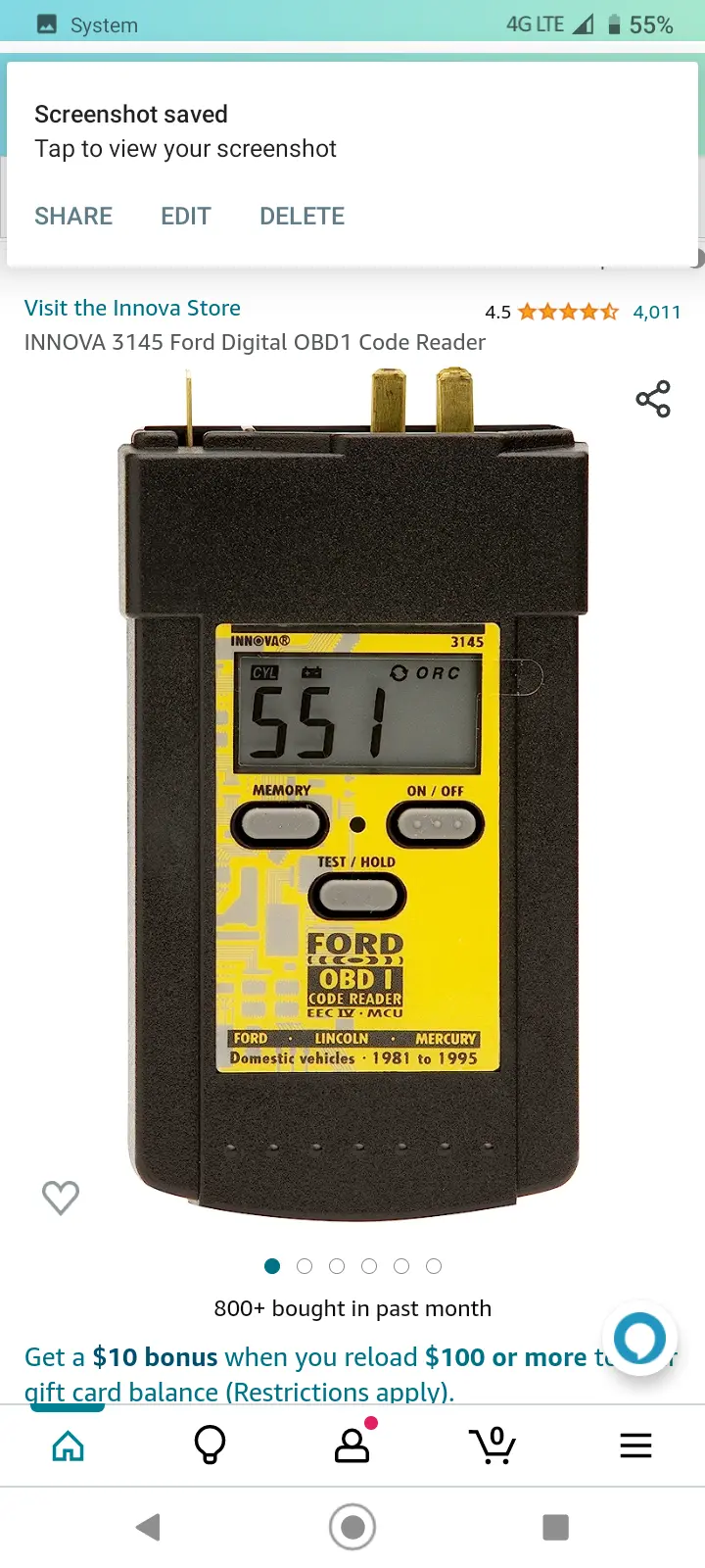

Will this device give me an Air Bag Code ?

You don’t scan rye codes so you can only count the air bag light flashes. Typically it’s the air bag module that fails and more specifically it’s the capacitors in them aging out.
Right, so once I count the flashes how does that correlate to the 2 digit code?
